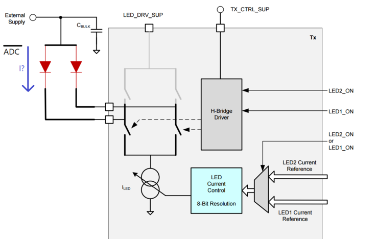

Hi, I want to LED1, LED2 on/off timming .

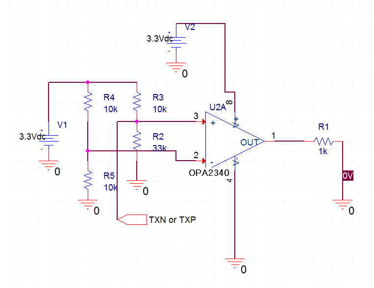

My LED operate 7.6v and 5.6v, so I make external LED control circuit.

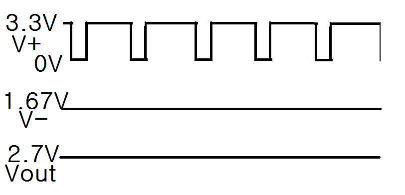

But, how can I read LED1, LED2 on/off timming ?
I make OP-Amp comparator, but fail.
  • Hi Sangkyu,
    To understand you application, could you please answer following question.
    1) What is connected to LED_DRV_SUP?
    2) Do both the LEDs have common anode? If yes, are you planning to build a LED driver circuit to switch common anode node between 7.6 V and 5.6V?
    3) Can you please elaborate, how do you connect your Op-amp circuit with AFE4400?
