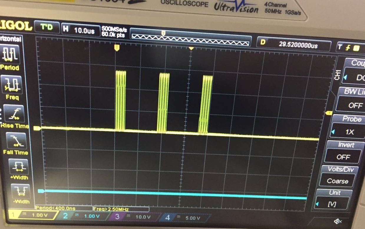

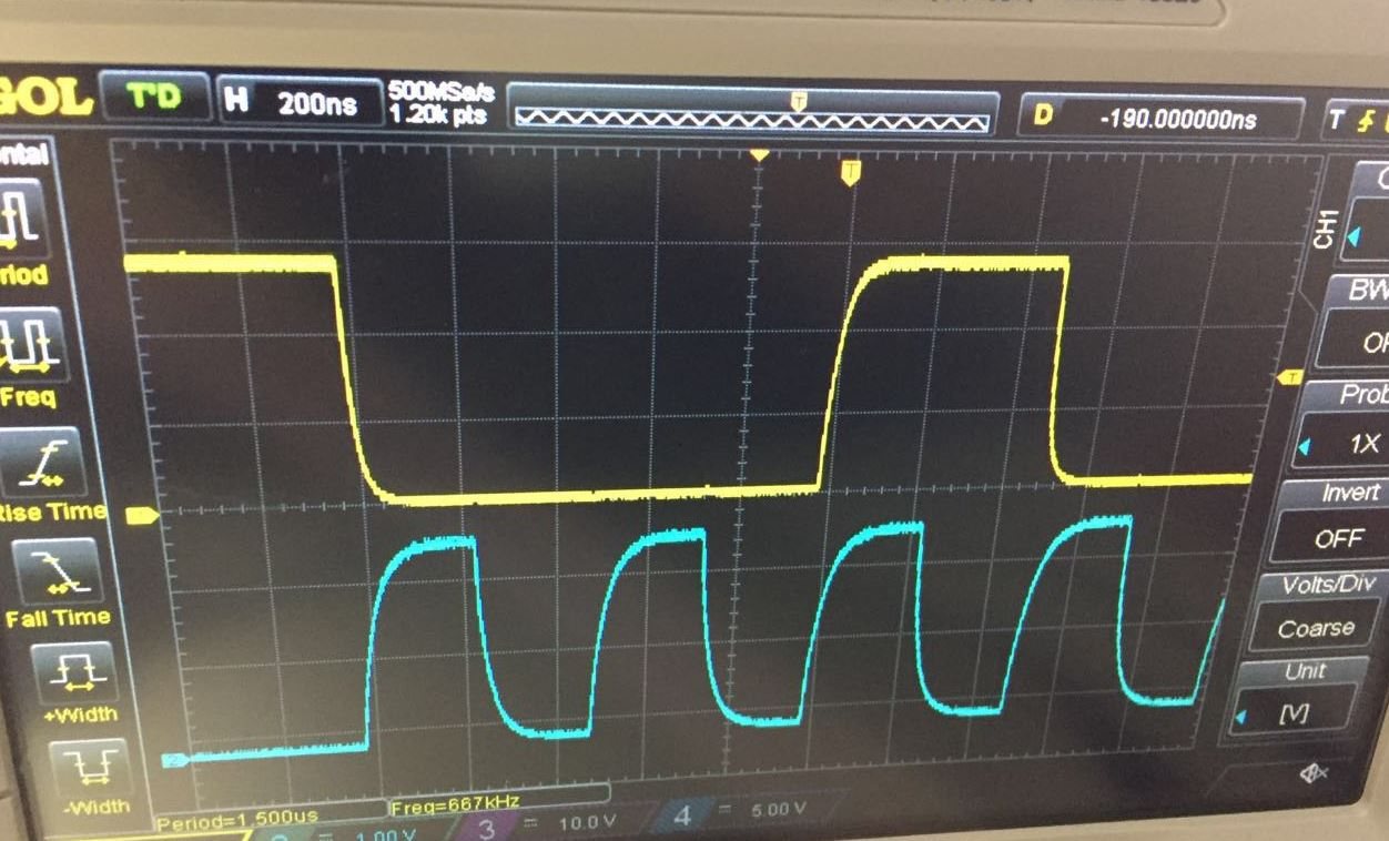

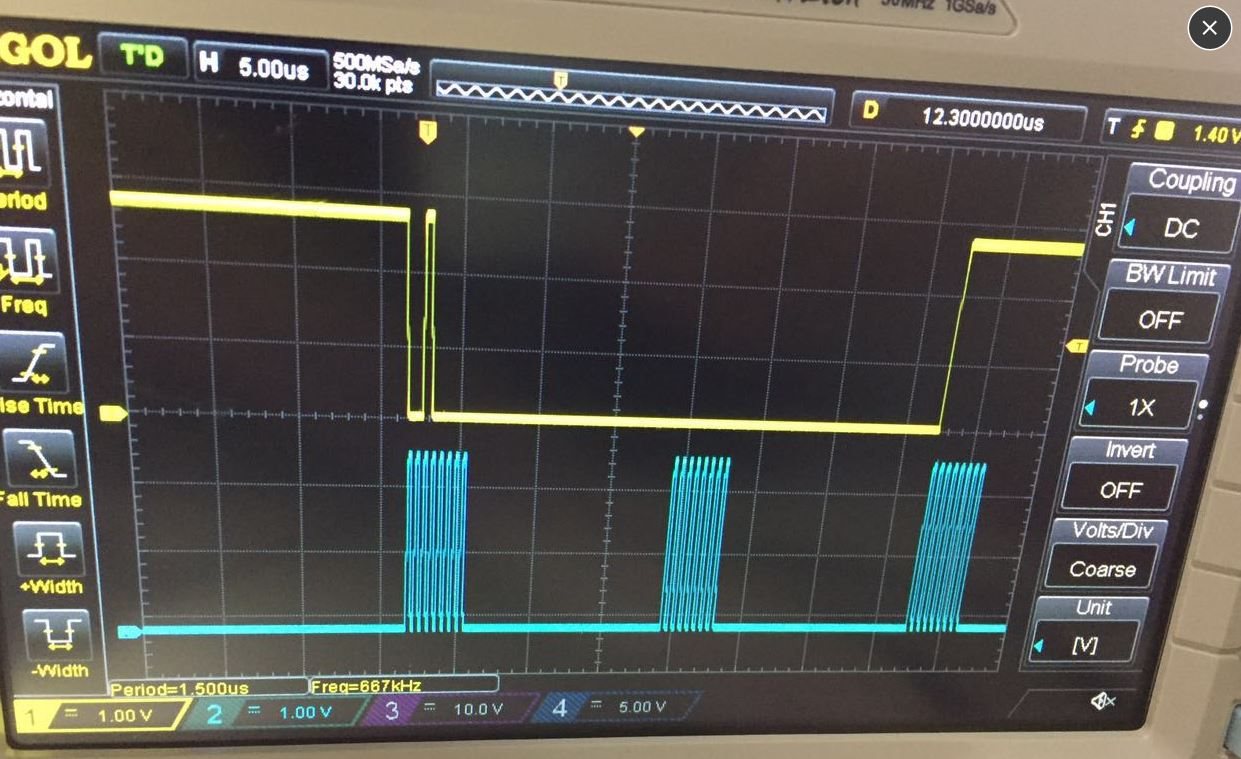

  • Shiping,
    Can you post the images of the signals here? The vast majority of communication issues come down to an error in the SPI sequencing that can easily be identified in the image. Indeed it is easier than evaluating code since code issues could involve a large number of different things.
    Brian
  • Brian
    Sure,
    when I send read register command (0010 0000, 0000 0000, 0xFF) to read ID register. I still can't detect any data back on DOUT.
    Yellow is for DIN, blue is for SCLK.
    same capture
    the picture below is for DOUT and SCLK, DOUT has nothing.
    Is my DIN timing correct? What could be the reason?
    Thanks a lot.
  • Thanks Brian,
    Finally it works, actually it's because i forgot to mute another GPIO interrupt in my code, it always go to that ISR. after i mute it, i could capture the right signal on SPI.
