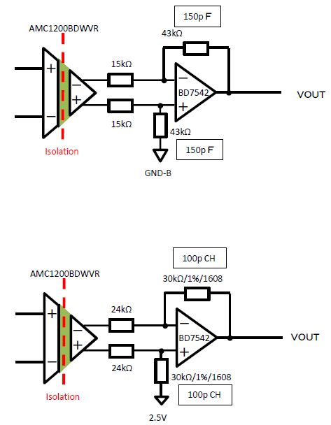

I have a question about AMC1200.
I want to amplify the receiving circuit of the output of AMC1200 differentially.
DC Gain : 43/15
Power   : Single 5V
Full swing
Are there recommended conditions about the receiving circuit?
For example,
Don't receive with very high impedance.
Concerning the band of the output noise, the frequency that should be performed a cut-off.
