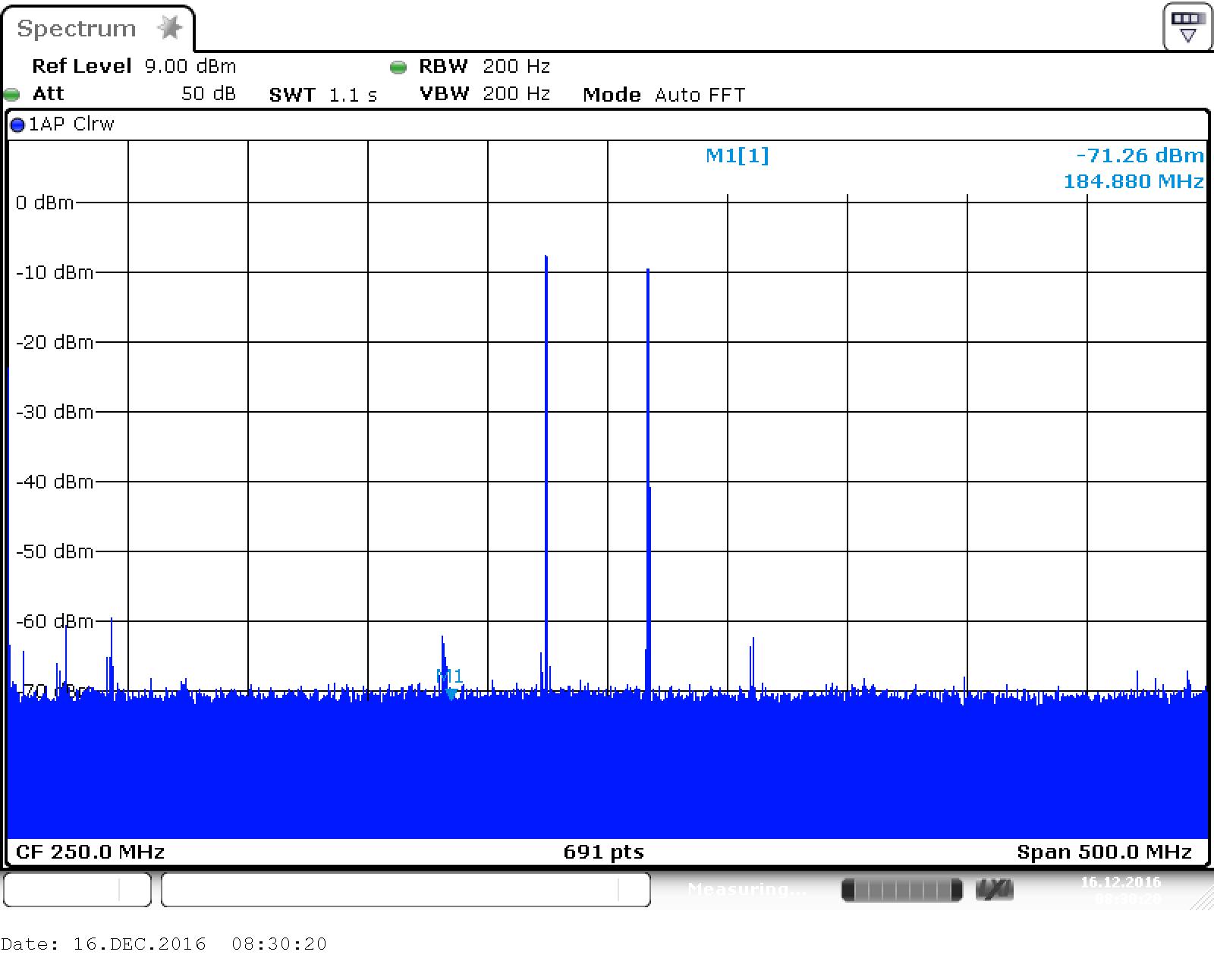

Need your help regarding DAC3484 Quad-Channel, 16-Bit, 1.25 GSPS Digital-to-Analog Converter,
We are planning to work with the chip as 4 separate ADC at IF 184.32MHz (144.32~224.32MHz), using  the complex signal mixer in fs/2 the Fdac we intended to use is 491.52MHz.
Unfortunately the datasets parameters starts at Fdac 600Mhz, can you please send us any relevant information (such as SFDR, IMD3, NSD and Second Harmonic Distortion @ Fdac=491.52MHz).
