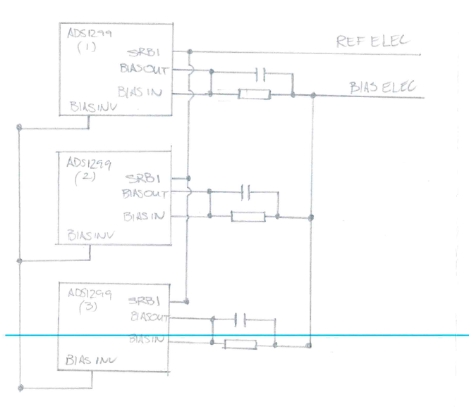

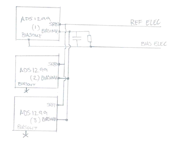

Currently we are developing an 32 channel EEG acquisition system using 4 ADS1299.
We have an issue on how the BIAS and REF electrode need to be connected. We will not be using the ADS1299 daisy- chain  feature, but we will be using a common SPI line between the ADS1299 and 4 seperate CS lines.
Below i have two options for the BIAS and REF setup. We have researched various sources and it seems there are multiple ways how the BIAS electrode is connected when using multiple ADS1299.
Can anyone suggest if the setups below are correct and if so which is the best setup to use?
Thanks!
SETUP 1
SETUP 2

    The bottom diagram is correct. If you look at Figure 37 in the ADS1299 datasheet, you can see that the BIASINV pin has the "average" of all the PGA outputs on it. You can "average" PGA outputs from different devices by simply wiring over the BIASINV pin from another device. However, you still only want to use one amp to drive the signal.
    Brian
