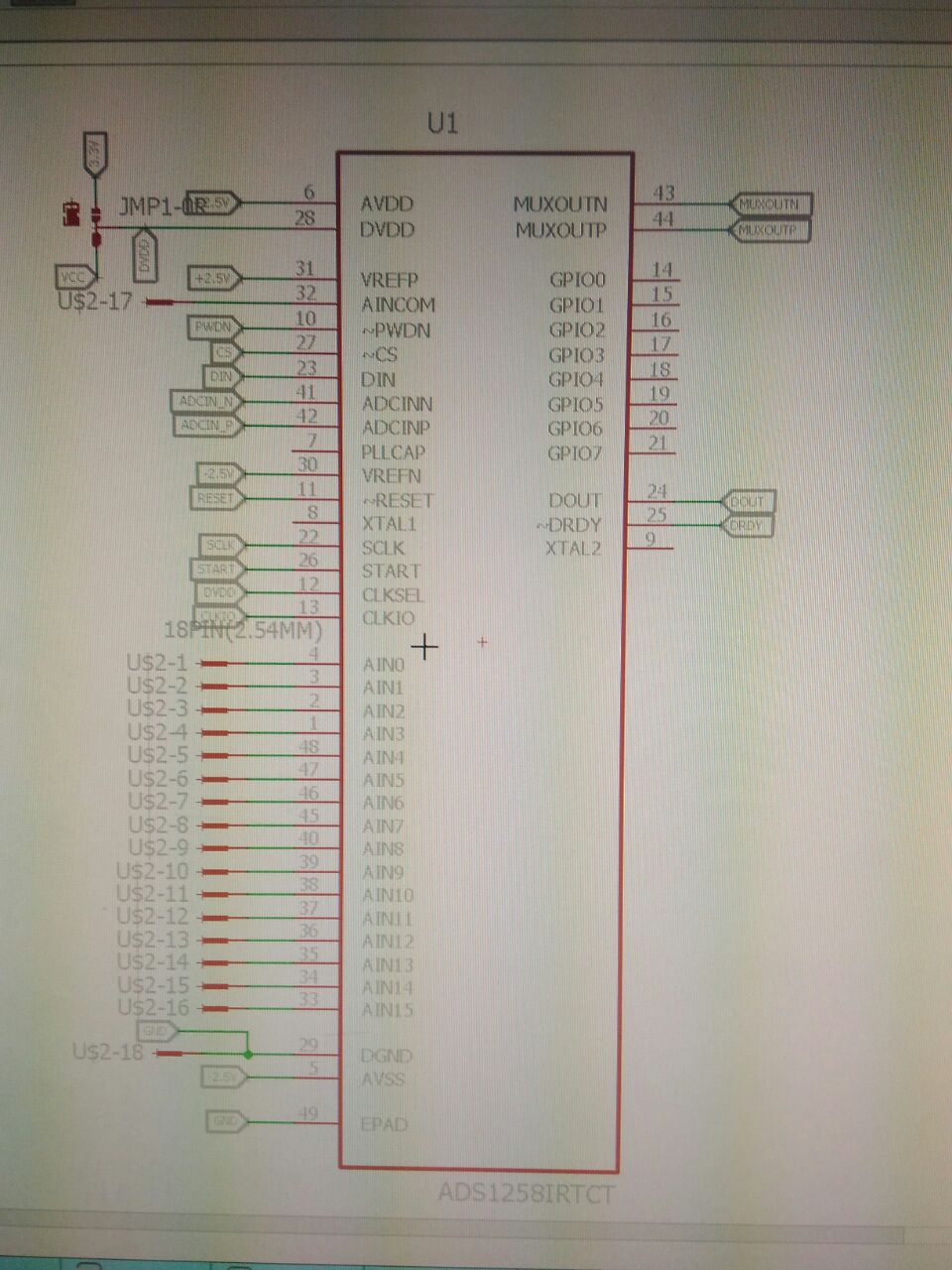

  • Hi Tejas sj,
    Sorry to hear that you are having trouble with the ADS1258. Can you send along a screen shot of the schematic showing the connections to the ADS1258?
  • Hi Tom,
    The schematic is very simple, I have designed a breakout board for ADS1258 for evaluation. The pin connections are as follows:
    CLKSEL pin is shorted to DVDD pin.
    DGNG and Exposed Pad are shorted and used as Ground.
    The pins CS,SCLk,DIN,DOUT,DRDy,START,RESET,PWDN,CLKIO are connected to FPGA.
    Thank You,
    Tejas SJ
  • Hi Tejas,
    Are your analog and digital grounds referenced to the same potential? If not, then the device may not function properly. Otherwise all your other connections and configurations look okay.
    Also after power up, make sure that the clock is running and that the START, /PWDN, and /RESET pins are all set high so that the ADC begins converting. Have you checked on these signals?
    Chris

  • Hi Tejas,
    In this case since you're using a bipolar supply, you don't have a dedicated analog ground pin on the ADS1258. However, you'll need to make sure that your analog supplies (that provide AVDD and AVSS) are referenced to the same ground potential as the digital ground.
    Typically, we recommend to dedicating a PCB layer as the ground plane and sharing this ground for both analog and digital grounds. From there you can "partition" the ground plane into analog and digital sections without have to split the ground into separate planes. Designing a PCB in this way can be just as effective at isolating analog and digital return currents (i.e. noise) as using separate ground planes, and also avoids many of the issues associated with split ground planes.
    Chris

  • Hi Tejas,
    The first sign of life to look for is /DRDY going low. If you've properly powered the device, applied the clock, and set the GPIO pins appropriately, then /DRDY should become active. You'll first notice it go low, and then it will begin to pulse at intervals of the ADC data rate (as shown in figure 56 of the datasheet).
    Since you're not using an external crystal on the XTAL1/XTAL2 pins, then you'll need to set CLKSEL high and apply a 16 MHz clock to the CLKIO pin (as shown in figure 40).
    At the moment it would sound like either the external clock or the GPIO pins (START, nPWDN, nRESET) are not configured correctly. I think once you get those set, you'll see the device come to life.
