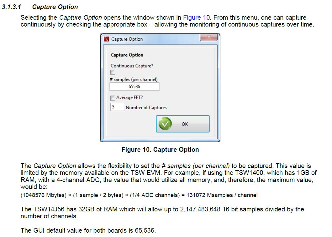

I know that High-Speed Data Converter Pro GUI used to capture and analyze the data using the TSW1400EVM allows to save the snippets of data into files. It also allows continuous data capture. However, I would like to know whether it is possible to continuously save the data into a file rather than just displaying the continuously updated data in the GUI?
I need to have access to a raw data acquired using an 1 channel 250MSPS 16bit ADC(ADS4149 EVM).
When using all 1 channel, 1 GB memory of TSW1400EVM would fill up basically within a second, whereas I need to be able to save at least few minutes worth of data.
If TSW1400EVM can't handle this task, I would appreciate if you could suggest any alternative options that could be used for the data acquisition from ADS4149EVM.
like above picture, I already tried to change the capture option in GUI(HSDC Pro.)
I know that the #samples value is limited by the memory available on the TSW EVM.
in this way,I can get up to 10.3 seconds of data. in this case, the data memory is just about 191MB, Much less than 1GB memory (capture option_#samples(per channel) is  49999872).
It means that I can still use more 900MB of memory. but i can get more than 10.3 seconds.
I need to get more than 1 minutes. thank you.

  • Hi Cho,
    For you to capture 16b samples at 250Msps and for 1 minute (60s) that means you need something capable of capturing 15 Gsamples.  None of our capture cards can capture this memory depth contiguously.
    The TSW1400 is limited to 512Msamples, it is 1GByte of memory which requires 2 bytes for 16bits, and then is only 512M samples max.  The TSW14J56 has 32Gbits (or 16GBytes)of memory which is about 2Gsamples of 16 bits.
    The firmware is also not setup to parse data continuosly out of the FPGA.  Currently the mode operation is to capture the data into DDR memory and then transfer it out via USB.  As such it can not capture more than the memory depth on the capture card.  If you capture another buffer it is not contiguous to the other captures.
    Ken

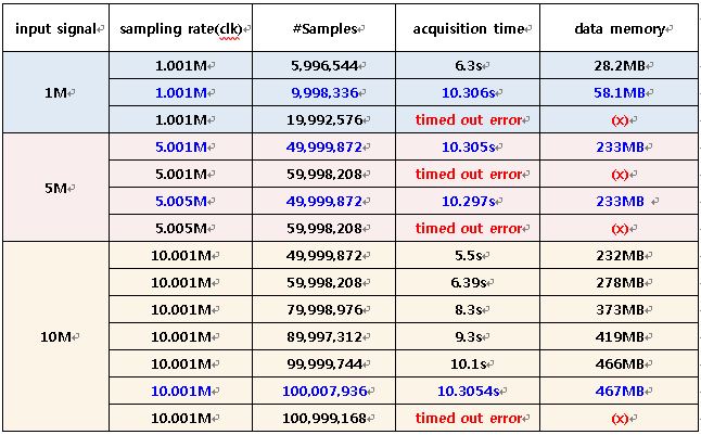

  • Hi, Ken
    As you know, I use 250Msps, 16bit ADC.
    But I am measuring the signal at 1Msps rather than 250Msps.
    In this case the saved data(in csv file) is just about 28.1MB.
    this measurement time is 10.3 seconds.
    so I think that I can get more data at least 1 minutes.
    if my thoughts are wrong, data value is limited by absolute time. right?
    thank you for your reply.

  • Hi Jim
    there is too many misunderstanding with you.
    I know that Data acquisition is related to memory size.
    I used my ADC Board(ads4149 evm). and sampling rate is 1.00Msps.
    I also know the minimun sampling rate is 20Msps.
    But I used my ADC Board to subsample.
    Clearly there is no problem in using my ADC Board.
    I Have a trouble in using FPGA and HSDC Pro.
    for instance
    1) sampling rate is 1.00Msps.
    in this case, I used 28MB to obtain 10seconds of data.
    2) sampling rate is 5.00Msps.
    in this case, I used 150MB to obtain 10seconds of data.
    that means I can get more data more than 10 seconds.
    because I just used memory under 512MB.
    But under any circumstances, It is impossible to obtain more than 10seconds of data even though there is enough memory space in FPGA memory.
    (I attached a table comparing the size of the memory and the measurement time of the data.)
    So I wonder if there is a limit to absolute time(about 10seconds) rather than memory size.
    I really want to obtain a data acquisition time. please help me.
    if I can do this by using TSW1400EVM, Can you suggest me another equipment?
    thank you.
    <Comparing table>
    file format is  .csv

  • Cho,
    You may be setting the clock rate so slow and when using a large capture depth, there may be a bug that HSDCPro is timing out before the entire capture can finish. We think  the GUI is timing out after about 10 to 15 seconds. We are looking into this issue.
    Jim
