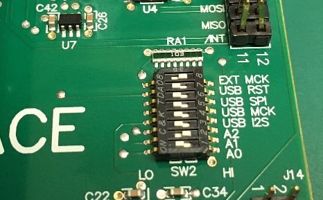

Hi Wayne,
Since most of the LEDs are active, I'm assuming that JMP6 is connected to pins 1-2 (USB powering on-board regulators) is this something you can verify? --I'm not entirely sure of the location of the jumpers from the image.
Page 17 of the EVM User's Guide also displays required Setting Configurations for device communication. Please let me know if this corrects the issue.
Matt

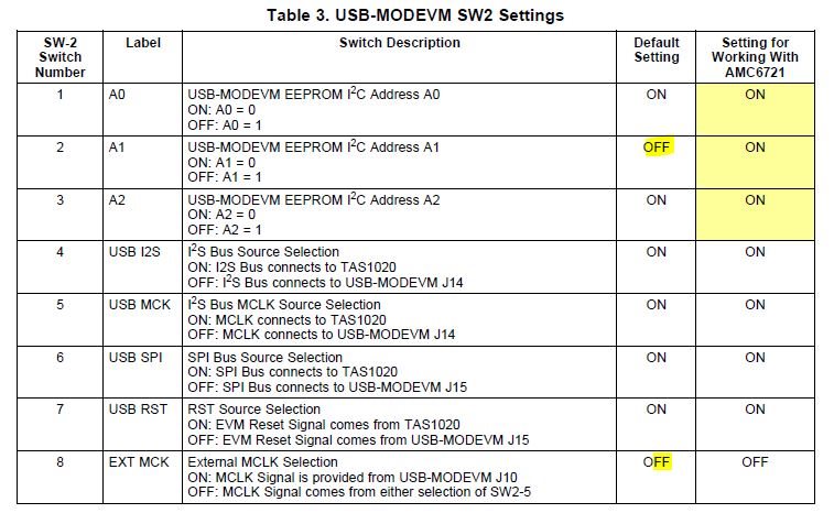

Howdy Wayne,
Can you verify the SW-2 locations and verify that it is set to the default locations listed in Table 3 of page 17 of the EVM User's Guide:
http://www.ti.com/lit/ug/slau195a/slau195a.pdf
Matt

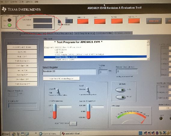

Howdy Wayne,
It looks like the board is receiving power correctly, one additional check is to probe the voltage on VDD. Are you able to write to and read from any registers? Are you having issues with device communication, or is this post related to FAN functionality?
