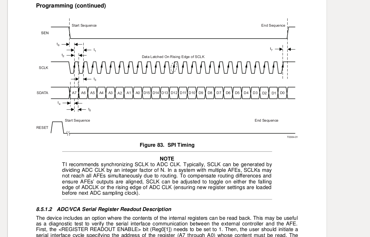

Can anyone tell me what is the recommended frequency for SCLK?
