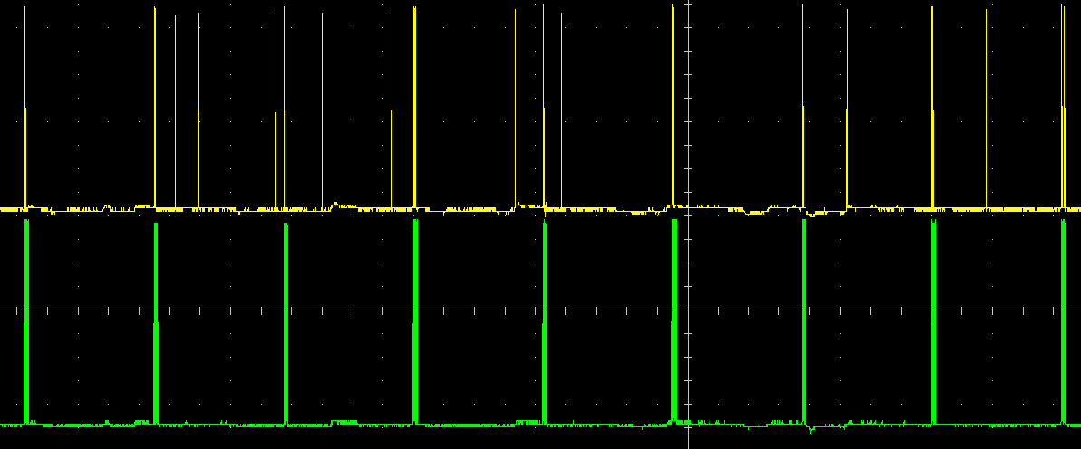

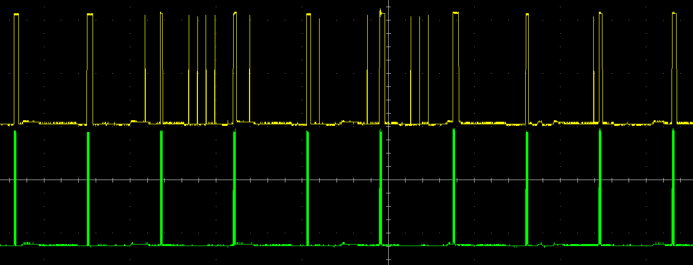

    but when i viewed the DRDY pin i am getting a high to low pulse. i am attaching the files below

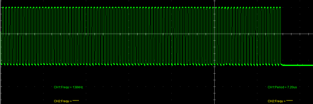

    this is the sclk ,for the normal default condition min sclk is 80khz ,i am also following the default condtion as and using spi sclk as 138,nearly 140kHz
    The above picture shows Dout(yellow) and Sclk(green)
    The above picture shows the DRDY (yellow) and sclk(green).

  • Hello Silpa,
    I can't tell what is going on in any of those images. Could you zoom in on a single transaction (i.e. when DRDY comes low and what happens immediately afterwards)? I'd like to see DRDY, SCLK, and DOUT.

  • Sir
    Thanks for the reply ,i can understand your difficulty ,but my problem is i am using a PC oscilloscope ,with that i am not able to check the waveform precisely.
    I tired to view the sclk but still it is not  able to view it properly,so currently i may not be able to zoom the single transactions.

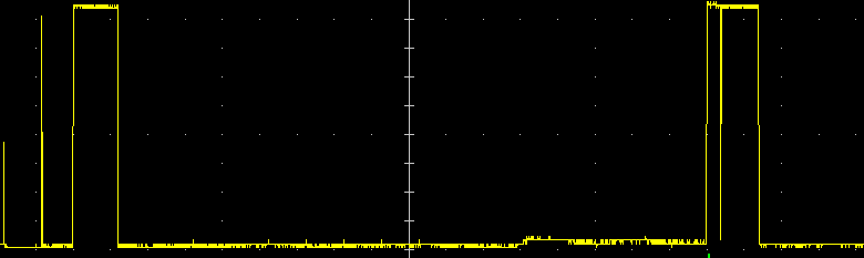

    this is my DRDY. Is this waveform correct? Normally it should be a high pulse when data becomes ready it become low ,right? what may be the reason for this inversion in the above waveform?
