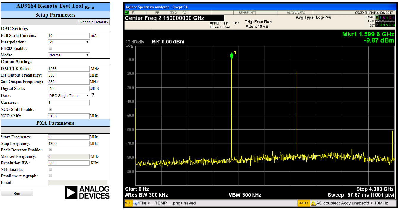

  • Hi,Jim
    Thanks for your reply, here is my idea:
    It is true that DAC38J84 only has two NCO's,but if NCO = Fs/2, I/Q data will be independent:
    Iout = {+I1, -I2, +I3, -I4…}
    Qout = {+Q1, -Q2, +Q3, -Q4…}
    since i need 300MHz banwidth center frequency 800MHz signal,
    1> i set data rate to 1066.6Msps,
    2> 2x interpolation enabled, NCO = 1066.6MHz,(sample rate = 1066.6x2=2133.2Msps)
    3> baseband signal is centered on the first Nyquist domain which is 266.65MHz +/_ 150MHz ,
    the output should centered on 3/8*Fs,that is : I will get I/Q output signal centered on 799.95MHz +/_ 150MHz , and I/Q output are independent.
    can DAC38J84 do this???

  •  AD9164 remote test tool is convenient,I use it to test my idear,due to lower sample rate limit,the sample rate is 2 times the condition of my application.
    I get the expected output at 1600MHz(2 times the condition of my application)
