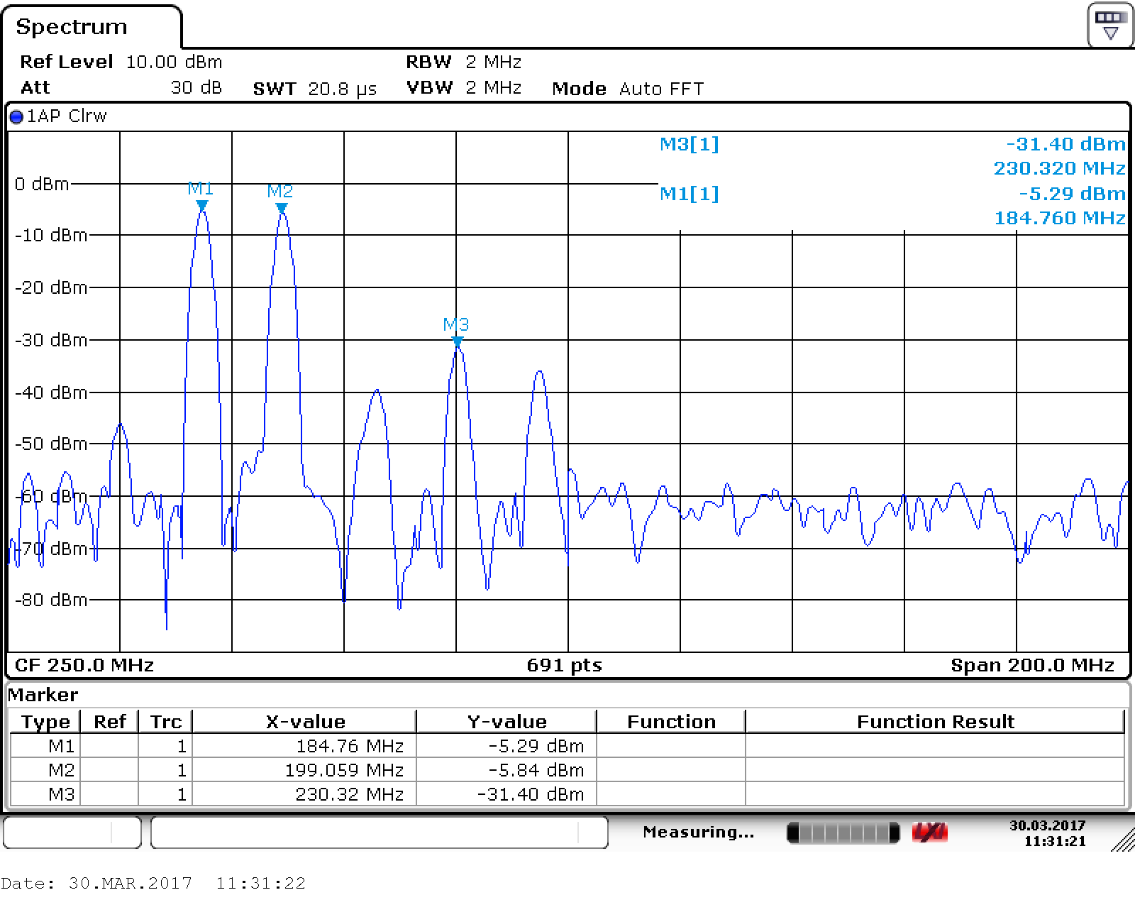

          We have designed a platform in which DAC3484 is interfaced with xilinx FPGA through FMC-HPC. Here, we tried giving 7MHz sine wave to all four four channels (I0 Q0 I1 Q1) generated from DDS in FPGA at 153.6MSPS rate.
The DACDATA_CLK is 307.2 and DAC_CLK is 614.4 (interpolation by 4). the DAC NCO is configured for 192MHz. FRAME signal has used for syncing source for FIFO. and NCO sync source is SIFSYNC.
but we had observed that there are two harmonics at 199MHz (192+7) and 185MHz (192-7) on the DAC output of channel C-D and 199MHZ on channel A-B.
what could be reason for such behavior ?

    Are you sending in complex signal into the AB and CD channels?  in other words sine and cosine at 7MHz?
    The NCO mixer is a complex mixer, if the input signal is sin on both A and B, then it is treated as a real signal and the sideband signal will not cancel.  The signal will then appear as a real signal at the NCO frequency (double sideband around the NCO).  If the signal is complex (single sideband) then the signal will appear at the outputs on only 1 side of the NCO frequency (one of the sidebands will cancel in the complex mixer).
    Please confirm if you are sending a complex signal into AB and CD.

    We are still seeing the same issues, we are giving samples from two DDS blocks generated in kintex-7 FPGA
    (one 7.199MHz to cahnnel A and B and 9.599Mhz to channel C and D), as Sine to channel A and Cosine to channel B and also for channel C and D respectively.
    DAC configuration-
    DACDATACLK – 307.2MSPS
    DACCLK – 614.4MSPS
    DAC NCO – 192MHz
    Interpolation – 4x
    syncsel_mixerAB=sif_sync
    syncsel_mixerCD=sif_sync
    syncsel_NCO=sif_sync
    syncsel_dataformatter=FRAME
    syncsel_fifoin = Frame
    syncsel_fifoout = Frame
    sequence followed:
    1) DAC reset
    2) program DAC registers
    3) provide sif sync
    4)generated an internal signal flag=1
    5)upon flag=1, after certain delay OSERDES(output serializer deserializer primitives, used for muxing channel A,B,C,D data at 153.6MHz rate to 307.2MHz clock as required by DAC) blocks in FPGA are reset and enabled
    6) FRAME pulse is generated
    7) DAC Txenable pulled high
    Two DDS are used to generate IQ (sine and cosine) for both DAC channels separately with frequencies mentioned above. The output rate is 153.6MSPS and DAC dataclk of 307.2MSPS.
    We found two components at 199.2MHz (192+7.2) and 184.8 MHz (192-7.2) in I1 and Q1 out. The same has noticed in I2 and Q2 out also. and upon powering OFF and ON analog card (where DAC3484 is placed) keeping Digital card (Where FPGA is placed) powered ON, we have seen components were at 182.4MHz (192-9.6) and 201.6MHz (192+9.6) respectively and which has changed to 199.2MHz (192+7.2) and 184.8 MHz (192-7.2) upon RESETing FPGA.

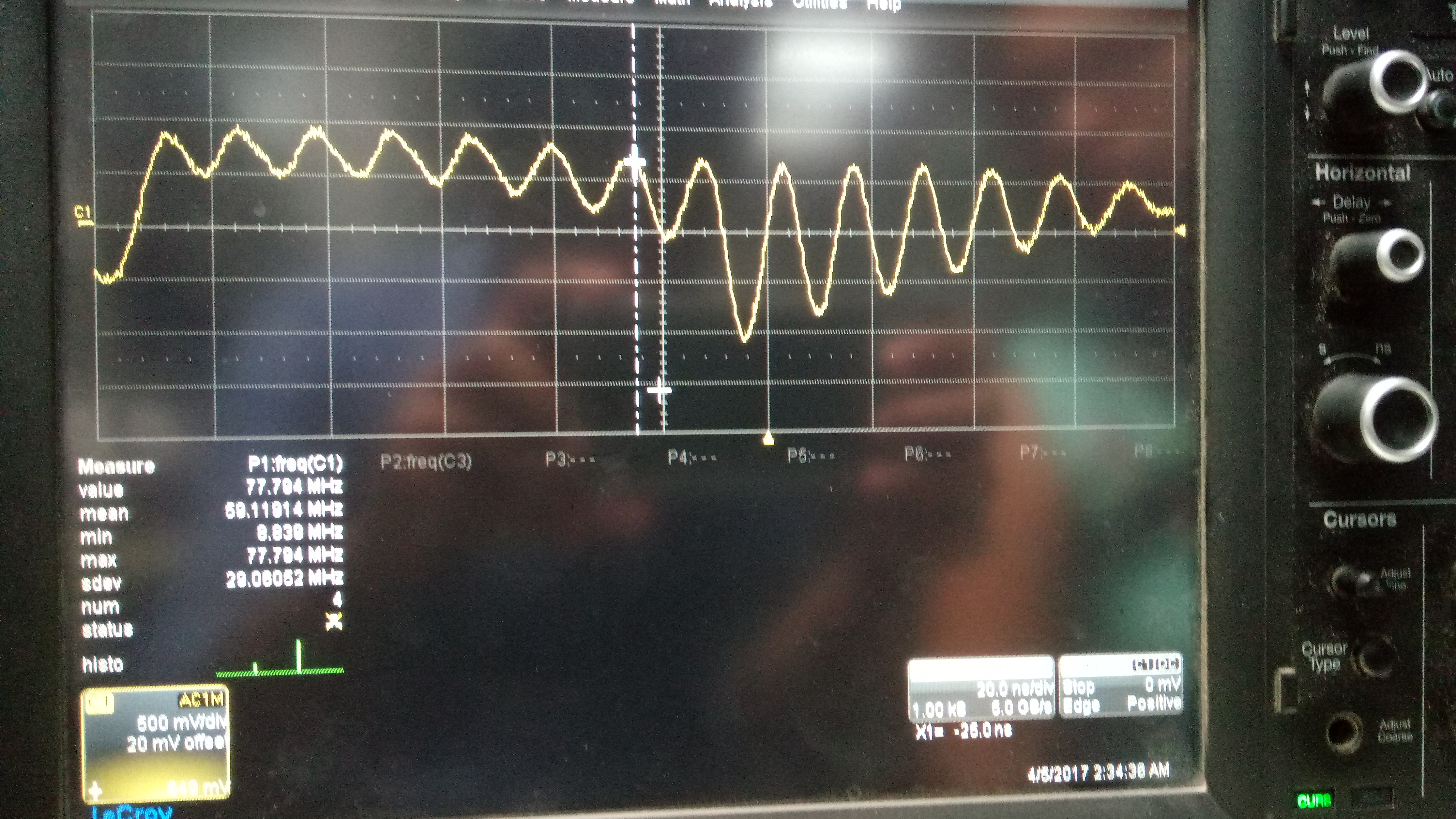

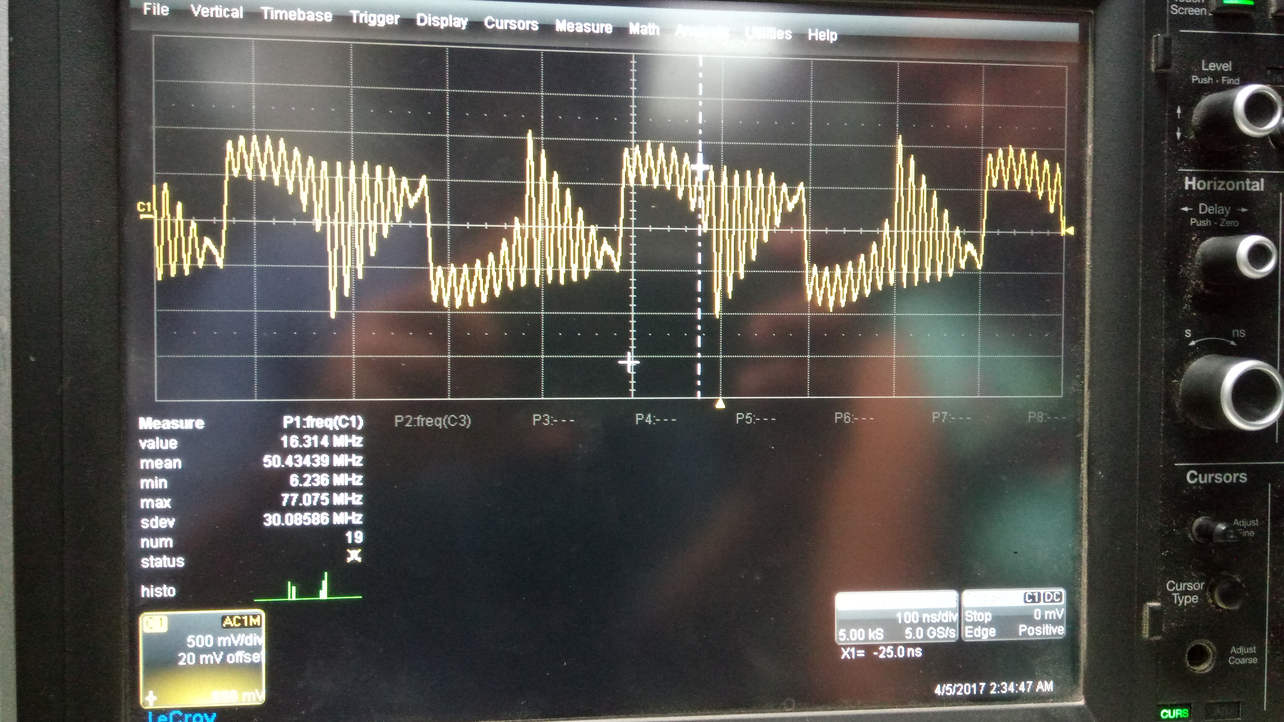

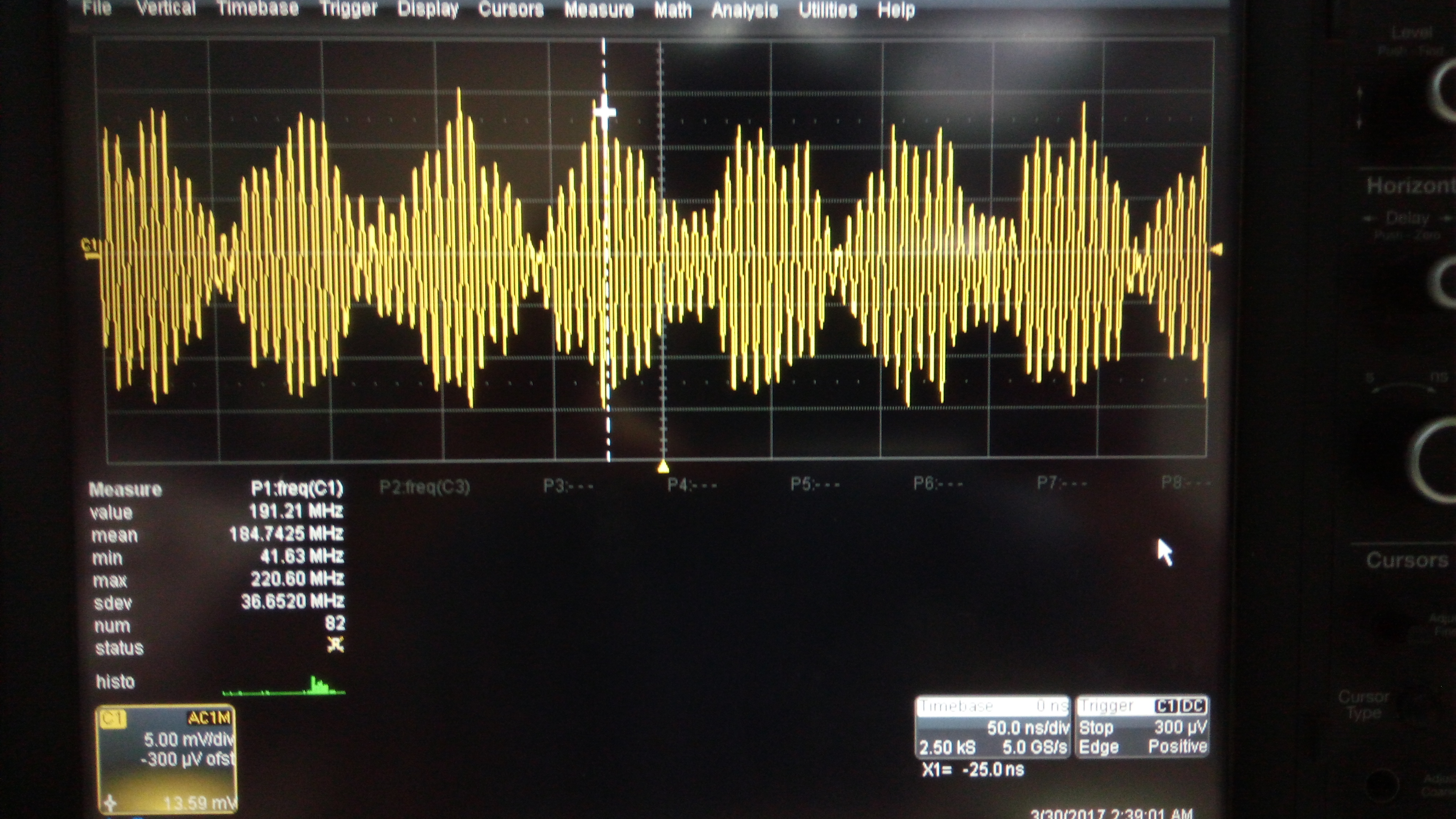

  • Please send a screen shot of channels A and B with the NCO mixer set to OFF.  If you do not see a sine or cosine, then your interface may not be working correctly, or your digital format (offset binary or 2s complement) may not be aligned between the FPGA and DAC.
    A screen shot of the DAC output would help us understand the possible issue.
    The other thing to try is to set the DAC input to constant level such as 0000 and then setting the input format to offset binary (this is in the INPUT Tab and is basically fullscale DC), then enable the NCO which will modulate the input DC level to the NCO frequency.  You should be able to measure a sine and cosine at the NCO frequency on output A and B.
    If this works then that means the DAC Is configured correctly and the NCO is working properly and the problem is in your digital interface/signal.
    Ken

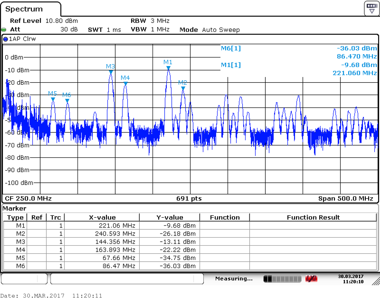

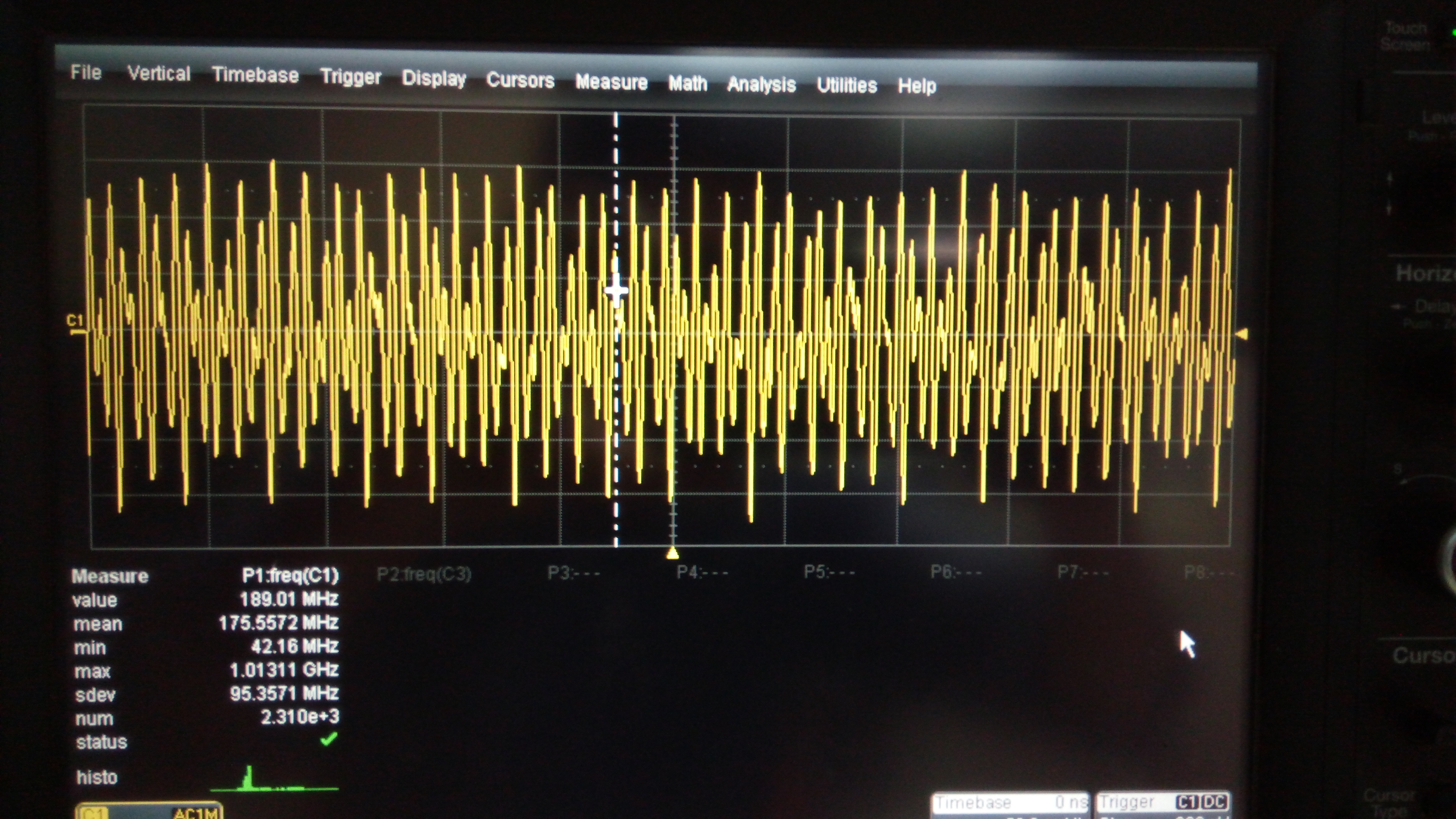

  • Dear ken,
    please find the attached screenshots.
    DAC outputs when NCO disabled.
    DAC outputs when NCO is enabled.
    The analyser plots.
    when NCO disabled.
    and when NCO is enabled.
     tgh

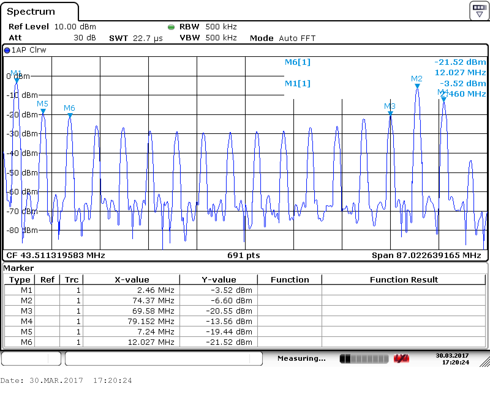

    The DC input was giving a single tone output at NCO frequency (192MHz).
    we tried with the DAC3484 evaluation module aslo ,  kintex7 fpga evaluation module is used for data interface.  DAC was configured using evaluation software.
    We have given 2.4 MHZ sinusoidal IQ and the plots were taken with NCO and MIxers disabled.

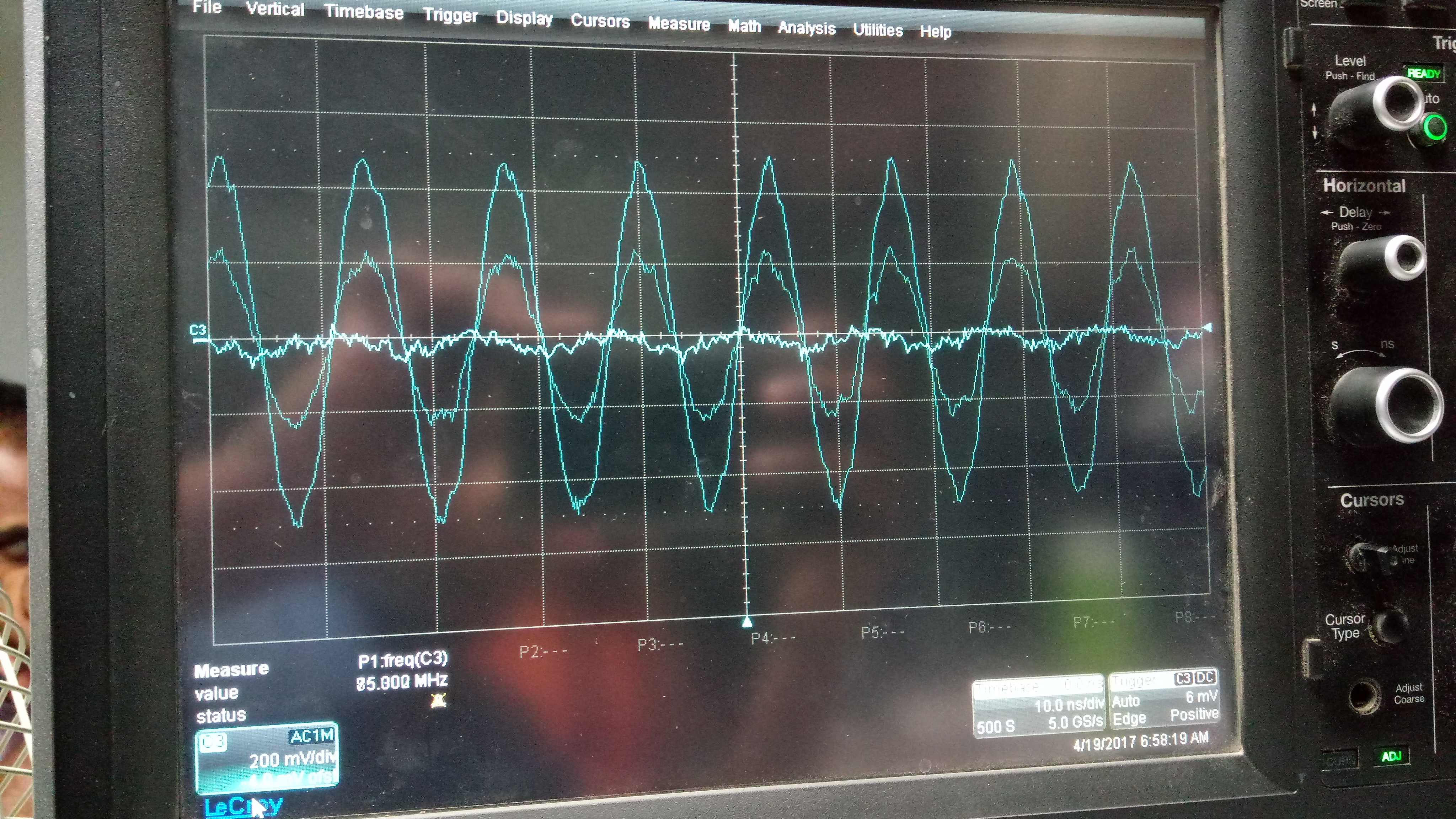

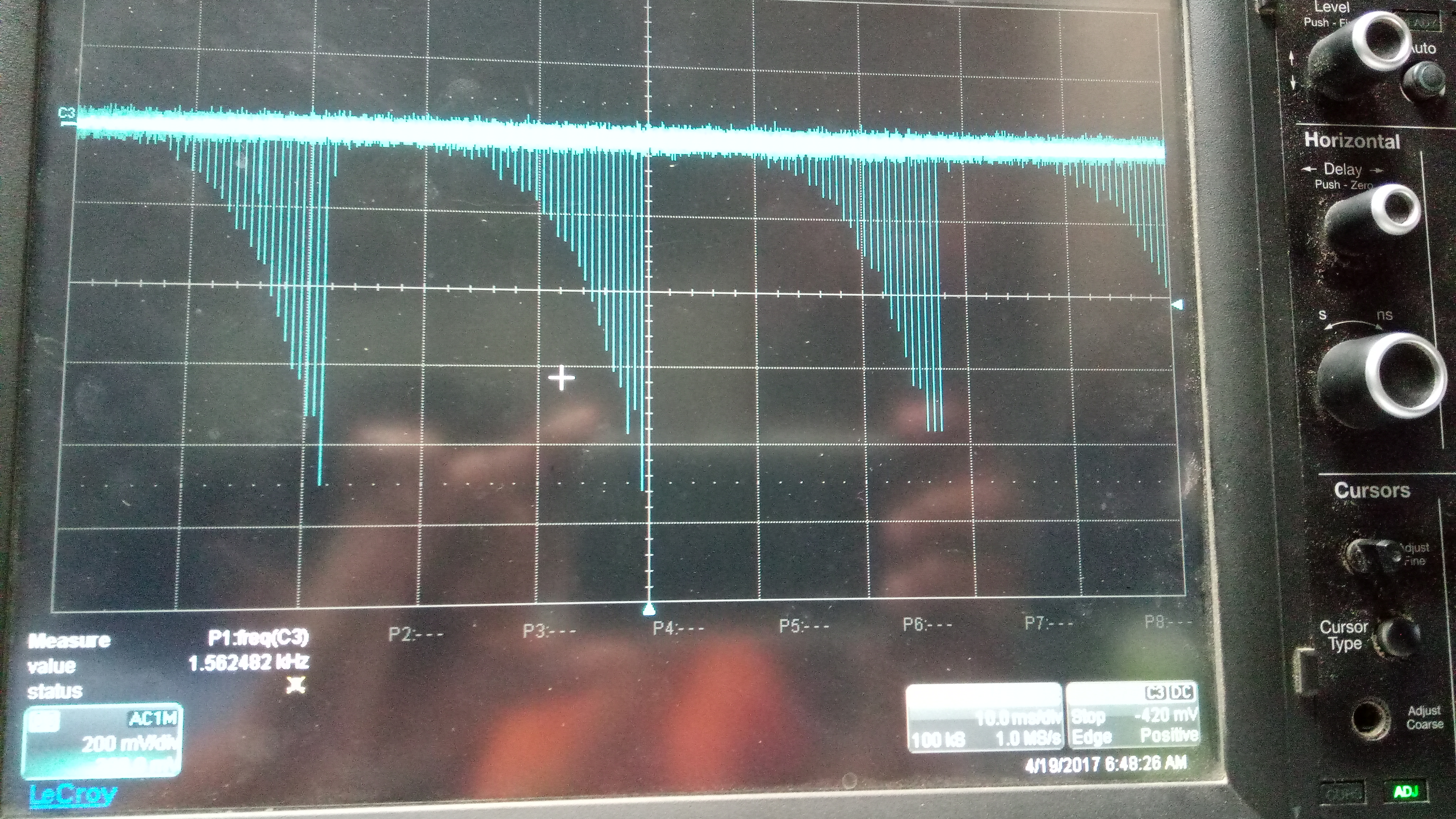

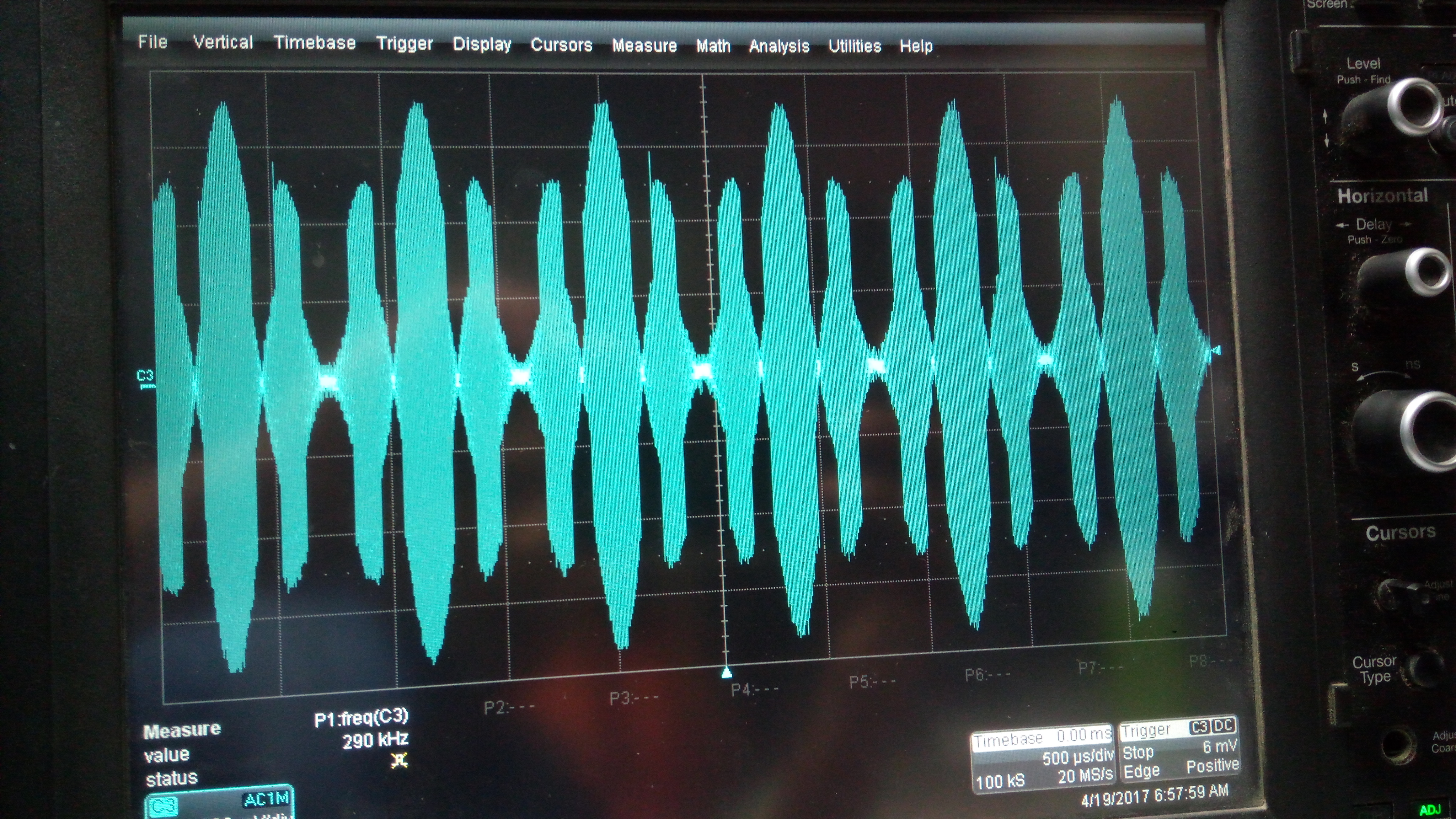

  • You mention that with DC input the outputs are at the NCO frequency with sine on A and cos on B. If this is true, this means the DAC is working fine.
    If you turn off the NCO and cannot get the DAC to output the correct signal, then that means you may have interface problems between the FPGA and DAC input.
    Can you send a time domain plot (oscope) of the last spectral plot showing the 2.4MHz signal?
    Ken.

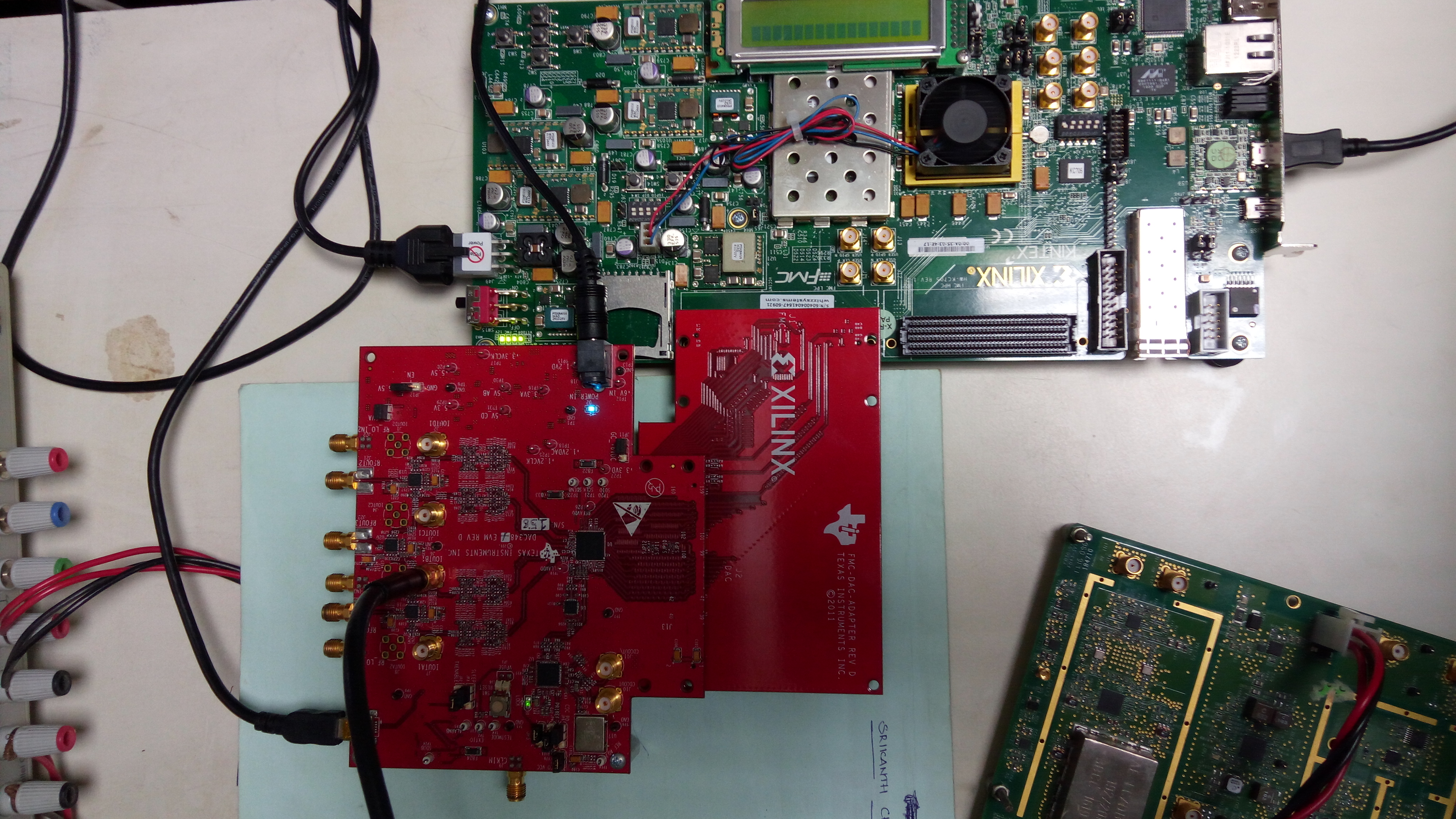

  • We had given 2.4MHz sine wave from kintex7 eval board to DAC484 EVM. The DAC NCO and mixer are disabled.

  • Nandakumar,
    I' m not going to be able to do much with the verilog code you sent.  That is beyond the scope of this forum.
    According to the spectral plot of the 2.4MHz signal it shows that most of the energy of the signal is at the correct 2.4MHz frequency.  However there are a lot of harmonics.  There are a couple of things that could cause this issue.  There is some digital clipping in the digital path or the digital samples are not being presented to the DAC correctly.
    As your earlier experiment with DC and just the NCO mixer showed the correct sine and cosine outputs on the ch1 and ch2 outputs, Lets assume for now that the DAC is configured properly.
    For the case of possible clipping in the digital path, please try making your digital signal smaller by 0.5x and then looking at the output.  This should help if there is clipping in the digital domain.
     For the other case where the digital signal is incorrect you will need to do some more experiments (NCO is always off in these cases).  Have you tried to run a really slow sinewave in the kHz range or a counting pattern?  This will increment the output in small increments at the datarate clock.  You should be able to follow this trend in the analog output and determine if there is some issue with getting the bits to the DAC - you should see incremental steps.  The assumption is that there is no transformer in the path (restricts low frequencies) and the signal is terminated properly and can be measured on a oscope.
    Hopefully this will help you determine your issue.
    Ken.
  • We had tried the above mentioned tests.
    Sine wave of 2KHz has given to DAC with NCO and mixer disabled. followings are the oscilloscope plots for different time scales.
    And after giving counter to DAC,
    All the above observation are tried in DAC3484 evaluation boar where the data has been provided from kintex-7 FPGA evaluation board.
    If you are using the standard DAC3484 EVM then the outputs are transformer coupled.  These transformer typically have a high pass response around 1MHz.
    With a 2kHz sinewave you should not get any outputs or a severely attenuated sinewave.  You are seeing a lot of transitions in the output which implies that something is incorrect with the bit pattern.
    Also when you sent a ramp, it looks like the outputs are dropping back to 0 in a repitive manner.  This also indicates that the bit order/pattern may have a problem.
    Based on these 2 experiments I would guess that the bit order is incorrect.  You can zoom into the ramp output and see if you can determine which bits are not working right.  For example based on your DAC output rate, you can measure the gap pacing.  This may help you determiine which bit would be expected to toggle at a certain time.
    I'm not sure if I can help remotely debug this.  So far it looks like some bit pattern/order problem.
    Ken
