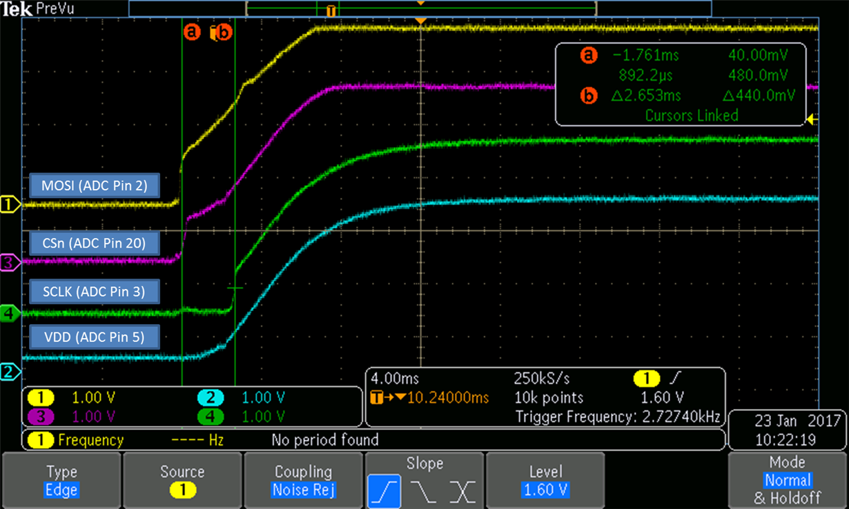

We’ve been using the TLV2548IDW ADC in our product (several devices per unit) for some time and have experienced a very rare event where after power-up, one of the devices (the same physical device each time) either doesn’t respond to SPI transactions, or is driving SPI MISO with all-ones data (because we have a pull-up on MISO it’s hard to tell which of these is happening). Meanwhile, the other TLV2548 devices in the system are functioning consistently good. All  devices get CFG register initialized to the same value (0x0004) which is basically the register default with only the EOC/INTn output pin mode set to EOC mode. With the problem present, if we can do a soft reset of our processor, the ADC in question starts to function and the problem goes away. The problem only happens at power-up and has happened on a few different units. Also, when running in this failed state (SDO all-ones output or tristate) for ~10 minutes, our processor got hung in a routine that polls the EOC pin for conversion completion. This seems to indicate that the device suddenly got out of the bad state and asserted INTn (instead of EOC). Are there any conditions that can cause the device to get into this bad state upon power-up?

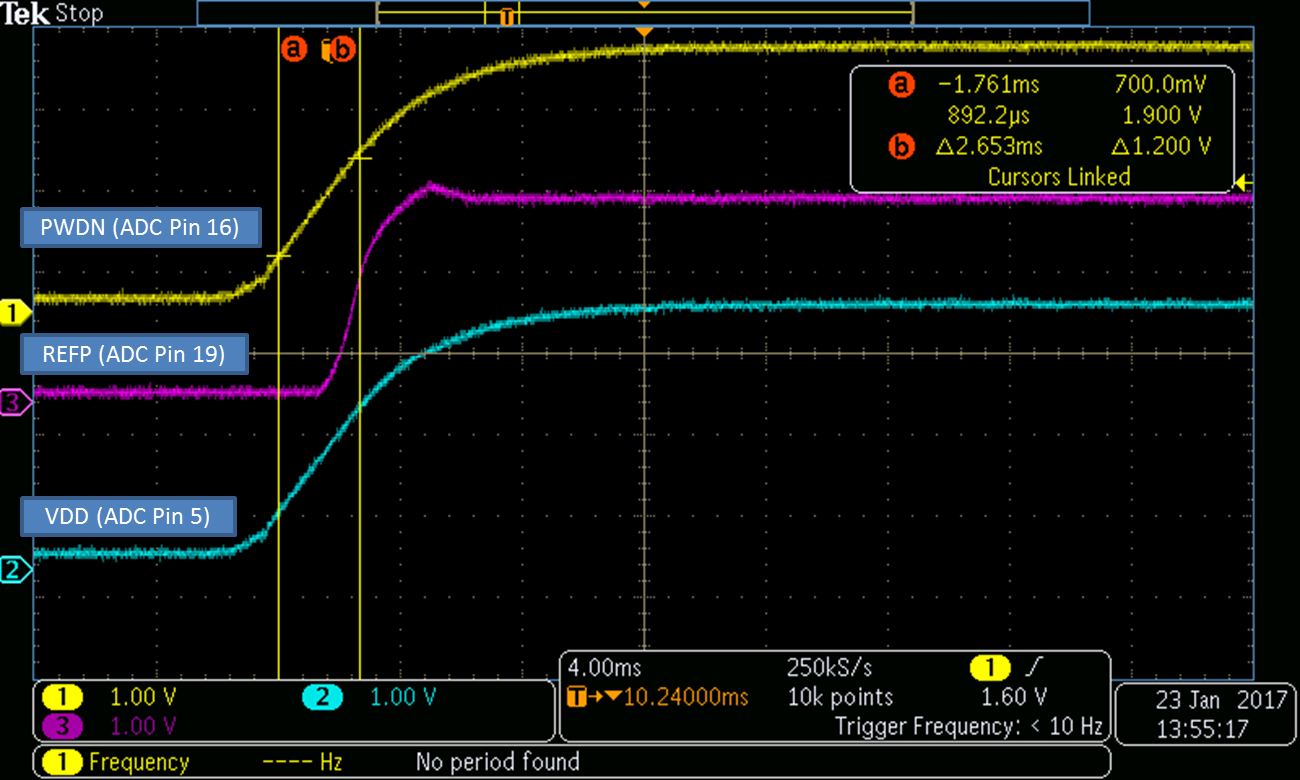

  • I've attached 2 scope captures, one showing timing of ADC SPI input signals relative to VDD at power up, and the other showing timing of PWDN and REFP relative to VDD at power up. Note that we are not using PWDN nor FS (both pulled-up to VCC).

    Thanks for providing the scope shots.
    I do not see any particular discrepancies with the power-up sequence of the ADC. As you mentioned in your query, this is a rare event which can be recovered by resetting the processor. I am thinking if the processor is the one which needed the reset.

  • As I mentioned, the ADC is buried deep in our already assembled system and so unfortunately I will not be able to do the device swaps that you are recommending, however, we have replaced the device in the past when this has happened on another unit and the problem went away. The reason we are concerned is that we have seen this with multiple devices on different boards so we want to see if there is anything about the use of the part that is causing a problem. I just want to go back for a moment to the first screenshot from 1/23 that captures the SPI signals relative to VCC during VCC ramp up. As you can see, the SPI signals are coming up before VCC and are greater than the device max. spec of 0.3v above VCC (the scope capture shows 0.8v above VCC) during the ramp-up period. From your 1/23 response you didn't see any particular discrepancies with the power-up sequence but I'm not sure that you noticed this and may want to comment further.

    I did notice the diodes on digital pins turning on during supply ramp up. This is not a recommended scenario because current through the diodes can be destructive to the device. However, all other ADCs in the system wake-up this way. Hence I asked for a digital write based recovery which would establish that there was indeed a sensitivity to IO logic during wake-up.

  • I should mention that not every TLV2548 in our system powers up in the same manner as the one in question due to our power distribution architecture. The scope capture shows the most extreme case, which is for the ADC that is exhibiting the problem. The other ADCs do not have the same voltage violation because they are on different power legs.
    Our processor I/O ports are defaulted to have weak pull-ups enabled during power-up and this cannot be programmatically changed. The weak pull-ups ultimately cause SPI signals at the TLV2548 to be high during power ramp-up. Because the processor’s weak pull-ups, writing code to force SPI signals low won’t help. Instead, we can add pull-down resistors to the signals in question on our processor board to prevent the VCC+0.3v signal level violation during power ramp-up. After power-up, the processor will configure its ports for SPI and drive the SPI signals to their proper levels by which time the TLV2548 on the other board will have its VCC already up. We experimentally tried this on a prototype system and it worked without any repercussions. However, we don’t know if this really solves the problem until we do extensive power-cycling, but I think that this is a step in the right direction.
