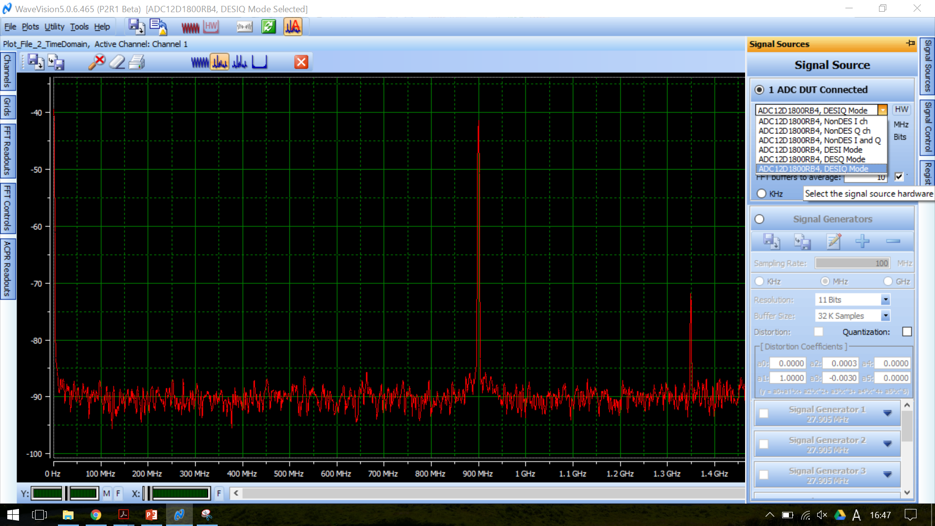

However,the WaveVision 5 Software not recognize ADC12D1800RFRB hardware.
The Software recognize ADC12D1800RB4 hardware by mistake.

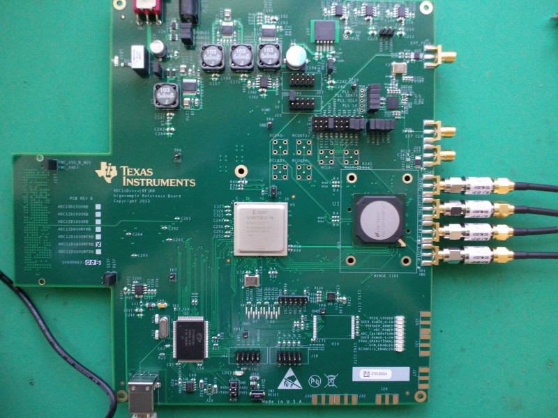

I attach the photograph of ReferenceBoard.
I attach the Select the signal source hardware of GUI.

    It appears that board may have been configured incorrectly during production.
    Can you find out when the university customer received the ADC12D1800RFRB?
    If they can provide any order, tracking, etc. information etc. that would be helpful.
