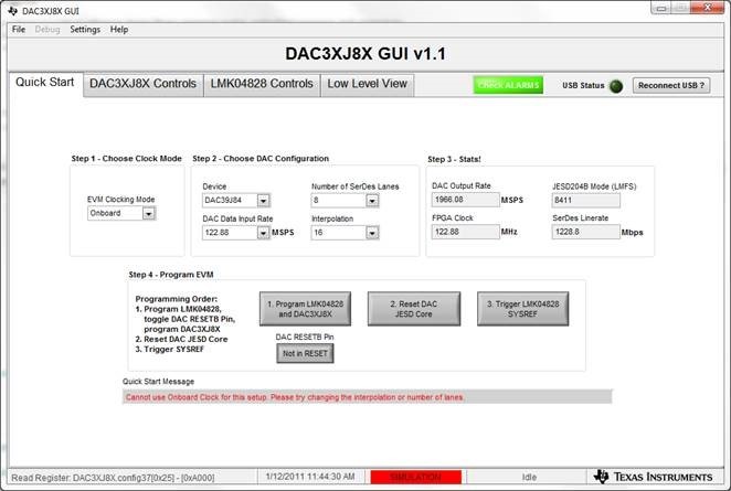

We are using the above DAC39J84 EVM and the TI software for this EVM.
We designed our system around the 8411 JESD setting, which the DAC39J84 datasheet indicates is a valid configuration. However, the eval board SW flags this as an illegal configuration.
We'd like to know if this is a legal configuration or not, and what we can do to fix it.  Our selection of 1966.8 MHz sampling rate and the 16 interpolation are fixed. For the rest we are somewhat flexible.
Here is a snapshot of the eval SW message indicating that 8411 is illegal. (Red "Quick Start Message" near bottom, and red status field at the bottom.)
