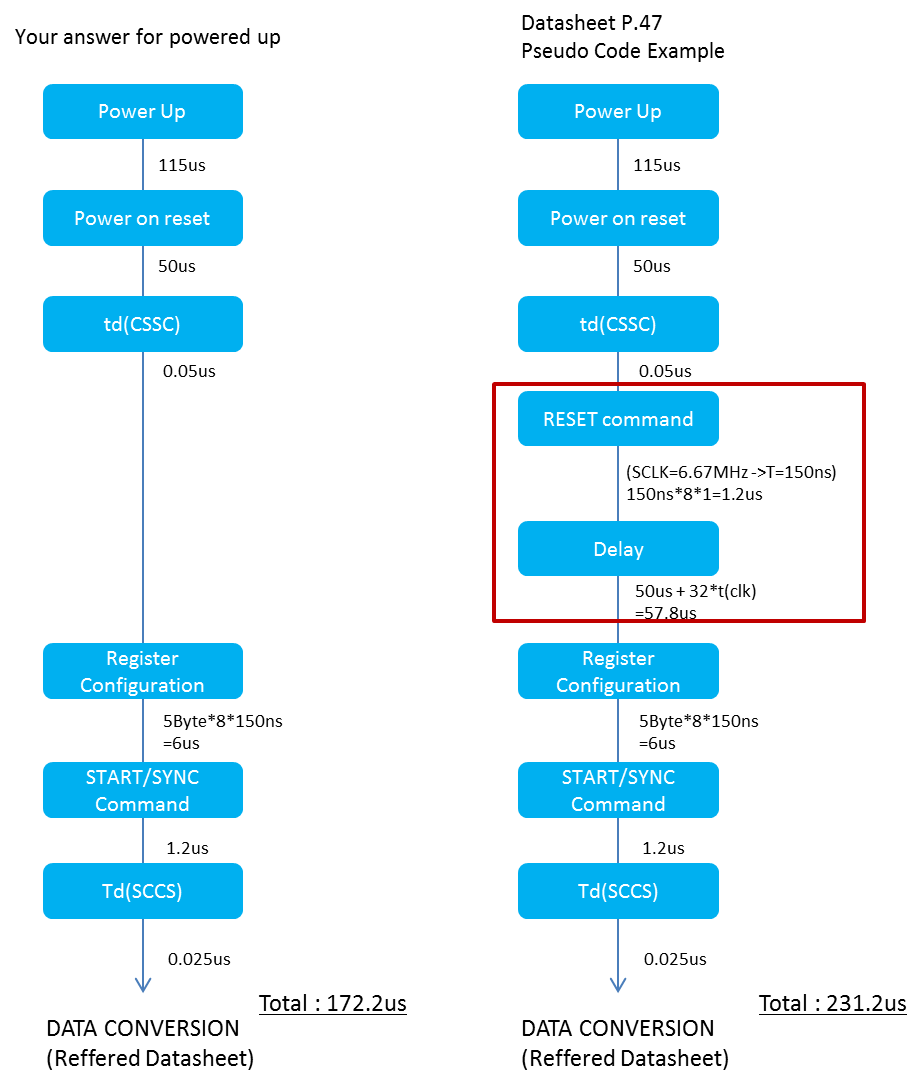

  • Hi Bob
    Thank you for your detail explanation.
    >The supply ramp must be no faster than 1V/50us
    Is it a specific characteristics of ADS1120? Or is it common to all products?
    And, according to your answer, I made the following flow charts.
    I made the right figure which would show the pseudo code example.
    The red square is the differences between pseudo code example and your answer.
    Is it no problem not to consider sending RESET command and the delay after RESET?
    BestRegards
  • Hi na na 78,
    The supply ramp rate is required for the ADS1120 and ADS1220 devices only to ensure proper startup over the full temperature range of these devices.
    The RESET command is optional.  If you follow the ramp rate recommendation, then you should have no need to add an additional RESET command as the power on reset (POR) accomplishes the same reset action as the command.  This decision is entirely up to you.  It does not hurt you to give the RESET command other than additional power that is consumed by adding the RESET command and the time to accomplish the reset.
