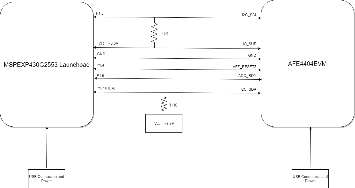

Hello, I currently have an MSP430 blue-wired to the AFE4404EVM shown through the block diagram below.
At the moment, I have been trying to use I2C communications with the AFE4404, but I am not getting a response at all. After the blue-wiring, the AFE4404EVM is not recognized by a computer and the external sensor does not light up when it is plugged in.
The steps that I have taken to debug this issue are:
Plugged the AFE4404 into the computer – It was not recognized at all; It did not show up in the device manager, and LED1 is the only one that lights up. The external sensor does not light up at all. This has been tested on multiple computers.
My teammate Victoria probed the AFE4404 board for shorts that may have occurred because of soldering and desoldering, but she didn’t find any.
I have made sure that the AFE_RESETZ is always set to high.
I have checked for the ADC_RDY pin to go high, but it does not go high at all.

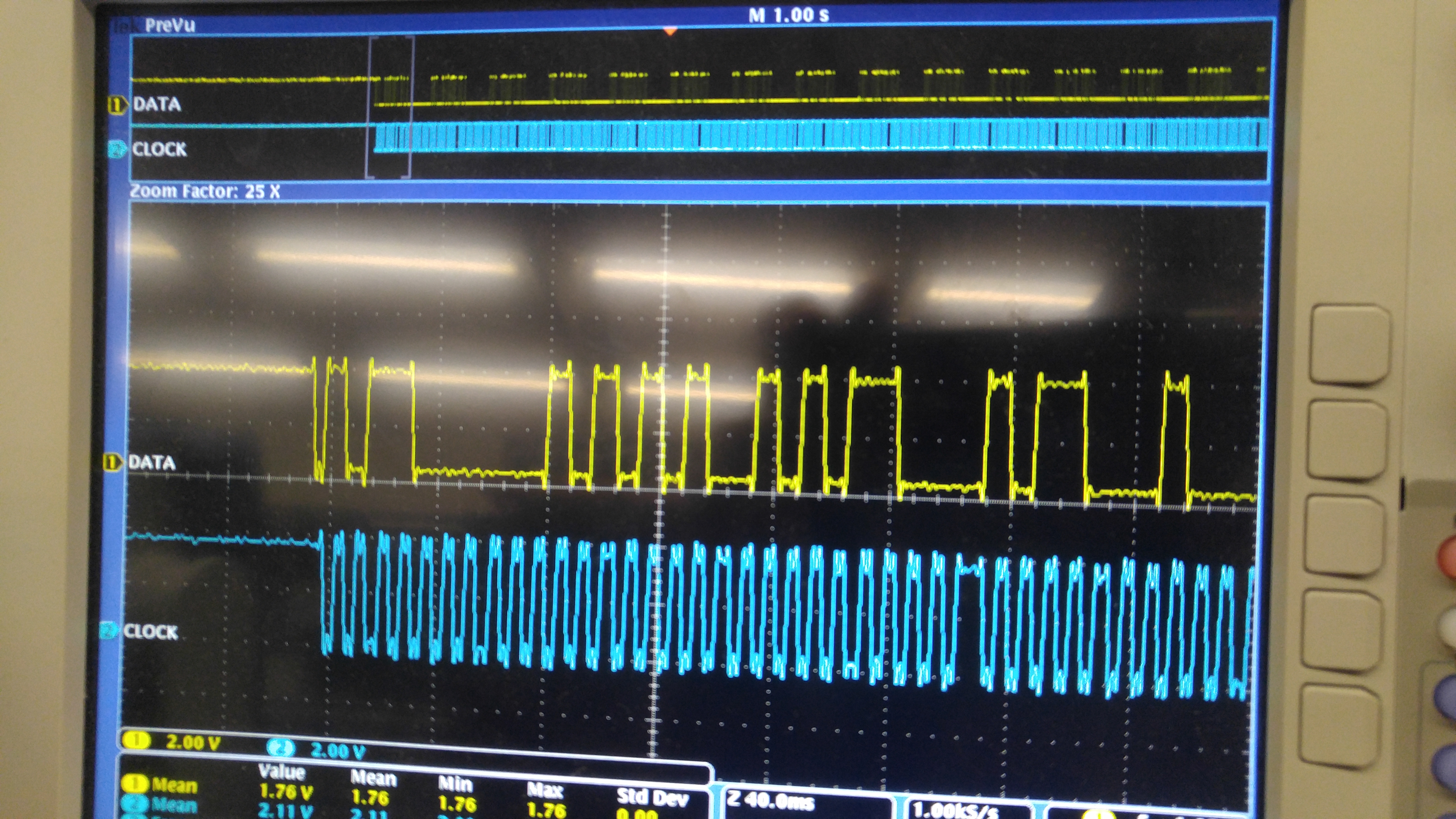

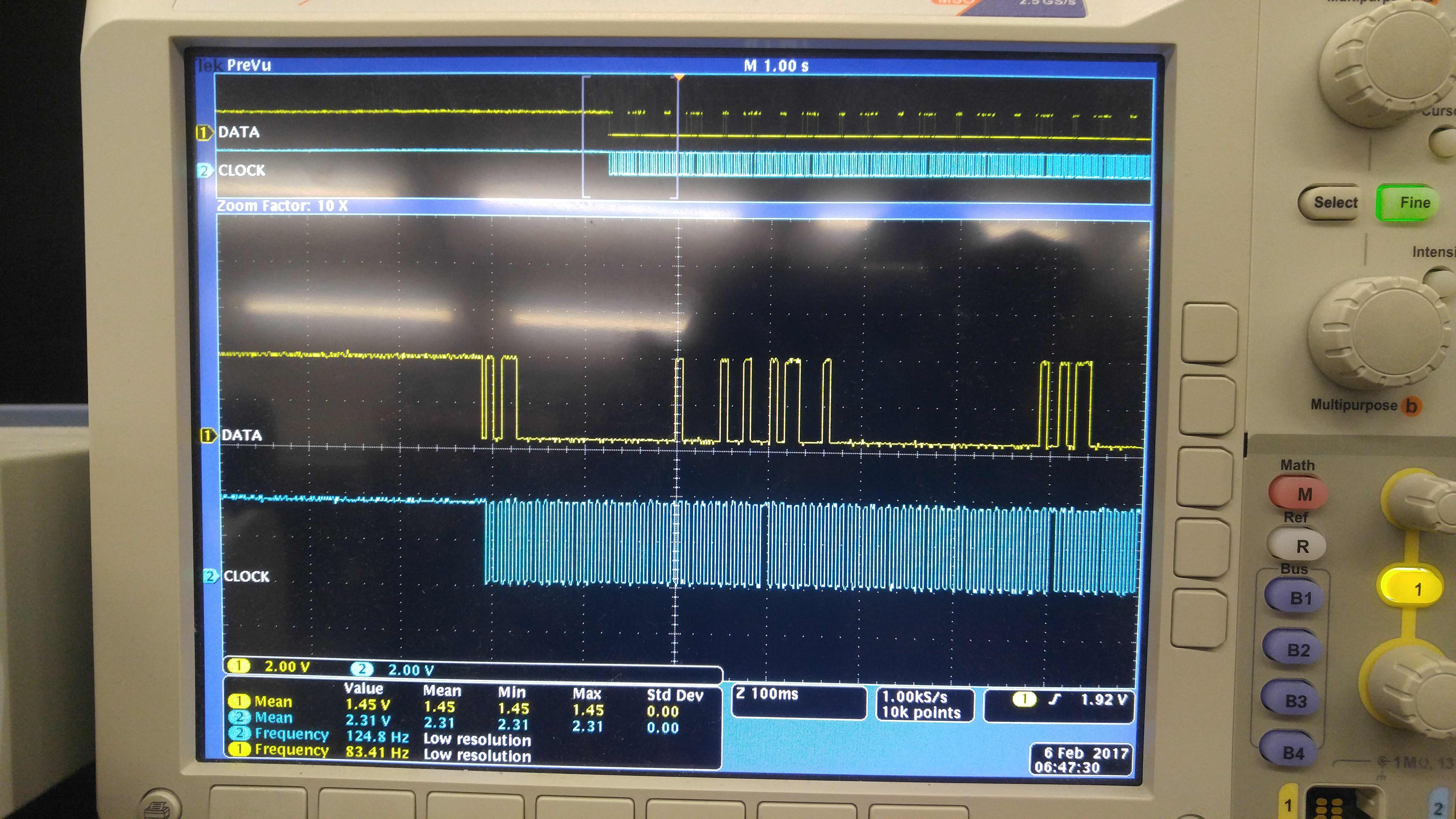

During my tests, I have been able to obtain these waveforms of I2C coming from the MSPEXP430G2553LP:
I have seen that the start and stop conditions are met for the I2C protocol.
The code that I am using is a modified version of one of the examples for I2C between MSP430 MCUs. It demonstrates transferring and receiving bits through I2C. When I stepped through the modified code, it was able to transfer the bits that I wanted it to send, but it does not receive any bits back from the AFE. I have altered the code to write to the ninth and tenth registers to try and turn on LED2, but nothing happened. I am not sure if I have approached it right or not, and I have attached the current version of the code that I was using. Another thing is that the GND that we are using is not the same ground that was in the MCU blue-wire document, and that the resistors are 11k because there weren't any 10k resistors available during testing. I have also attached a zip of the current version of the code that I was using for testing.
Below, I have attached a copy of the example that I have modified to get the first waveform that I have shown above. Have I gone about the right way to try and get data from the specific registers on the AFE4404EVM? I have checked the datasheet and found the timing registers, but I am not sure what I need to write to turn on the LEDs for example or read information from specific registers.

  • Hi Victor,
    Could you please provide following information:
    1) What is supply ( I/O level ) of MSPEXP430G2553LP?
    2) AFE4404EVM has a MSP430F5529 on board, did you remove connection of digital signals between this MSP and AFE4404?
    3) Without MSPEXP430G2553LP connected does your AFE4404EVM gets detected in PC?
    4) Lets try writing 0x1 to 0x23 register after giving pulse in AFE_RESET pin. Measure the voltage at INP/INM before and after this register write.
    Prabin
  • Hello Prabin,
    1. If you mean the I/O voltage level coming out of the I2C pins, I am getting around 3.85V on the SDA line, and 3.92V on the SCL line.
    2. According to my teammate, the only components that were removed were: R73, R16, R18, R7 and R8.
    3. When the AFE4404EVM is completely disconnected from the MSPEXP430G2553LP it does not get detected on the PC at all.
    4. Before the register write, I measured 0.3084V at INN. After the register write, I measured 1.11V at INN. Before the register write, I measured 0.130V at INP, and after the register write, I measured 1.08V at INP.
