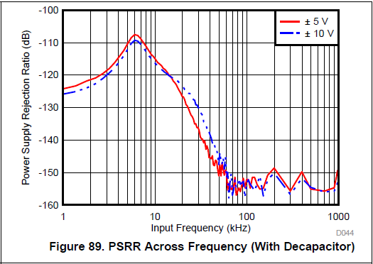

I am considering ADS8555 for our application, and have some questions about PSRR:
- Datasheet does not list a PSRR spec for HVDD, HVSS. On page 35, “The high-voltage supplies (HVSS and HVDD) are connected to the analog inputs. Noise and glitches on these supplies directly couple into the input signals.” Does this imply 0dB PSRR? Our power conversion designer is proposing 1MHz converter with ferrite beads and usual capacitive bypassing.
- Datasheet figure 10 on page 15 plots PSRR at fdata=maximum (630kSPS?), 60dB. Our application sample rate is 7.8kSPS. What is PSRR with this sample rate and 1MHz AVDD noise frequency?
