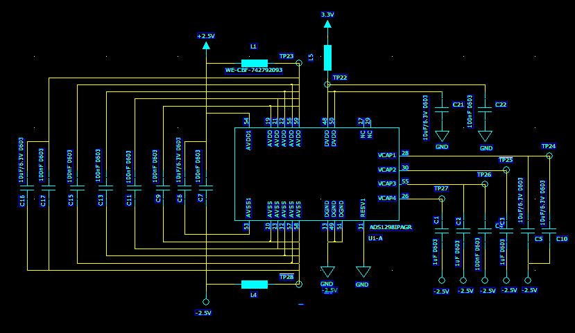

we are using the ADS1298 in an ecg-application.
 DVCC: 3.3V
AVCC: +2,5V
AVSS: -2,5V
We have the situation that during test we lose some ic because of damage.
The effect after this happened is:
  • Input-Impedance of Din is only 500R
  • in some cases the supply-current (normal 75mA) rise to 150…250mA
First thing we found was a peak on DVDD off 2ms to 4,2V during Power-Up. We put an 3.3V LDO in line to eliminate this peak.

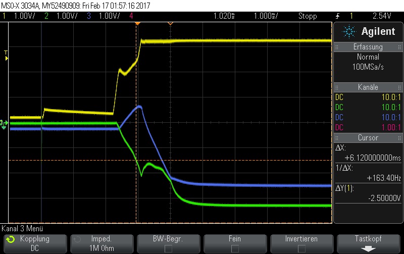

 A other thing that I can see with the oscilloscope is a short peak at AVSS to 0,8V ( it is coming out of the ADS1298).
So we put an Shottky-Diode in and we could limit it to 400mV.
Do you have an idea?

    At Power up I see an overschoot at AVSS of +750mV related to DGND.
    In section “Absolute maximum ratings” in the Datasheet AVSS to DGND is limited from -3V…+0,2V.
    With a resistor connected between AVSS and DGND and -2,5V disconnected I also see the peak.
    If I measure the 500R at DIN with a DVM the damage is permanent.
    I do not see any violation to the max. ratings except that at powerup at AVSS.

    an an attachmentI send you oszilloscope-pic of the poweron with 3.3V(yellow) and -2,5V (green)
    Thats the way we connectet the ADS1298 power-Pins
    Thank you for your help
    Jürgen

    DIn is direct connctet to MCU-GPIO (MOSI). Both devices are supplied with the same 3.3V.
    The ferrit beads do have 0,6 RDC, and 2200R at 100MHz. Between AVSS, AVDD and the ADS1298 we use 3,3µH inductance in addition.
    Juergen

    Perhaps try to probe DIN during power on to see if it ever rises above DVDD during that time. Could you also send me a more complete schematic so I can check for anything else that may be causing issues?
    Brian
  • Hi Brian,
    datasheet of TPS72325 tells us that "enable threshold Negativ" is -1.5V. Until that level the ldo is diabled.
    Attached a pic. Yellow -> 3.3V, green chargepump TPS60403 ( input for TPS72325 ). Blue -> output of LDO -2,5V.
    Juergen
  • Jürgen,
    Are you saying that the LDO that regulates AVSS is not enabled when this occurs? If so, there is nothing keeping AVSS below ground. Its voltage is not deterministic in that scenario. Do you see the same behavior when the LDO is enabled from the beginning?
    Brian
