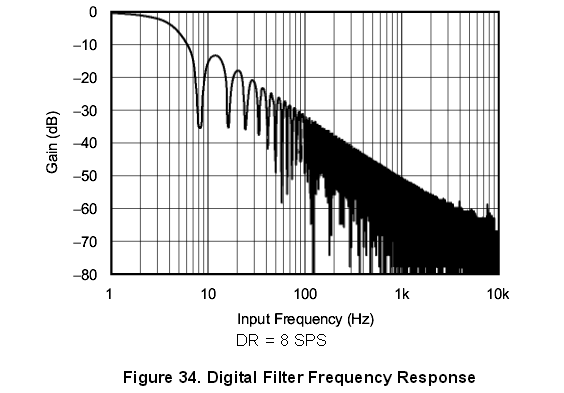

    The ADS1118 has some minor amount of 50/60Hz rejection. However, like other similar ADCs, this rejection depends on the data rate. First, let's look at the ADS1118 datasheet at page 14. Figure 34 shows the frequency response of the digital filter for the device running at 8SPS.
    This will have the best 50/60Hz rejection of any data rate for this device. It's hard to see, but the rejection will likely be about 25-30dB. This device wasn't designed to have a good notch at 50/60Hz to reject that noise.

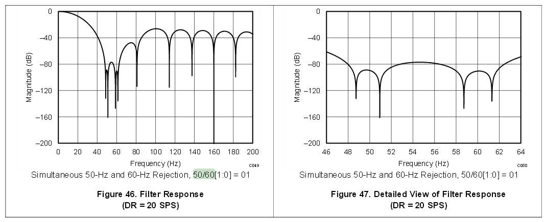

    As an alternate example, let's look at the ADS1220 at 20SPS, with a simultaneous 50/60Hz frequency rejection. A frequency response of the digital filter is shown on page 25 in figures 46 and 47. With this setting with the filter and data rate, the 50/60Hz rejection is greater than 80dB. This is a large improvement over the ADS1118.
    I'm still not sure how you think the INA will help you. It may have a good common-mode rejection, but most ADCs already have a good common-mode rejection. What you want is a normal-mode rejection of signals at 50 and 60Hz.
