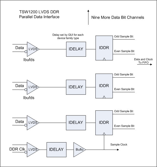

    I can describe how we interfaced the ADS5400 LVDS data to the Virtex4 on our TSW1200 capture card.   Please see the attached sketch which illustrates the input circuit in the FPGA.
    We bring the DDR clock and the data lines into an LVDS input buffer with the 100 ohm termination resistor in the FPGA enabled.  Then each LVDS line, both clock and data, pass through an IDELAY element.  This lets us individually skew the clock and/or the data to meet setup time into whatever is used to latch the data.
    The clock has to pass through a clock buffer, so the data had an IDELAY setting to make the data path match the clock path with regards to timing.  Then we used an IDDR cell to latch the data on the rising edge and falling edge, while reregistering the falling edge data over to the rising edge.  At this point, the sample data is ready to be used in the FPGA for whatever you wish to do with it.
    On the TSW1200, we chose to use the ADS5400 in dual bus mode, so there are more LVDS data channels that i had initally indicated in the attached file.  I use in fact 24 LVDS inputs and clock at 500Mbps.  But the Virtex 4 is fast enough that i *could* have operated in single bus mode for 12bits of data at 1000Mbps using the same logic in the FPGA (the input buffer, IDELAY and IDDR).
    The IO standard for the input buffer was just LVDS_25 as in this code from my constraints file:
    NET "D0_p_pin" LOC = "A16" | IOSTANDARD = "LVDS_25";
    NET "D0_n_pin" LOC = "B16" | IOSTANDARD = "LVDS_25";
    and
    INST "IBUFDS_inst00" IOSTANDARD="LVDS_25";
    and for the termination resistor
    INST "IBUFDS_inst00" DIFF_TERM = TRUE;
    And for meeting the timing of the setup and hold (finding the right settings for the IDELAY) we take our best guess at what the IDELAY deafult tap settings should be and set that as default powerup or reset IDELAY values.  Then we check the static timing analysis report after place and route, looking for timing violations.  If there is a timing violation on the DDR input data, then we look at the magnitude of the violation and that tells us how many IDELAY tap settings we were off by on our initial guess.  Then we rerun the timing tools to verify.  (This all presumes that you have the timing constraints entered into the ucf file to describe the clock rate and the setup and hold timing from the ADS5400 data sheet properly.  This is not trivial - i always found this particular step to be less than obvious to get done correctly.)

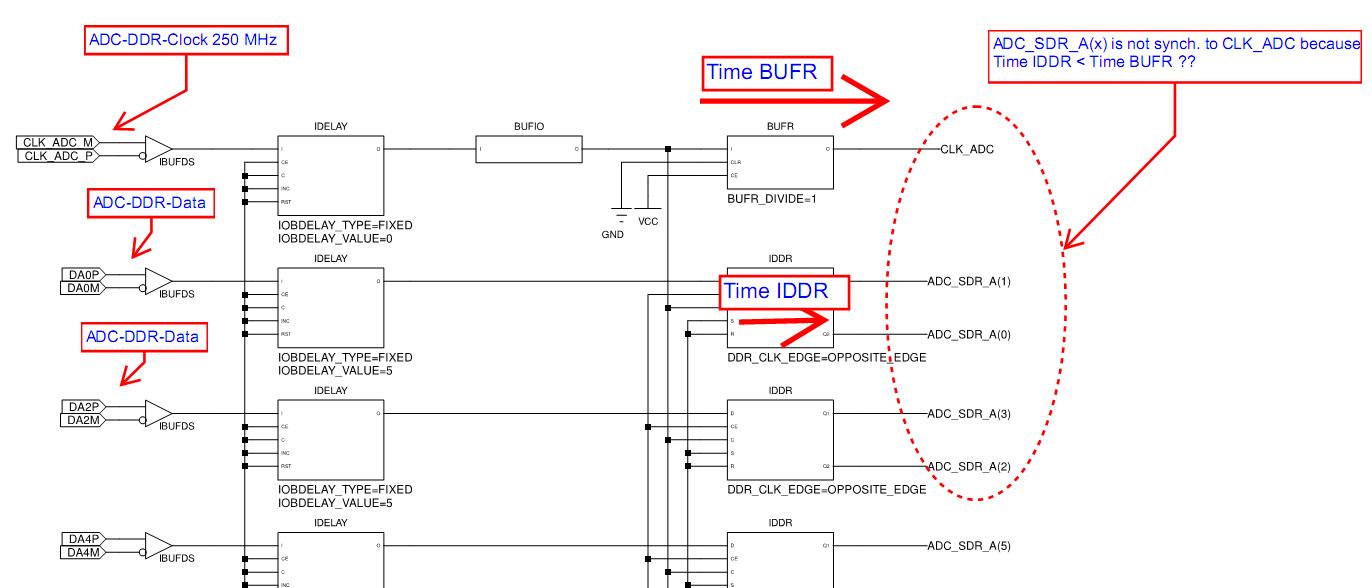

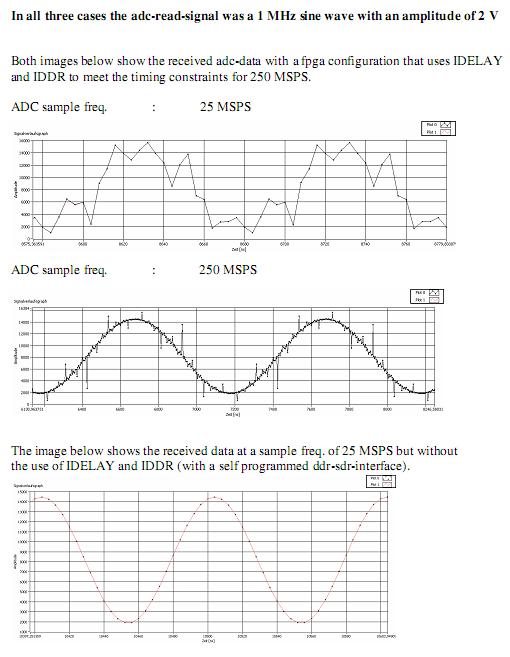

    My first fpga configuration was a ddr-sdr-converter and fifo with rs 232 interface to send the adc data to the pc. The first ddr-sdr-converter has been programmed by my self (without IDDR). This configuration works correctly with a sample frequency of 25 MHz. When I set the adc sample frequency to 250 MHz it doesnt work - but this is not a miracle - for 250 MHz I have to use the IDDRs.
    So I deleted my self written ddr-sdr-converter and insert IDDRs with IDELAY before... I set the timing constraints and set the idelay so that the timing of the design get met as you described ...   But neither with 25 MHz nor 250 MHz the IDDRs works correctly... see the image below...
    I guess that there is a synchronization problem - see image below - the clock and ddr-data come synchronous into the fpga and go through the IDELAY elements. The timing constraints and report says that everything is ok. But I dont know if the timing constraints cover the path thrugh the BUFR and IDDR... I guess that the data flow faster through the IDDRs than throgh the BUFR and so the fifo that is direct driven by the CLK_ADC and the data ADC_SDR_A(x) is not anymore synchronous... ??? My timing constraint are:

    Do you have a hint for me or do you know the failure I do??
    Problem solved!
    The problem was, that the adc-ddr-clock is connected wrong to the fpga-lvds-input-clock-pins: the p site is connected to the n site and the n to the p site -> so, the adc-ddr-clock comes into the fpga inverted. Because there is no opportunity in the io-logic to invert the incoming clock - I had to change the outputs of the IDDR primitive and use it in the OPPOSITE_EDGE mode (SAME_EDGE_PIPELINED is not possible because of the inverted clock!!!).
    The wrong data consists of the inverted clock - the data that comes out of the IDDR is not valid with the rising ege of the clock signal - it is valid with the falling edge and changes again with the rising edge!!!
     So I insert a buffer that buffers the incoming data by the IDDR with every falling clock edge and so the fifo can take the data with the rising clock edge...

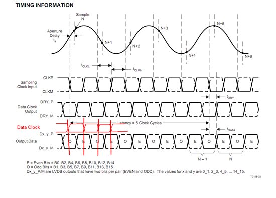

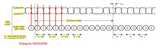

  • Good morning...
    to your question / answer #2:
    the data is not realy multiplexed - it' is in a dual data rate format... As you can see below there is the timing information of the ADS5483 and ADS62P49 (both use ddr as output).
    The difference between the two timing diagramms is, that in the timing of ADS5483 the clock and data is in phase and because of this you cant say the data is valid with the positive or negative edge...
    In the timing of the ADS62P49 you can see that the even bits are valid with the positive edge of "CLKOUTP"  and  the odd bits with the negative edge of  "CLKOUTP...I use the ADS62P49 and can confirm the timing diagram....
    So I think there is either a failure in the timing diagramm of the ADS5483 or the timing diagramm is right and you have to delay the clock within the fpga and then drive the IDDRs... and this question shoud be answered by somebody of TI...
    Timing of the ADS5483
    in red you can see how the clock shoud be for a source synchronous design...
    Timing of the ADS62P49
    To question/answer#3 : what exactly are you planning to do?
    Regards S. D.
