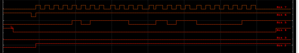

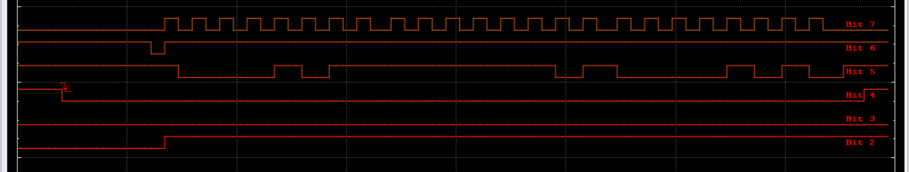

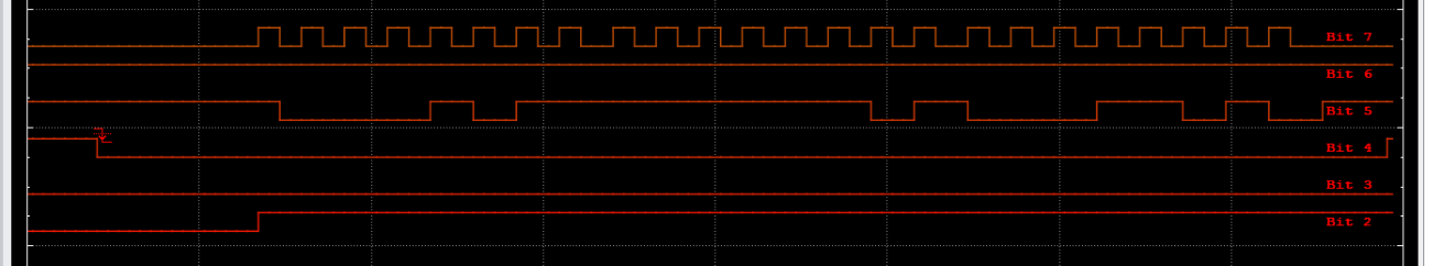

  • Hi Bob,

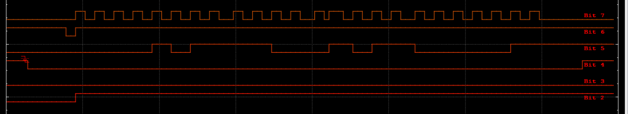

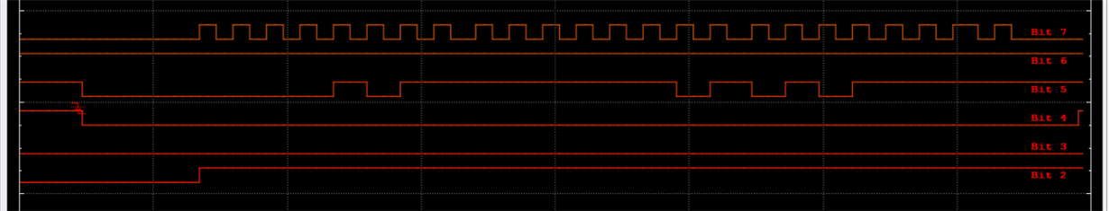

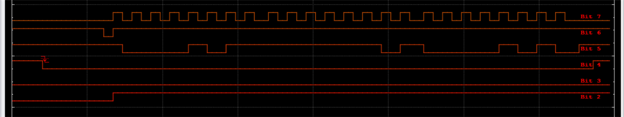

    I got a logic analyzer from a colleague, and took some pictures.
    Usually the wave form looks like this;
    But sometimes like this. (I'm not 100% sure, but I tink this one is wrong.)
    The SPI settings for this were speed: 40.000, MSB first, mode_1. I don't know what 40.000 exactly means, but the pictures have 32 microseconds / div.
    The speed was previously higher, but I lowered it to get a better picture.
    I also tried something else;
    When I "really" write to the SD card (as opposed to the softwarebuffer), I always see the following wave form. All The readings also look good.
    Maybe the periodic thing I initially saw is somehow related to the buffer filling up.
    Fyi, bit2 = DREADY, bit4 = CS, bit5 = DOUT/DREADY, bit6 = DIN, bit7 = SCLK
    Do these pictures help to see what's wrong? I don't have any experience with it.

  • Hi Marc,
    The pictures show something very interesting.  For the ADS1220, the SCLK rising edge changes the data and should hold on the falling edge for the data to be latched on the falling edge by the micro.  Note on bit 5 (DOUT/DRDY) that the msb clock (first clock) is transitioning on the falling edge when the data is incorrect.  Logic analyzers do not show the exact voltage value, but rather a logic value so we don't know if something is changing on the clock edge or if there is some other possible interference.
    My next questions relate to whether you have a pullup on the DOUT/DRDY line?  And when does CS go high for the SD card?  Also, if you can send me your schematic and ADS1220 device configuration that would be helpful as well.

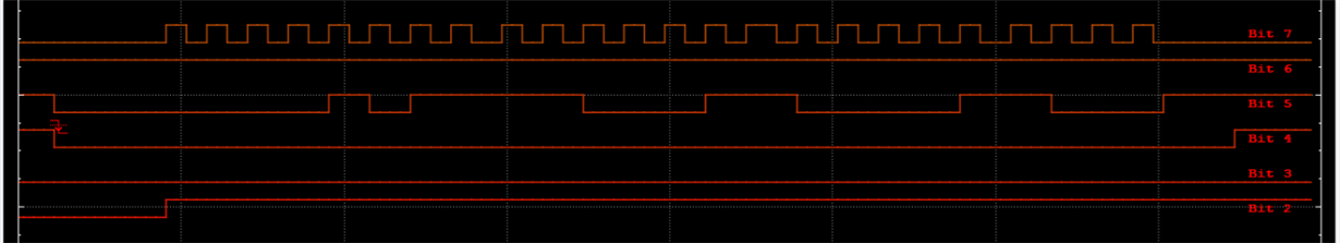

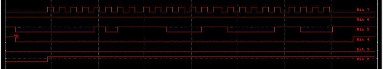

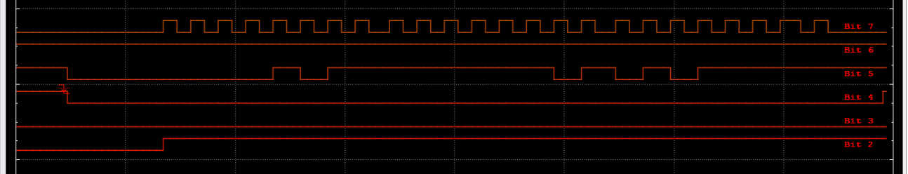

  • Hi Bob,
    Thanks for your fast reply,
    I wanted to report you already that I think I made some progres; I had an idea the SD library is somehow wrong and I changed it.
    The result looks quite promising at first sight, there are no more wrong readings.
    Especially the second picture here looks interesting because it shows bit5 low at the beginning, in my previous post, bit5 was always high.

  • Hi Bob,
    I had the program with the new SD library running over night, and the "MSB switch" didn't happen.
    The "bad" library in question is the standard Arduino SD library. I replaced it with "SdFat" from Greiman.
    If we can assume the 2 wave forms from my last post are correct, the second and third from my first post are wrong. By some coincidence only the second gives wrong readings. I think the second waveform happens when the software buffer is full, and the third when you "flush" the buffer by hand. Of course this is just speculation from my side, and also a bit useless since Greiman has already solved this a long time ago.
    Actually, I would expect the third waveform also to give bad results, but somehow it doesn't. Is the data transmitted somewhere after the falling edge and before the rising of the next clock? I suppose I could check the datasheet for this, but I got the feeling you know this by heart :)
    Marc
  • Hi Marc,
    For the ADS1220, the data in the output buffer is latched on the rising edge and is fully valid on the falling edge of SCLK.  In your error condition there appears to be some contention of the DOUT line as the result does not follow what is expected.  Apparently your new driver code eliminates this contention.
