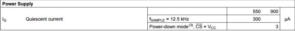

2. I could not see the minimum value of Iq.
Can you provide it?

    - We do not offer a guaranteed minimum spec for current consumption.  Looking at a typical distribution spread  for current  with VCC=5V,  Fsample=200kHz, at 25C, the quiescent current minimum is expected to be approximately ~500uA.

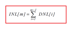

    Yes, I have found a number of publications available from different authors, some of them define TUE as the RSS of offset, gain, INL and DNL; while others define TUE as the RSS of offset, gain and INL.
    Below is the link to one publication that does not include DNL.   There are other publications from other manufacturers as well that define TUE as the RSS of offset, Gain and INL without DNL.
    https://e2e.ti.com/blogs_/b/precisionhub/archive/2014/10/14/adc-accuracy-part-2-total-unadjusted-error-explained
    Strictly referring to the non-linearity definition, INL(integral non-linearity) is the measure of the deviation of the code transition or code step levels from the ideal straight line, and it is defined as the maximum difference between the ideal and actual code transition levels after correcting for gain and offset.   INL can be found by computing the cumulative sum of DNL by the equation below; therefore, an ADC's INL error already incorporates DNL.   In other words, INL is the integral of the DNL errors:
    As previously mentioned, TUE is an estimate of uncalibrated total error and in the case of the ADS7841-Q1, we only guarantee the min/max specifications provided in the datasheet.

    Sorry, regarding to Iq, please tell me the following.
    You said Iq(min) with VCC=5V, Fsample=200kHz, at 25C, is expected to be approximately ~500uA.
    Can you offer Iq(min) which is applicable in all temperature range?
    BestRegards

  • >>>Can you offer Iq(min) which is applicable in all temperature range?
    We cannot give Iq(min) that is applicable over all temperature range.  Designers usually consider the worst case Iq(max).
