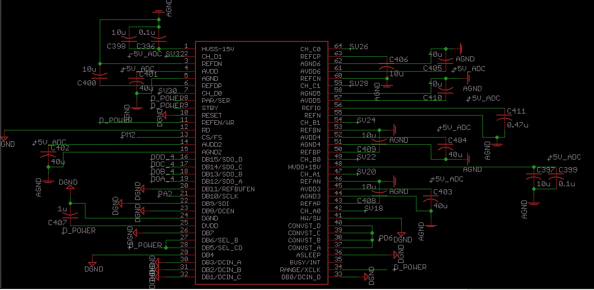

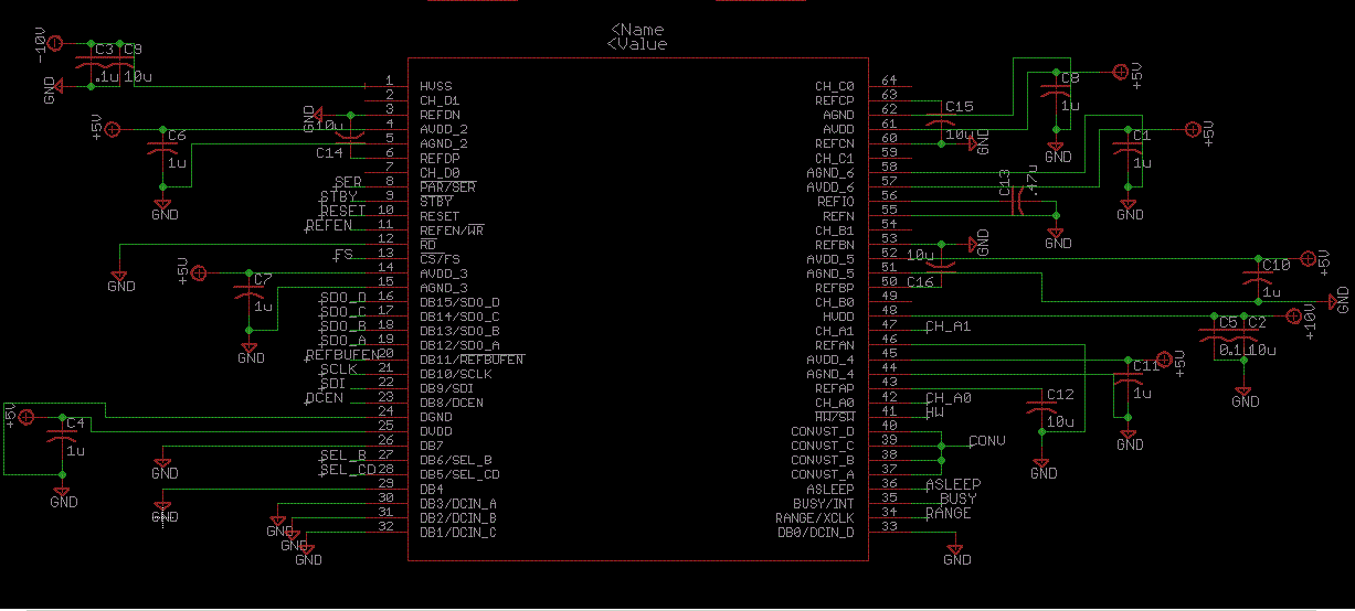

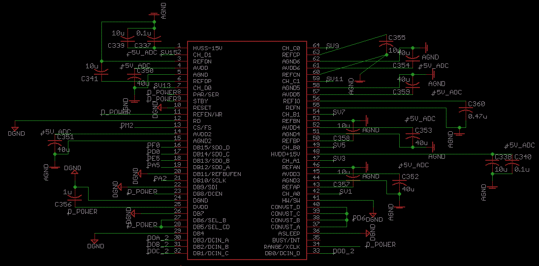

This is my first thread here.  I'm having trouble setting up my ADS8568 in SW mode. I'm using serial interface, and just trying to start conversion and reading data from the ADC.
I'm running the master device TM4C123GH6PM microcontroller.
To verify that my ADC is soldered to my breakout board correctly, I'm seeing about 0.001mA from my Multimeter.
Please see code and my schematic. Thanks.
-Ianadc8668_sch.sch

  • Hello Ian,
    Could you please clarify how you checked the current to verify if ADS8568 is soldered correctly? What's the meaning of "No response from the ADC?" also your uploaded schematic is empty after checked, please verify. Thanks.
    Best regards
    Dale Li

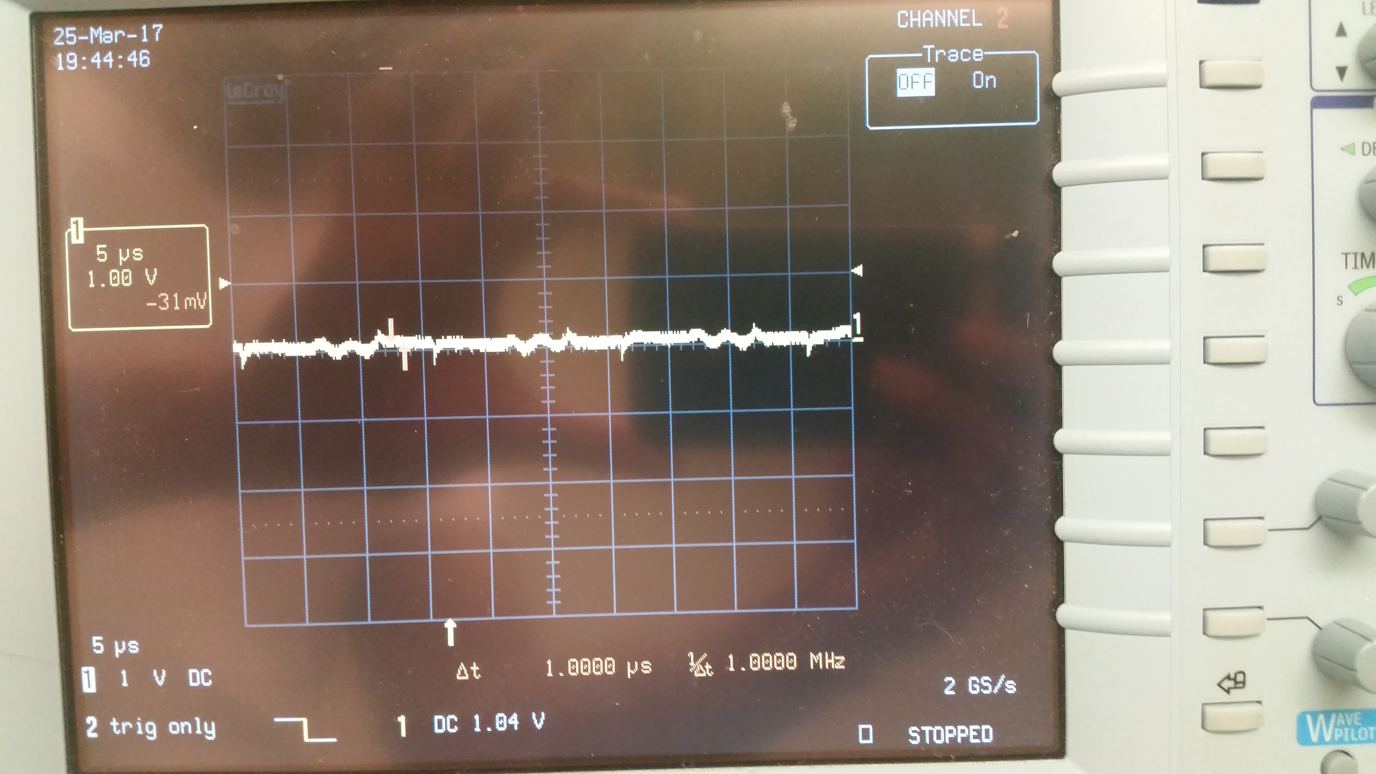

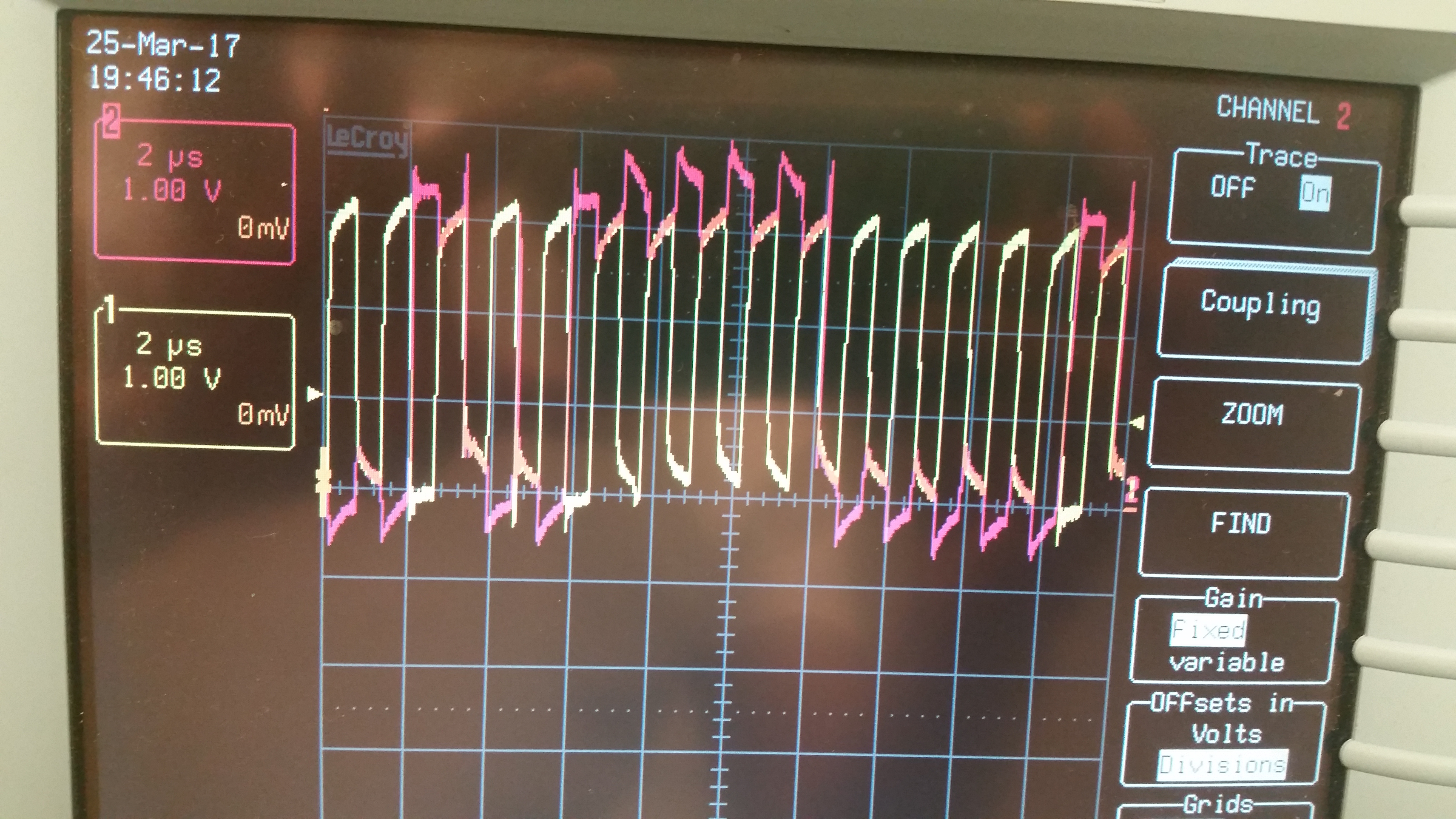

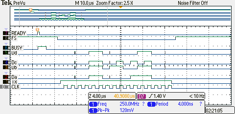

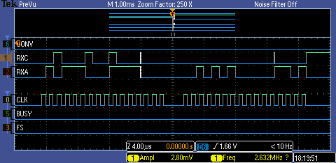

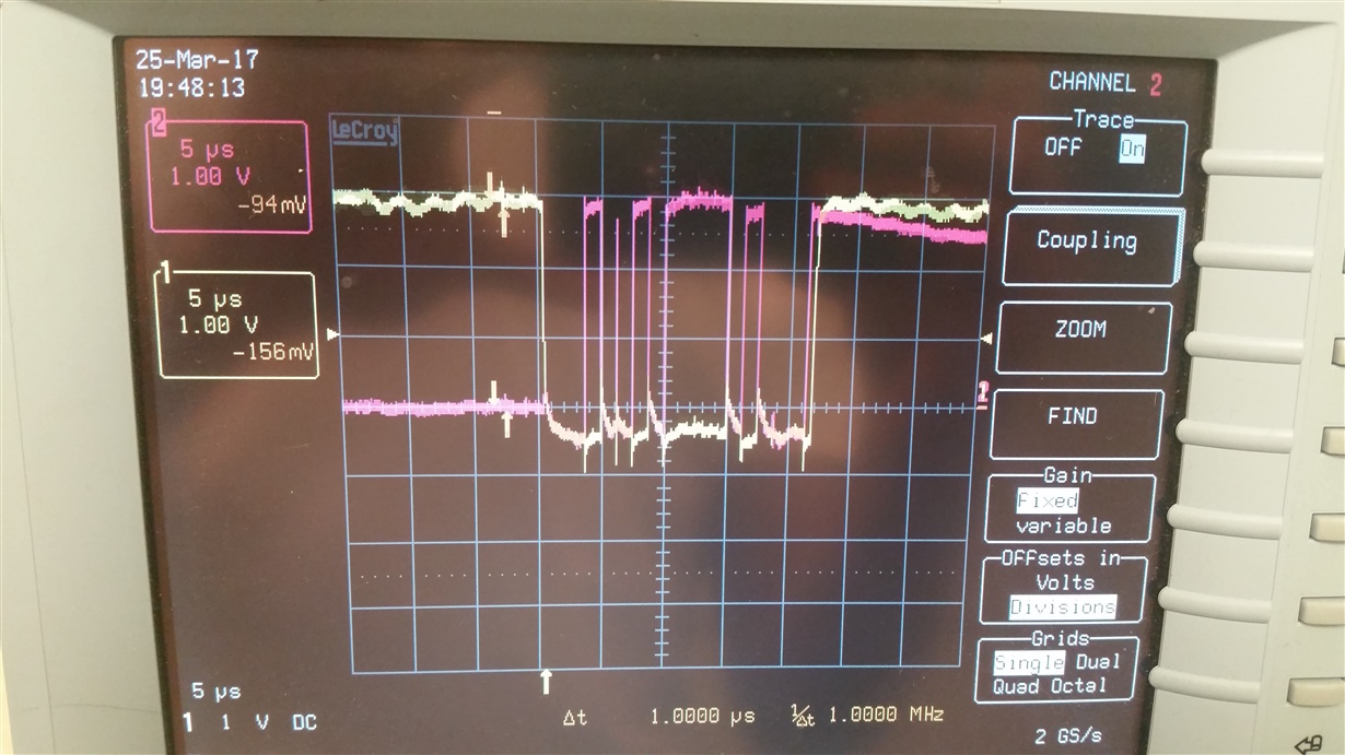

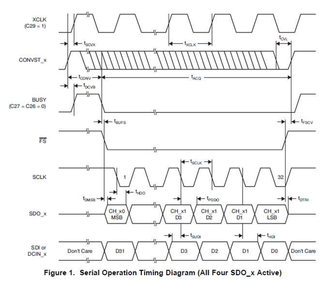

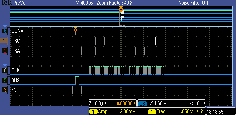

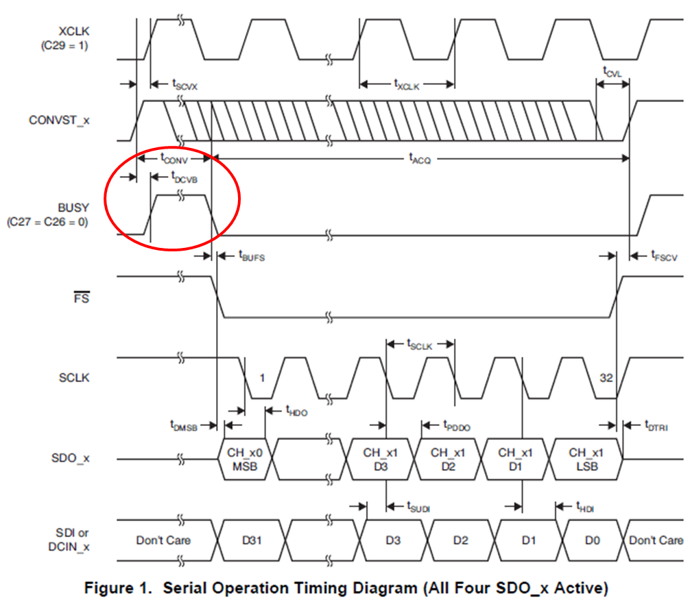

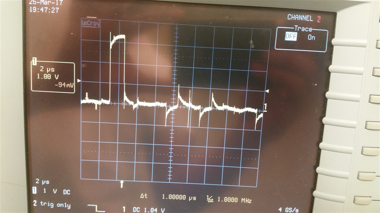

  • I hooked up my ADC8568 with an ammeter from my power supply (~5V). At the moment, I'm reading ~46mA while not doing any conversion (idle).
    So I think my ADC is at least working...
    Please see my code and schematic. I setup an Interrupt to read from the BUSY pin of ADC, and it goes HIGH by reading the Status register of uController.
    However, when I'm trying to read the output from Channel A, I'm reading 0. I'm reading from a potentiometer just as a test.
    To read from the ADC, I use GPIO pin that goes from HIGH to LOW when I'm about to read it, then it goes back HIGH again.
    Update and Additional info. I'm now using Hardware mode, TM4C123GH6PM microcontroller, and the schematic below represents my breakout board which is connected (jumper wired) to my microcontroller.

  • Hello Ian,
    Please correct your hardware connections and check the signals as below, and let me know the result.
    1. REFBN(Pin52)/ REFCN(Pin60)/ REFDN(Pin3) should be connected to Ground, REFBP(Pin50)/ REFCP(Pin63)/ REFDP(Pin6) should be connected to a decoupling capacitor individually.
    2.  Check if the /STBY signal on Pin 9 is high.
    3.  BUSY signal on Pin35 shown in below picture can be used to check if ADC is working. ADC starts a conversion when BUSY is going from low to high, and represents the end of conversion when BUSY is going from high to low.
    4. All timing parameter in below timing graph should be met, also It’s better to check them by a oscilloscope.
    Thanks.
    Best Regards
    Dale Li

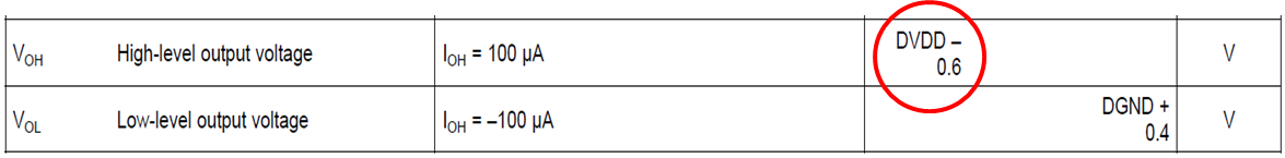

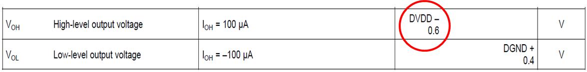

  • Hello Ian,
    For ADS8568's BUSY signal:
    1.   BUSY high voltage should be larger than DVDD-0.6V (see table as below), which means at least 2.7V if your DVDD is 3.3V.
    2.   Your BUSY high time(~15ns) is not correct, BUSY high time=tCONV- tDCVB, which should be 1.7us-25ns=1675ns for ADS8568.(see timing in above pic)
    so your ADC doesn't work well, please check your connections and timing.
    For SW mode, the default input range is determined by RANGE_A/B/C/D bit in Config register and will be 4Vref, which means +/-10V input,  the default internal reference voltage is 2.5V (Bit 13) but this internal reference is disabled as default status which is determined by REF_EN bit(bit 15) in Config register, you are using SW mode and Serial interface as you mentioned in your first post, so  you will have to connect REFEN Pin 11 to ground and HW/SW Pin 41 should be connected to high(DVDD) as well, also you will have to change and set this REF_EN bit(bit 15) in Config register to 1 to enable internal voltage reference after you power up the ADC if you don't have any external voltage reference.
    Please refer to attached file in the link for the conversion between code and input voltage.
    Sorry for late response.

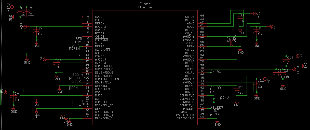

  • Hello Ian,
    Please keep your all questions in one E2E thread for same ADC, thanks. I'm confused because you mentioned your BUSY only goes up to ~500mV and then it goes down to 0V in your previous question, now you got around 3.3V after you checked, also I'm not sure if you have checked the connections for REFBN(Pin53)/ REFCN(Pin60)/ REFDN(Pin3),REFBP(Pin50)/ REFCP(Pin63)/ REFDP(Pin6) according to my suggestions.
    More questions to address the issue:
    1. Because you have changed from SW mode to HW mode, can you confirm if the schematic above is your latest connections? If yes, what's your signal connections on JP1 and JP2 connectors (High or Low)?
    2. When you check the code you got from ADC, what's your test signal on corresponding analog input? Please list your code and the signal you applied on related input, I can check for you.

  • Sorry for multiple threads. It wasn't my intention to confuse you.
    1.) I did add capacitors on Ref pins. Here's my new schematic:
    I did switch to TM4C1294 since I'm planning to use Quad SPI to read ADC outputs, but the connections still the same. (0=LOW, 1=HIGH)
    SER (1), STBY (1), RESET (0), REFEN (1), DCEN (0), SEL_B (1), SEL_C (1), RANGE (1), ASLEEP (0), HW (0)
    FS, SCLK, SDI are connected to my SPI master Fss, SLCK, and Tx respectively. CONV_A goes HIGH when I convert then switch to LOW.
    BUSY pin (input for my ucontroller) I check if I can start reading. SDOs are inputs as well, where I read ADC output.
    2.) When I did my test, I was reading from DC power supply with 2.062V, then what I receive is around 0x27e0.
    3.) Input circuit is just DC supply, but same thing happens if I read from potentiometer. For my sampling rate, I just put conversion and reading in a loop as a test, but it occurs even if I just convert-read it once.
    4.) For the scope images, I just checked single channel output for now. (Note: This is in HW so my SDI was connected to DGND when I did this test).
    Filenames show the description.

  • Hello Ian,
    Thanks for your information, but
    1. For you hardware connection:
    /REFBUFEN (Pin 20) should be connected to ground(GND) because you are using serial interface and hardware mode. No connection for this pin can be found from your current schematic.
    SDI (Pin 22) should be always connected to ground(GND) because you are using hardware mode, you mentioned you connected it to DGND when did the test, please just use one same ground(GND) and always connect it to GND.

    3. The screenshot from a scope I want is same as below timing(CONVST, SCLK, BUSY and one SDO in a same screenshot), which can be used to check if your ADC works correctly and also check the timing.

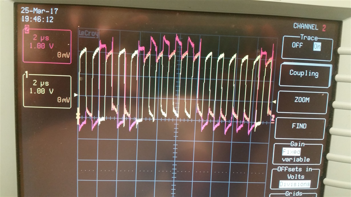

  • Ok, I finally got a mixed-signal oscilloscope. Hopefully this'll clear things up.
    1.) I put both SDI and REFBUFEN to GND.
    2.) I'm measuring voltage across a potentiometer. With 1.996V, I'm reading 0x0C38. See the the diagram below.
    3.) I've also checked the timing.
    t_conv = 1.6240us
    t_dcvb = 16ns
    t_bufs = 1.924us
    t_acq = 19.58us
    t_sclk = 1.260us
    Hopefully these measurements are helpful. I'll check on other measurements if still needed.
    Thanks for your immediate help,
    Ian
  • Hello Ian,
    From the timing parameters you measured, they can meet the specifications in ADS8568's datasheet,  the ADC is working, but the code you got is not correct (the input voltage for code 0x0C38 is about 0.48V for 2Vref range), so the data capturing is not correct. You are using all serial data output pins SDO_A, SDO_B, SDO_C, and SDO_D, every pin needs 32 clocks to output the data for every channel pair, the time to transfer 32-bit data for every output pin is 1.26x16x2 = 40.32us, which is greater than tacq time 19.58us, so you need to increase your SCLK frequency, also when you capture the data on SDO_x at the falling edge of SCLK, your CPU should finish data retrieving in 5ns (tHDO) after falling edge of SCLK, please refer to the tHDO in the timing as below, please check. Thanks.
    Dale Li
  • Pardon me. It seems like I didn't attach the image file.
    As you can see below, I just ran 16 clock cycles. So I believe just from that, I should be able to retrieve CH_A0, CH_B0, CH_C0, CH_D0. And my t_acq seems to make sense if I just have 16 clock cycles, which is half of 40.32us.
    Also, do you suggest for me to increase the SCLK frequency? At what minimum speed should I configure my microcontroller to retrieve within 5ns. I could post a new data snapshot with 32 clock cycles. I've tested it, but the problem didn't go away.
  • Hello Ian,
    Thanks for your update. Increasing sampling rate just guarantees that you can get all channel pair data, and it can't guarantee 5ns timing which depends on your CPU, please check tHDO in your real timing. Another thing I mentioned in previous post, even you are measuring DC signal, a proper front-end charge bucket filter is necessary to provide the charge to internal sampling capacitor during acquisition time, also it's better to have a amplifier buffer to drive this ADC, please refer to this blog and see the detail:
    e2e.ti.com/.../settling-time-challenge-and-improvement-tips
    One more thing, I'm not sure why the signals' amplitude in your screenshot is so small, which was also mentioned in your previous question, is this true signal amplitude or caused by scope's probe? thanks.
    Thanks&regards
    Dale
  • I'm positive that the signal amplitude is due to the threshold that I set with my oscilloscope. I still have to look into the charge bucket filter and the amplifier buffer, but at the moment I"m currently reading relatively good results.

  • Hi Ian,
    What you mentioned for half reading is caused by your timing, which means your CPU missed capturing 1-bit, please check your timing to make sure the parameters are correct compared with Figure 1, especially tHDO I suggested you to check before.

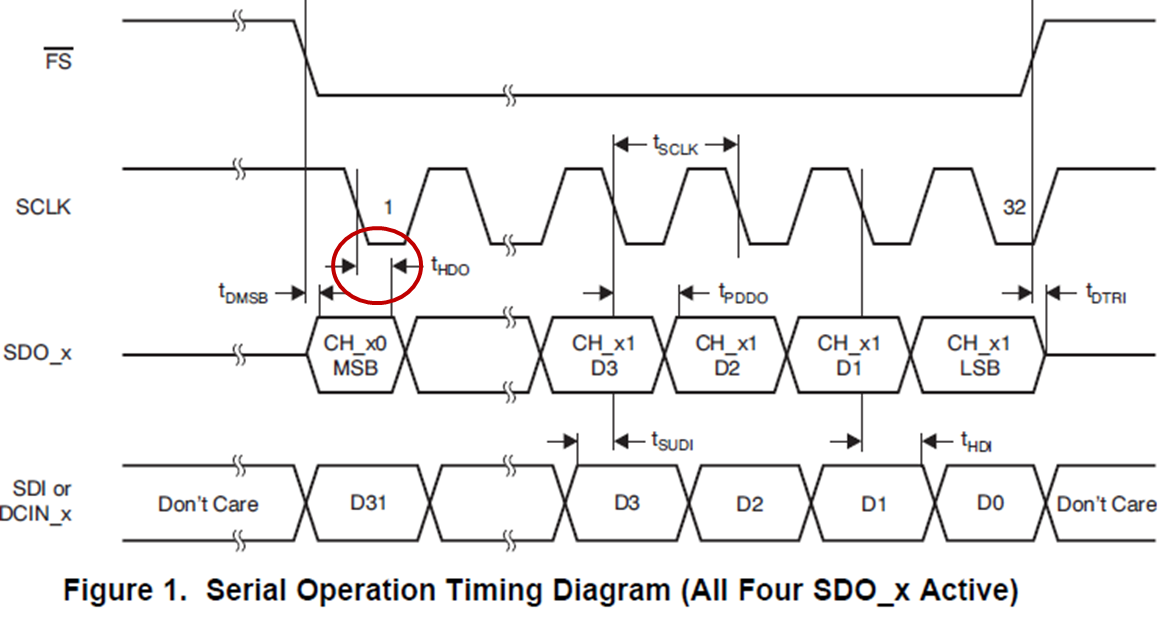

  • Hi Dale,
    It turns out I'm missing 1-bit, just as you thought. I checked it with my logic analyzer, and so changed my code a bit to read on first clock edge.
    For the Daisy chain Configuration, what could be possible causes for
    1.) the ADCs to sample incorrectly?
    2.) for the data gets altered in the daisy chain. For example, 1001 0001 becomes 1011 0001?
    3.) the entire 16-bit to get left-shifted incorrectly by 2? For example, we looked at the output at ADC 3 and compare it to the output at the first ADC. The same data is there, but it''s at the wrong position.
    Please see our updated schematic. We have 4 ADCs daisy chained together. The very top image is ADC4, and below that is ADC1 where the output is connected to the microcontroller.
    We moved out to PCB level. One note that our designer didn't take into consideration was a net connection for the BUSY/INT pin to the microcontroller. But we put a long delay between CONV and FS.
    Thanks a lot

  • Hi Dale,
    Please help. I need assistance to move forward.
    I'm attaching new images of why I think my data gets corrupted. Somehow there are "glitches" in my data stream that affect my data. The white bold lines that goes down and up almost immediately are actual data, and it shifts the rest of the data. Do you know what causes it?
    I'd really appreciate your help.
    Ian
  • Ian,
    It's hard to see the detail because the picture is too small, also I would like to see entire schematic because it's hard to see your connections only form part of schematic, even I can't find RXC and RXA.
    I don't fully understand "left-shifted incorrectly by 2" you mentioned, "1001 0001 becomes 1011 0001" is not left-shifted, please explain.
    Please let me know what input signal is used for your test and what's the code you got, timing is preferred.
    One more question, are you using +5V power supply to HVDD and -5V to HVSS?
    Thanks&Regards
