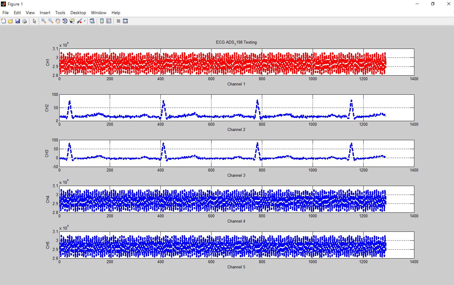

    I want to show channel via serial comport to MATLAB, but I got strange wave form like below picture.
    I just show 5 channel firstly, channel 1,4,5 is odd( but i do make this channel in Normal electrode mode ), channel 2,3 seems correct ?
    but not sure. So it is very confuse me why channel 2,3 seems can get data fine, but other can't.

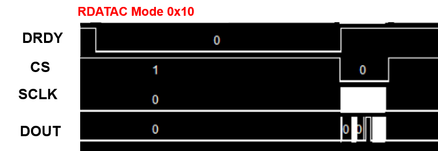

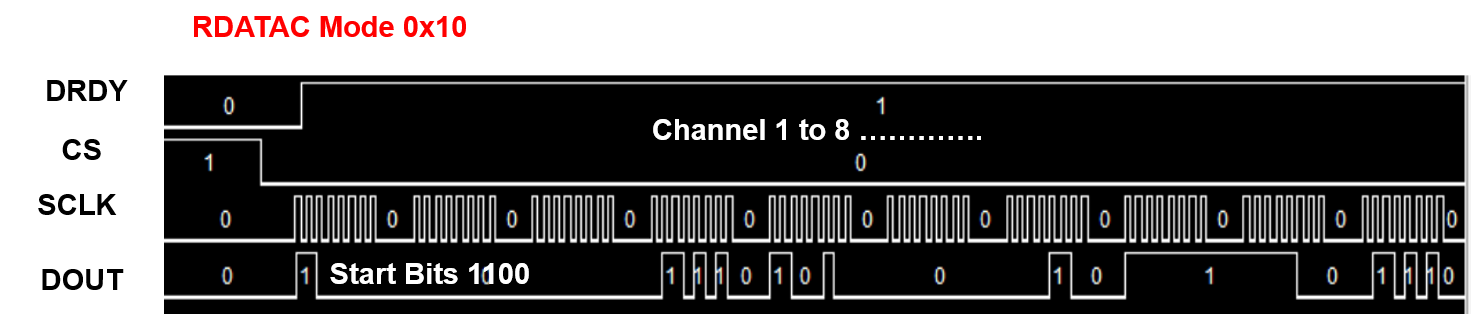

    I put ads1198 in RDATAC Mode (0x10), and I check its wave form with Agilent logic analyzer, seems correct
    I am sure I convert every channel 16bits data (in 2's complement binary) to decimal value and plot it in MATLAB.
    The way I deal with 16 bits data in Matlab
    s=serial('COM9','BaudRate',115200); % setup comport  fopen(s);  % Open comport
    T1=fread(s,1); //Get channel first  byte
    T2=fread(s,1); //Get channel second byte
    ch_1=T1*256+T2;//make it 16bits
    change2dec=dec2bin(ch_1,16);
    value_ch1 = twos2dec(change2dec);

    2.Q: When DRDY pin goes low, is its time sometime long or short? Cuz in logic analyzer sometime I saw DRDY pin in low longer but sometime shorter  (may be a issue? just guess)

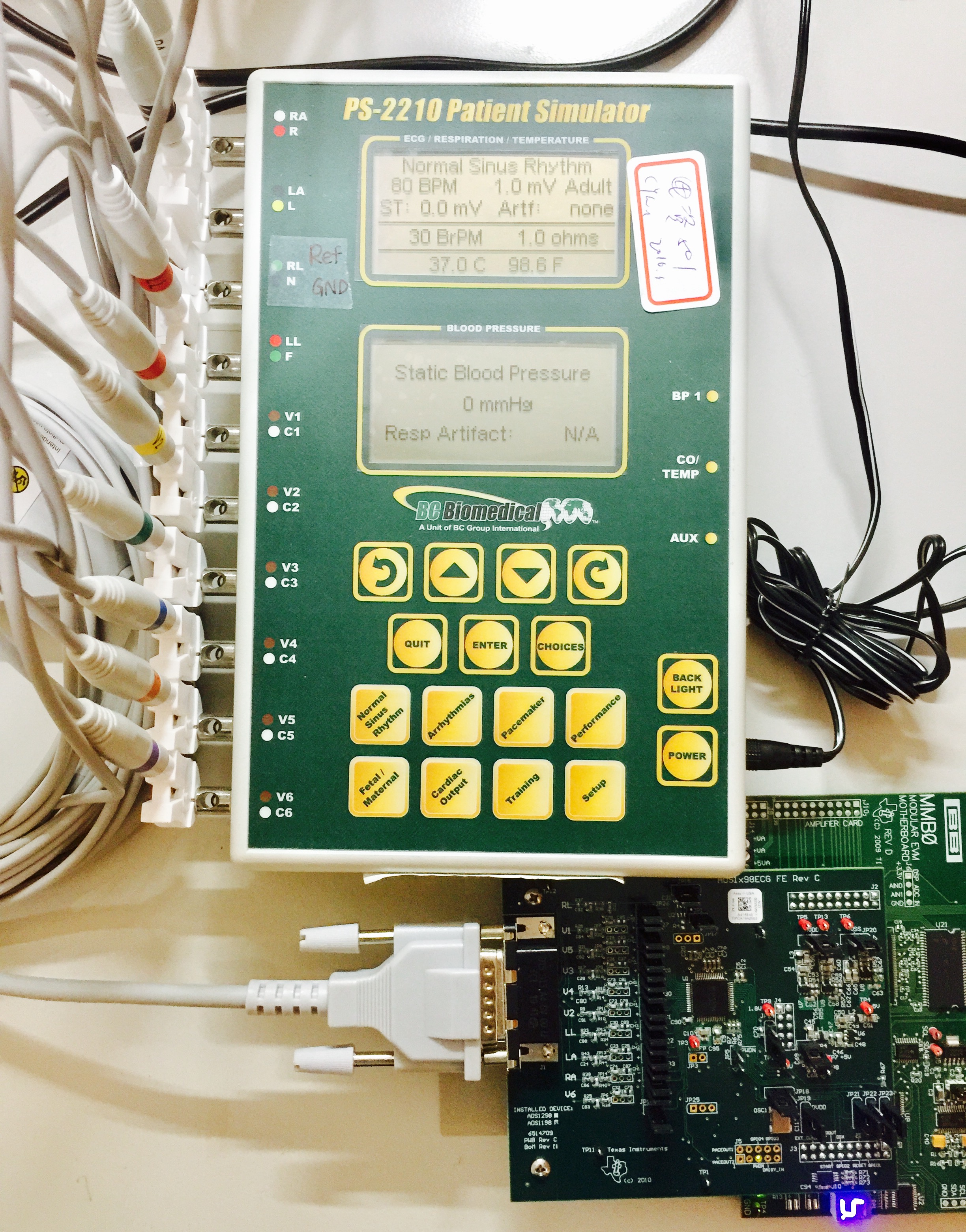

     And this is environment I used:  ECG Simulator , D15 cable, 60-80BPM, 1mV
    Can one guide me what's problem for me to get data this result? how to fix it ?
