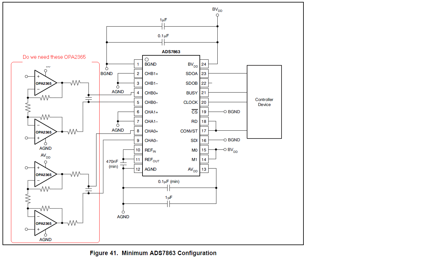

We have a signal which is received from our Rx filter and output is within the expected range. Do we have to pass our signal through OMAP2365. Note we are using ADS7863 in pseudo differential mode in 3:1 configuration.

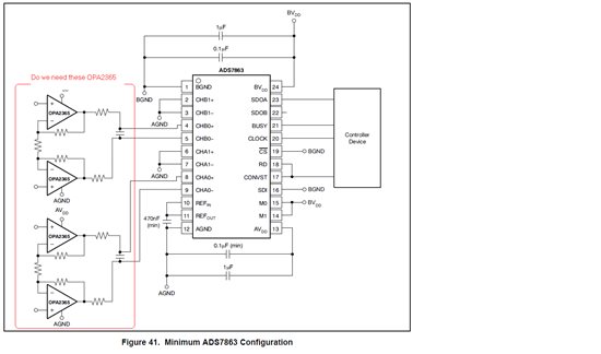

Sanjay,
Figure 41 shows the basic differential setup. You would not need this configuration when running in pseudo differential mode, but I would recommend that you use a buffer and R/C in front of each input channel.
