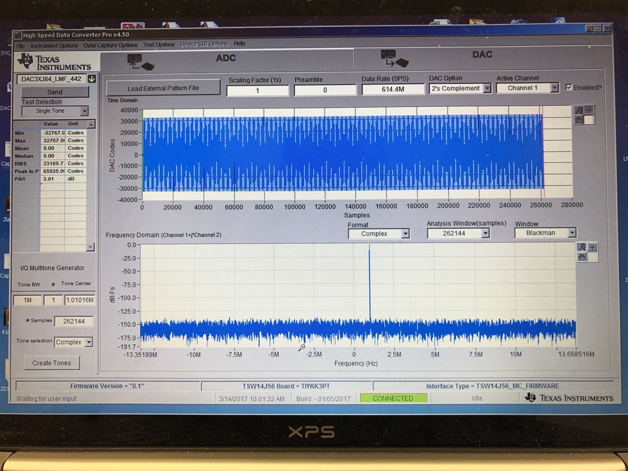

However, we are now checking some results with single tones and noticing some distortion products higher than we'd like (-55 dBc) for single tone up-conversions.  For example, if I have a single sideband at approximately 1 MHz (generated using HSDCpro.  I get some spurious as shown in the attached picture.
The setup for this case is: coarse mixer at fs/4 using internal clock and internal data rate at 614.4 MHz with a DAC clock of 2457.6 MHz.
I believe this may have something to do with the way the math is done when multiplying two 16 bit numbers while only having a 16 bit output.  I guess my question is this just an inherent problem with trying to use the part in this way, or am I missing some trick?  Thanks in advance,  Dan Van Winkle

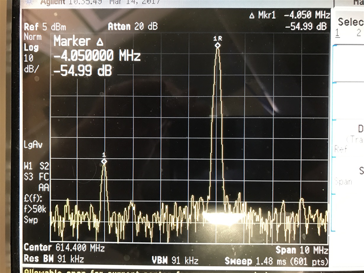

this produces an output spectrum at 614.4 MHz of:
  • Hi Dan,
    When you change the 1R frequency by 100 kHz (ie use 1.1MHz) where does tone at 1 marker go?  I'm trying to see if there is some correlation to a mixing harmonic.

  • Hi Ken,
    If I move the frequency to 2 MHz, the spur moves to 8 MHz away.  Moving it to 1.1 MHz the spur moves 4.4 MHz away (3.3 MHz below the NCO).

  • Dan,
    What you are seeing is the 3rd harmonic distortion folding back along Fs/2.  The typical SFDR performance and HD3 performance is outlined in the datasheet page 15/16.  You can also see this if you use the NCO and sweep the output frequency from 100MHz to 600MHz.
    You will see the HD3 component move up in the Nyquist zone until it hits the Fs/2.  In this case that would be with Fout=409.6MHz, HD3=1.2288GHz.  As you continue to increase the Fout, the HD3 will decrease from Fs/2.
    In your case as you increase the Fout=615.4MHz, the HD3 will be at 3x615.4M=1846.2M
    This will fold back in the 1st Nyquist at Fs/2-(HD3-Fs/2)=1228.8-(1846.2-1228.8)=611.4M
    The level of this HD3 harmonic is not shown on the data sheet for >500MHz output tone, however your measurements of around 55-60dBc seems to be in the expected range.
    If you need better SFDR at this output frequency, you may need to do some frequency planning to avoid the HD3.
