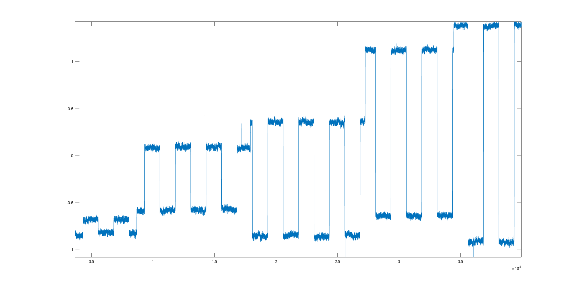

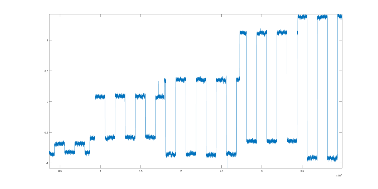

  • Hi Brian,
    we kept TESTN set to 1.64V and tried incremental steps of 0.001V on TESTP (1.641V, 1.642, etc.), even though the EN normative only requires 1mV. The common-mode voltage of 1.64V did come from the same source. As you can see from the image here below, we noticed a particular behaviour when increasing the step (square wave) signal amplitude:
    1. The lower level is shifting depending on the signal amplitude (notice the difference between 1mV and 2mV)
    2. The increase of amplitude is not proportional/linear (again, notice the huge difference between 1mV and 2mV)
    Because of this behaviour, it seems the calibration process cannot be consistent. By following the EN normative, a step signal of 1mV should allow us to calibrate the system. Thus, we were able to define a calibration parameter ratio, which in this case was 7.7279 (see table below).
    Since we know the amplitude if the other step signals, we tried to confirm the calculated calibration parameter ratio. However, when using that parameter on other amplitudes the relationship is not valid. For instance:
    0.6786 [mV] * 7.7279 = 4.45 mV  (should be 2mV though)
    Would you say this is a normal behaviour for the ADS1298 or we are making something wrong?
    Thank you very much for any help you can give us.

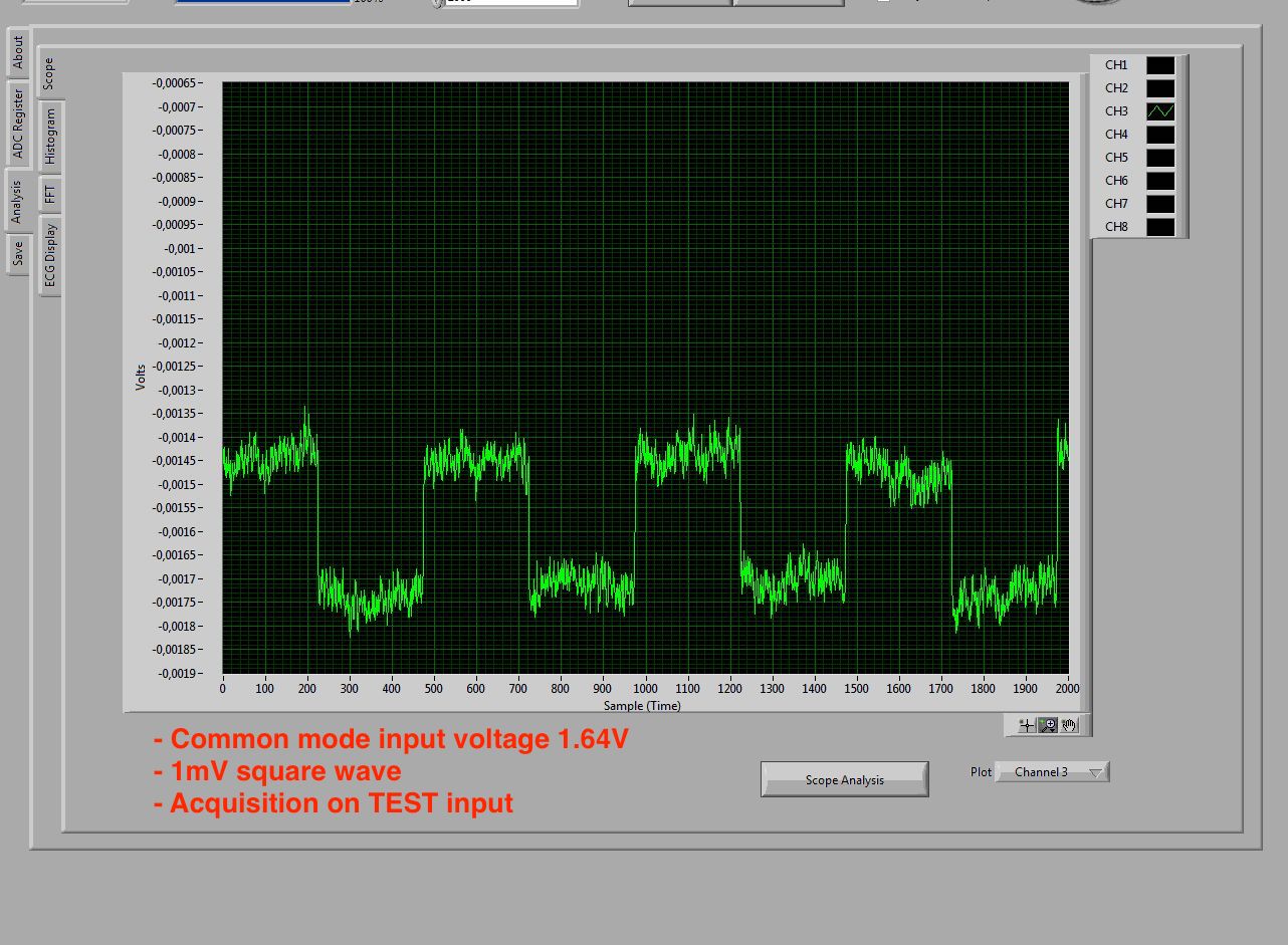

  • Hi Brian,
    what we want to do is a calibration of the whole system. Actually, we are assuming the error could be given by different errors and not only by the gain. Anyway, in order to be completely sure about our setup, we made an additional test using the ADS1298 dev board. All the GND lines has been tied together carefully.

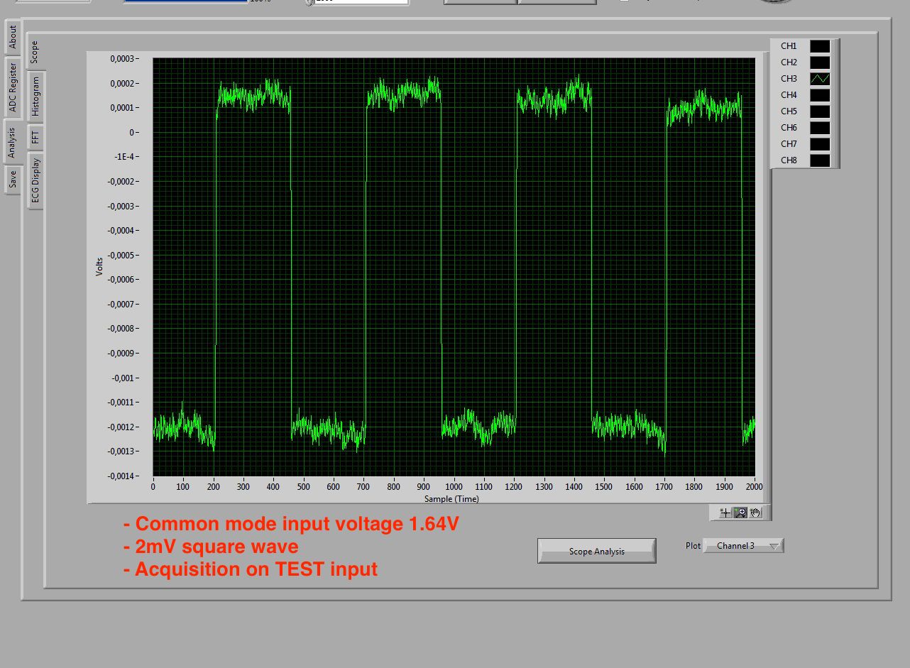

    When we apply a 1mV square (common mode input voltage of 1.64V) on TESTP, what we see is a square wave of 0.3mV (see image below). If we apply a 2mV square wave, what we see is a square wave of 1.3mV (see image below). If apply a 3mV square wave, we got a square wave of 2.4mV.
    Anyway, because the EN normative specifically requires a 1mV (step) signal to calibrate the system, we can define the following parameter to calibrate the system:
    1 [mV] / 0.3 [mV] = 3.33

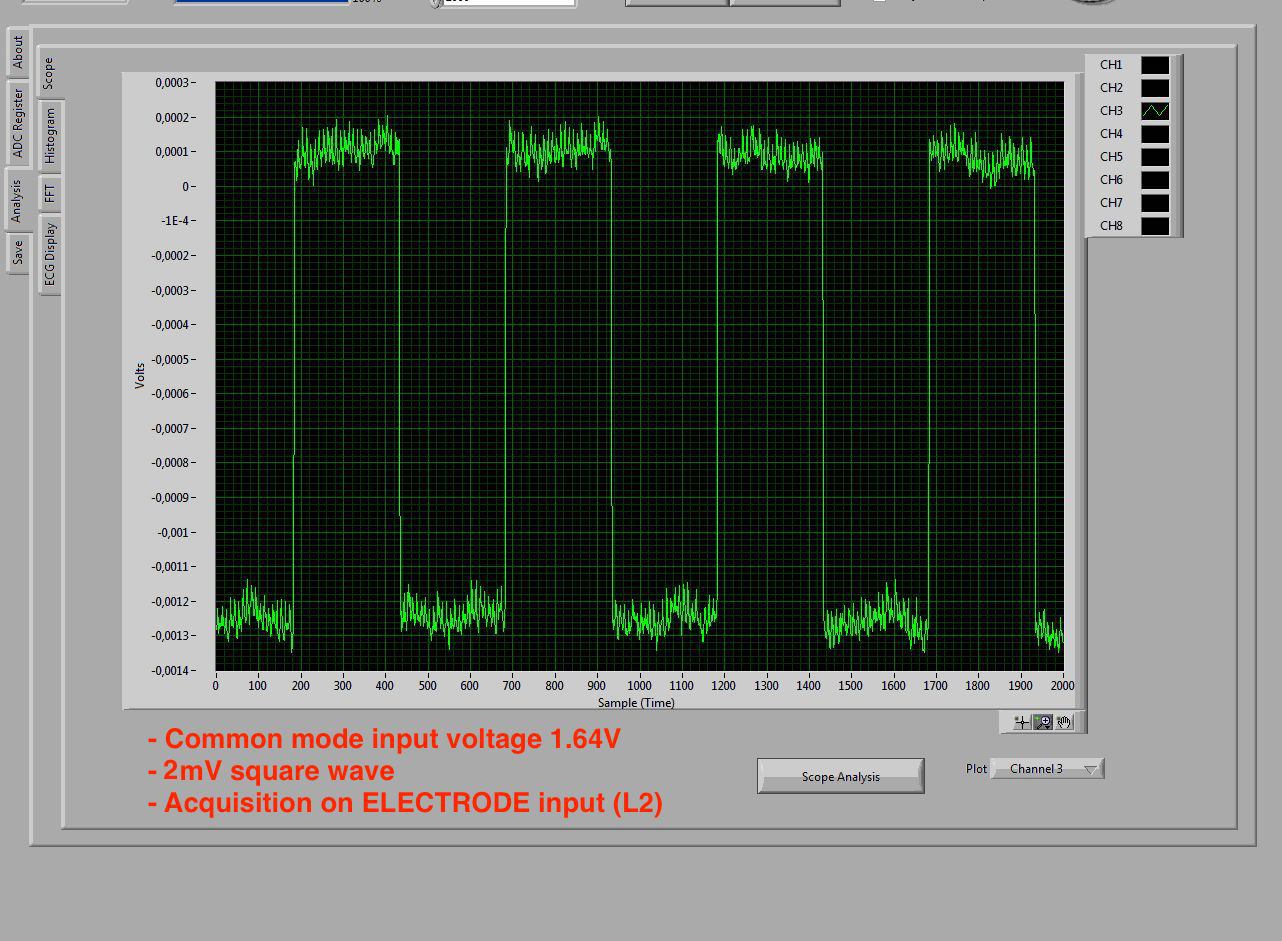

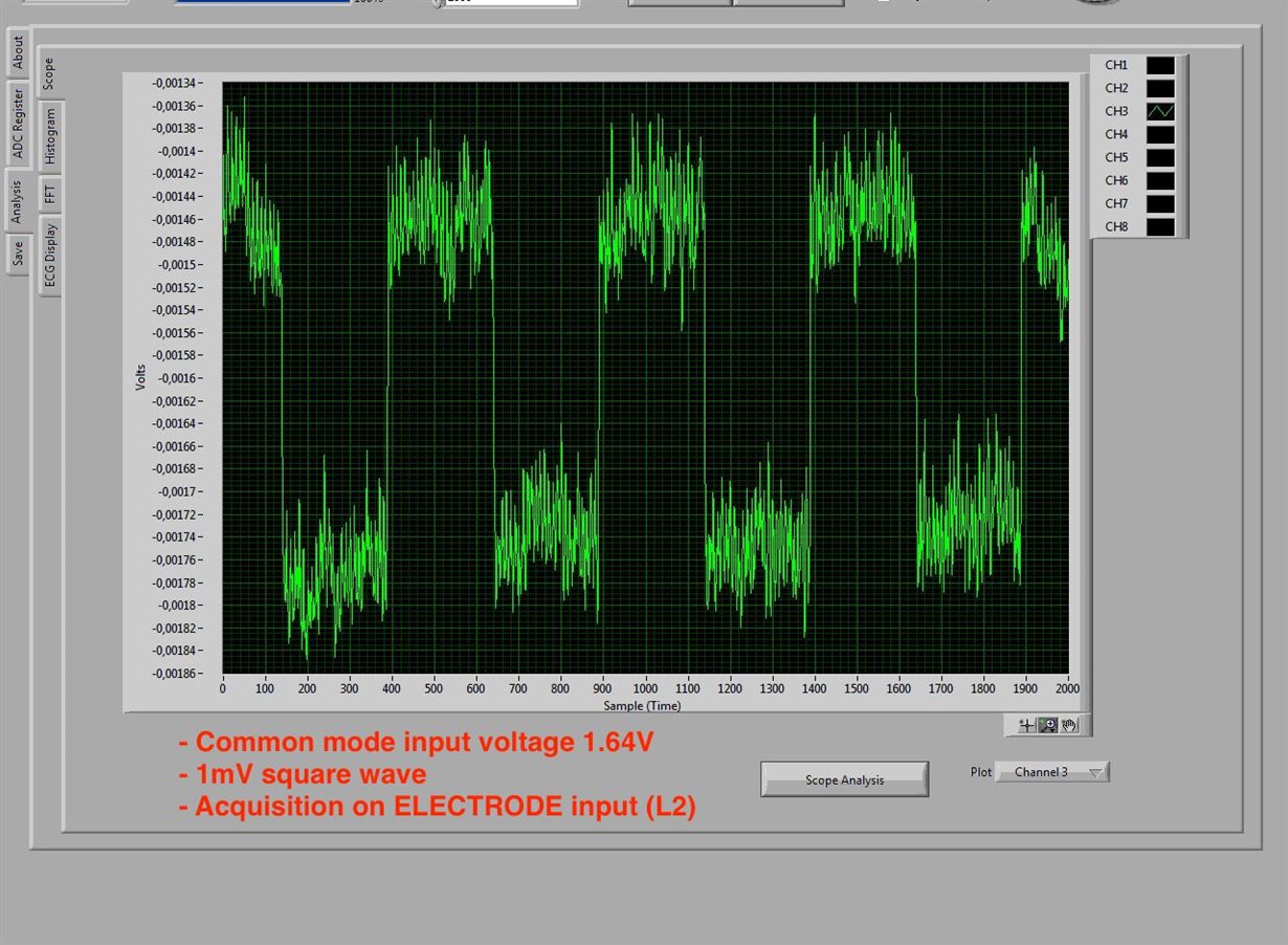

    In order to test the system and the calibration, we then tried to apply a 1mV square wave signal (still with a common mode input voltage of 1.64V) as an input to L2 lead (channel 3).
    What we see is a signal of around 0.29mV (see image below). So, 0.29 [mV] * 3.33 = 0,96mV, which is reasonable. When doing the same with a 2mV signal at the input channel, what we acquire is a signal of around 1.35mV (see image below). So, if we use the same calibration parameter: 1.35 [mV] * 3.33 = 4,49mV, which is of course wrong. By increasing the amplitude values (e.g. 3mV), the error increases.
    We might be wrong, but the system cannot be calibrated in this way because it is not stable. What is your opinion? Do you have any suggestion? Is there any existing application that uses a similar external calibration?
