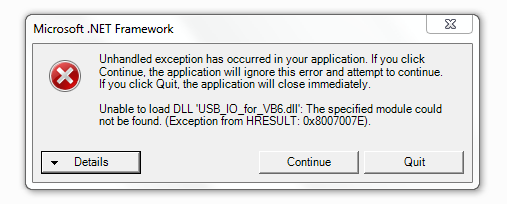

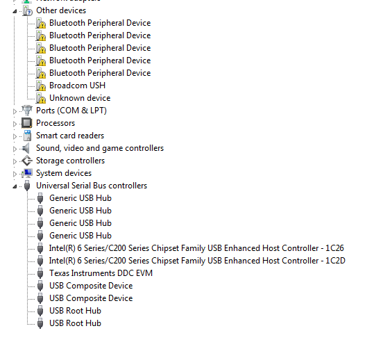

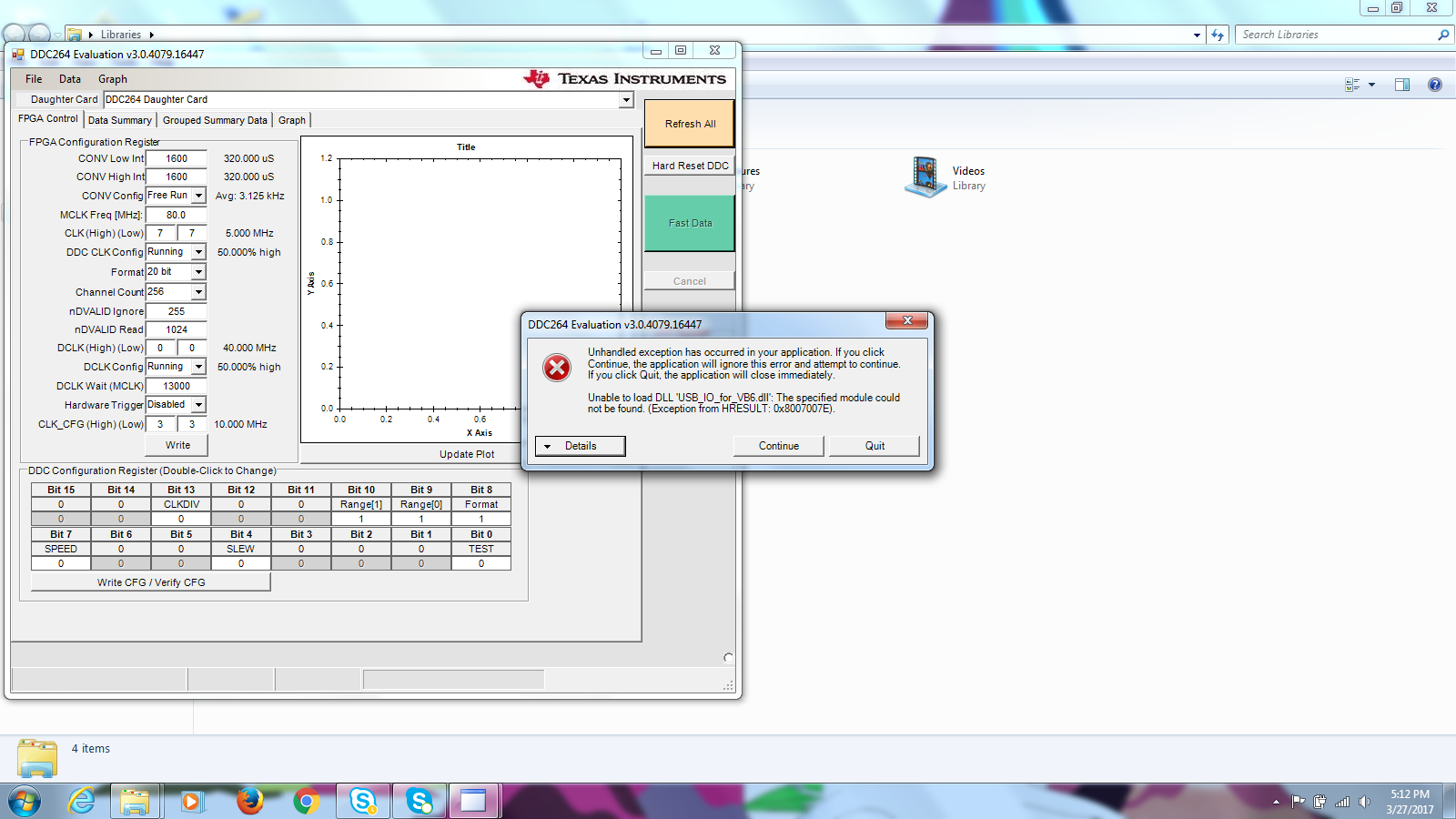

I have an issue with DDC264EVM communication with Win7 dell laptop. Like the RandL answred for " DDC264 EVM Windows 7 64 install", did exactly same for my DDC264EVM installation, but I am getting few errors like the below shown screen shots
I have copied USB_IO_for_VB6.dll in below folder as it is installed
 C:\Users\kbharatha\AppData\Local\Apps\2.0\Data\HJWROHR7.9MB\G6XVCTYR.66H\ddc2..tion_f0cdf37a7314ad51_0001.0000_d0b9ccfc9e64bcde\Data
I have . net framework 4.5 version installed
What could be the problem in connection I did't understand. The same Eval board is communicated with WinXP system successfully.
Please help in resolving this problem with Windows 7 laptop.

  • I resolved the issue by copying the "USB_IO_for_VB6.dll" file in the below path as well
    C:\Users\kbharatha\AppData\Local\Apps\2.0\8YHN5517.KDB\2Z9QMGOY.B9D\ddc2..tion_f0cdf37a7314ad51_0001.0000_d0b9ccfc9e64bcde.
    I reconfirmed the DDC264EVM communication problem by deleting  "USB_IO_for_VB6.dll" file from the above location.
    Now the board communicating successfully and refreshed the configuration and generated sample file.
