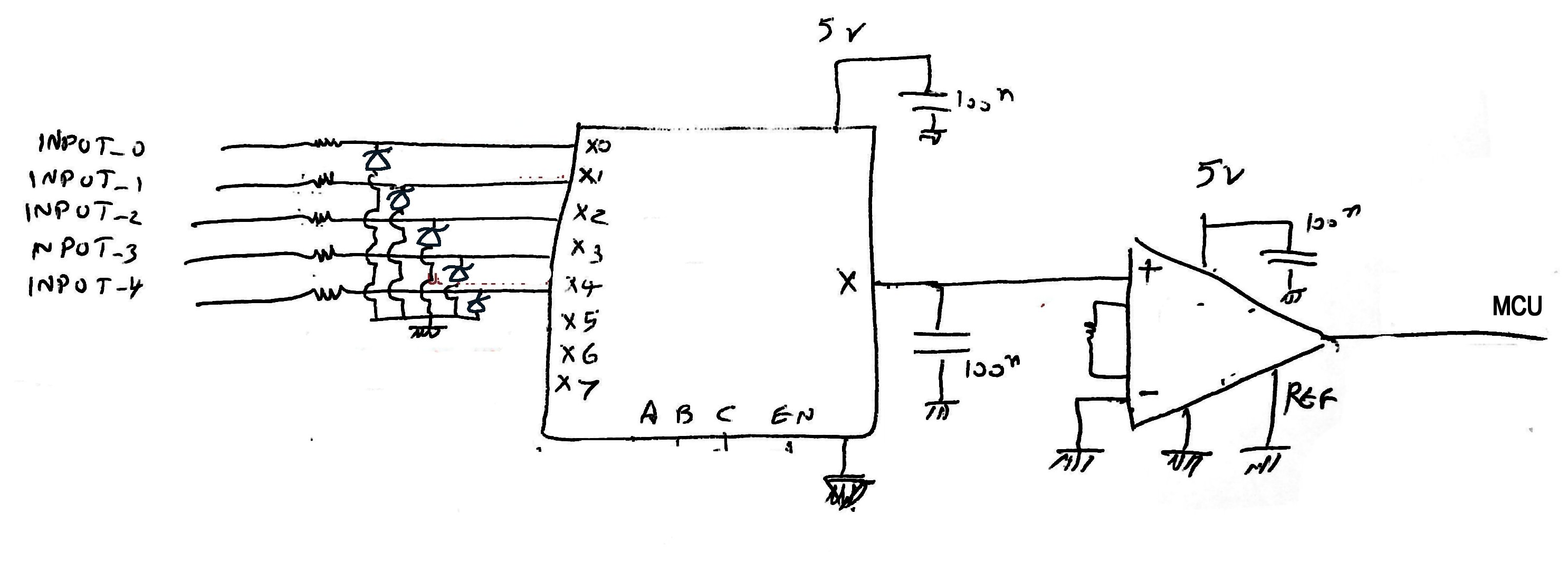

I need to get some additional analog inputs to the microcontroller. These signals are very slow (1 sample per second is enough), 12-bit res is just ok. They are also nicely in range, and required gain would be 1. However, protection (esd/ overvoltage) needs to be there.
Now, which approach is better?
1. A series 10k resistor, then tvs, then RLC filter, then clamping diodes, then directly to ADC?
2. Doing it half externally. A 10k resistor and tvs for each channel, then multiplexer (which selects these channels instead of mcu), then RC filter, then instrumentation amplifier (Where V- and Vref is ground anyways), and then going to ADC.
Is 2 simply overkill, and does not offer any extra protection?
Would 2 provide more isolation maybe? If so, what would be a recommended design?
Having channels directly on MCU is certainly more convenient software-wise, but I wonder if the mcu may get damaged because of not doing the right thing.
If using INA, this is how I am depicting it.

  • Michael,
    The input protection that you choose might depend on the application and what problems might come up with the protection.
    In the products that I support, we often make measurements of voltages coming from resistive elements, and comparing that to a voltage from a reference resistor. Since both the resistive element and reference resistor are driven by the same current, we can make precision measurements. However, if there are any leakage currents, they become errors in the measurement.
    Because of this, TVS diodes are generally not used. With TVS diodes, the leakage currents are rather large and adds significant error.
    I've seen a combination of series resistance and Schottky diodes that shunt current to either to positive supply or ground to protect against overvoltage events. I think BAV99 diodes have been popular because of the low leakage. As an example, I've shown how it's connected below.
    I'd note that the series resistance for these oversampled ADC generally shouldn't be larger than 10k. Since the inputs are sampled much faster than the data rate, you might get other errors from the measurement with large series resistances.
    This might not give the level of protection that you need, but it does suit many applications. Your application might have different requirements, so you might want to post more about what your application is and what it requires for protection.
