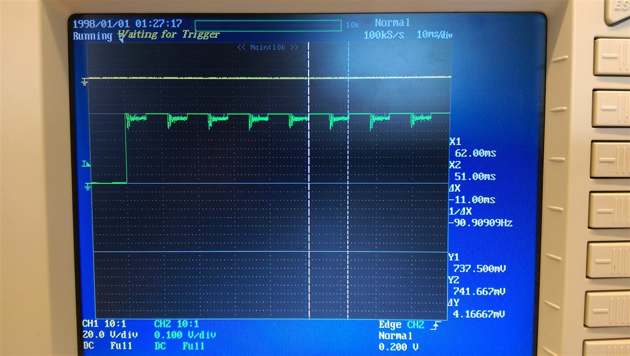

    thanks for your supply. I used the new config file but I get the same result. I only get with testmode constant K28.5 a stable SYNC Signal. I measured the to FPGA clock on capacitor C79 with a oscilloscope. It´s about 125 MHz so looks ok. I also measured the SYSREF signal on resistor R38. This looks strange and I am not sure if it´s "normal". See here:
    Maybe the SYSREF signal from the LMK04828 is the problem?
    Tobias

  • Tobias,
    The GUI is fine as long as you only use the provided configuration files. Are you using the TSW14J56EVM to test this board? The SYSREF signal is turned off by the configuration file after the ADC has been configured. That is why you are seeing this. Please send me the two configuration files you are loading the TSW54J60 with. Do you press the reset button on the TSW54J60EVM after loading the LMK config file and before loading the ADC config file?
    Jim

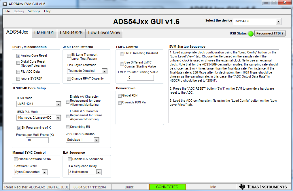

    thank you for your post. I know that the GUI runs with the configuration files. I use the ADS54J60_LMF_4244.cfg file and a modified version where I set the register 0x690002 to 0x40 to enable K28.5 pattern. So its a litte circular to use for every setting a seperate config file. I still use the same FPGA as desribed to you above.I always press the reset button on the TSW54J60EVM after loading the LMK config file before loading the ADC config file. Here are the two configuration files I load to the TSW54J60EVM:2477.ADS54J60_LMF_4244.cfgLMK_Config_Onboard_122p88_MSPS.cfg
    Tobias

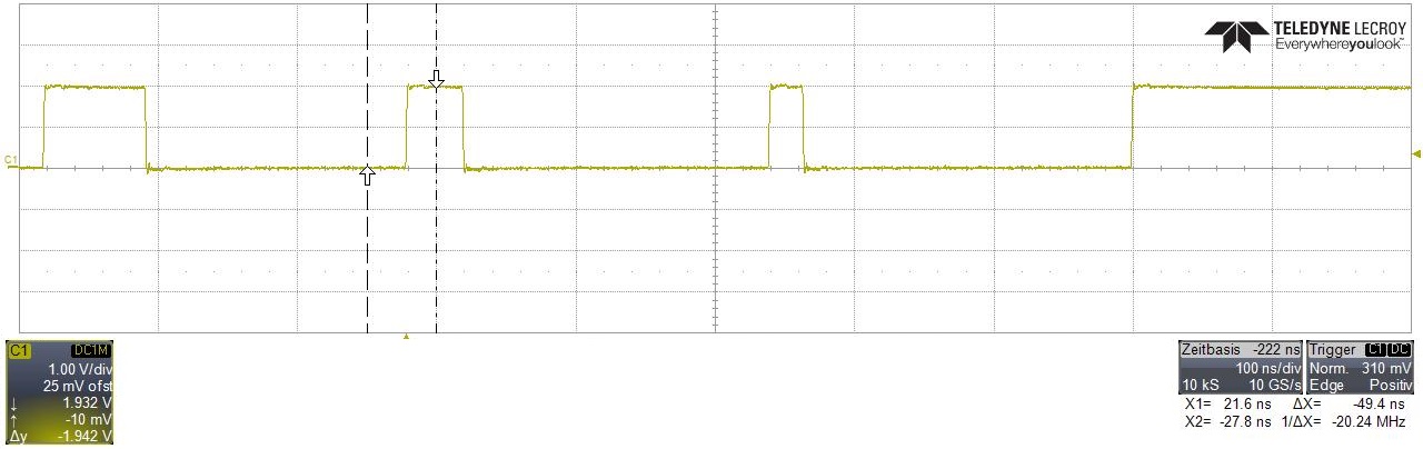

    I use the differential SYNC at pin G12 and G13 on the FMC which goes to the SN65LVDS4. I didn´t change the SJP3 SYNC_SEL so if I measure at pin 2 of SJP3 SYNC_SEL it looks like this:
    As you can see there is a SYNC signal on pin 2 of SJP3 SYNC_SEL which is connected to the SYNC pin of the ADS54J60. So the ADC musst get the SYNC from FPGA. The high time of the SYNC is variable but sometimes it is about 200 ns like the last one in the picture.
    The power supply I use can deliver 5 A. After I load the LMK04828 config file the PLL lock2 LED is on and I do the ADC reset before I load the ADS54J60 config file. Here are both config files I use:
    7142.ADS54J60_LMF_4244.cfg 5584.LMK_Config_Onboard_122p88_MSPS.cfg
    I hope this infos can help you.
    Tobias
