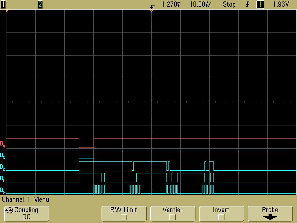

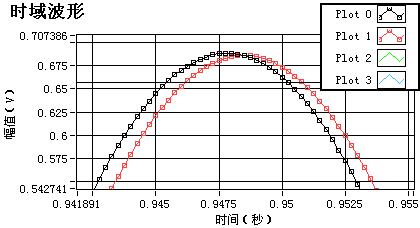

Two ADS1282s don't synchronized.Figure 1 shows that channel 2(red) is delayed than Channel 1(white).On the oscillograph,Figure 2
shows that the DRDYn was coinstantaneous,but the data from two ADS1282 per samping were not same.On my PCB,the two ADS1282s' SYNC
pin was connected.And I take the SYNC pins low and then high to synchronize the two ADS1282s before collecting the output data.So
where the problem lies?
  • Figure 2
    from up to down there are:DRDY2, DRDY1, Dout2, Dout1, SCLK

    Offhand, I'm not sure of anything that could cause the behavior you describe. It almost appears that the delay is almost three tdata long from device to device. I will note that the ADS1282 is a fairly complicated part so I'll need a lot more information
    First, with respect to Figure 1, you have two curves showing signals that are offset in time.
    1. Is this the measurement from the ADC for the two devices?
    2. What is the input source that you are measuring?
    3. What is the input frequency?
    4. How is the ADS1282 configured (gain, data rate, everything)?
    5. Do you have the raw data (hex code) that comes out of the ADC? If the codes are converted to voltage, there might be some conversion error and I like to read through the data directly from the ADC.
    6. Have you changed the input to something different? Different magnitudes, frequencies or even using a DC signal migh show something.
    Second, Figure 2 shows the DRDYn signal and then the clocking out of data. It looks like the DRDYn signals are aligned together so that the devices are some how synchronized, even if the data appears to be offset in time as in Figure 1. I still had a few questions though.
    1. Have you tried measuring the input voltage with the scope to see if there really is some sort of lag between the two signals.
    2. If I read the data correctly, it looks like the first ADC reads FFDFA027h and the second ADC reads FD079005h. If the reference is 5V, then the full scale is +/-2.5V and this data corresponds to approximately -2.5mV for the first and -58mV for the second. This roughly corresponds to what you show in Figure 1, but I might be nice to see a few more scope shots to see if that is real.

    About Figure1:
    Yes,the Data is from the Dout pin(pin 4) of ADS1282s.
    The input is from Agilent Waveform Generator 33220A.The inputs of the two ADS1282s is the same(connected).
    20Hz,1400mVpp
    CONFIG0  "01100010" that means 4000SPS others config is default
    CONFIG1  "00001000" all default
    HPF,OFC,FSC all default
    didn't calibration(OFC and FSC registers keep default)
    I read through the data directly from the ADC
    I tried several sine waveform.The delay always existed.Otherwise,I tried DC sigenal and the waveform is Figure 3.A almost stable error between the two ADS1282.But obviously this stable error can not cause delay.
    You are right.I'll show you a more full scope shot(Figure 4).

    1.comparing the waveform of 1000SPS and 4000SPS.I find out that the delay between the two ADS1282s is a constant,about 0.6ms.

    One thought that I had was that this might be a problem related to the filter in the ADS1282. Since there are many adjustable parts to the filter, it might create a different response to the measurement if the filters are not set to exactly the same thing.
    For example, the ADS1282 has a high-pass filter stage. If you look at Figures 50 and 51, you can see the gain and the phase response. At 20Hz this filter has some small phase delay and some small attenuation (as you see in your plots). This HPF stage can be used or bypassed. One thing to check is to vary the frequency and see if the phase delay gets worse at 1Hz inputs or if it goes away a 100Hz inputs. You can plot those inputs and see if the plots match up or get better with the change with frequency.

    One other possibility would be external filter mismatches. If you have some sort of capacitive input filtering, the mismatches of the input capacitance or resistances may create a difference in the phase delay depending on the values.
    You can also see this if you vary your input frequency.
    Joseph Wu
  • Hi,Wu
    First of all,Thank you for your help.I'm very puzzled that I find the delay disappeared after I have reconnected the signal input wire.So I guess I had make a mistake in the connecting of signal input. In the origin one,the sig- of the two channel was connected to two GND separately.In the last one,the two sig- were connected together to one GND. May be the GND cause a delay. But it's strange that I can't recur the delay any more.
    After all,the problem was solved. But the reason is to be found.
