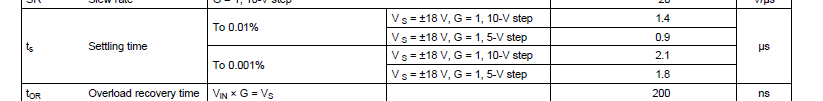

    The maximum sampling rate for the ADS8681 is 1MSPS, which means that entire circuit would need to settle within 1us. The OPA192, from its datasheet settles to 0.001% which is needed to achieve 16 bit performance, in 2.1 us. This does not include any surrounding circuitry, ie RC filters, which would onyl add to the settling time.

    Is it because due to internal 15KHz filter, The output of OPA192 observed is as per settling time mentioned in datasheet. Because i am switching the channels of mux at high speed at 3uS per channel and the settling time required for internal 2nd order LPF (15K) is more, but when i plotted the sampled values for a single channel it showed a clearly rise time of approx 60 us.
