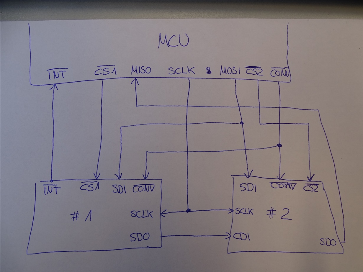

    - Please provide a couple of oscilloscope plot showing the daisy chain frame timing for CS#1, SCLK, SDI, SDO#1 as the device is being configured.  Place the oscilloscope probes in close proximity to the ADC I/O pins.  Is SDI being updated on the rsing edge or falling edge of SCLK?
    - - Please provide an schematic or diagram showing the daisy-chain connections.  Is the MCU reading SDO on the rising or falling SCLK edge?

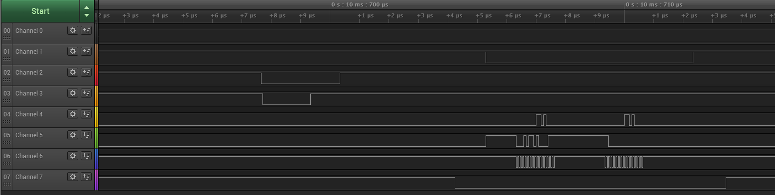

  • Hi Luis,
    thanks for your fast reply. Regarding your notes:
    - The attached window shows the results of the logic analyser:
    Channel1: CS#2
    Channel2: CONVST
    Channel3: EOC/INT
    Channel4: SDI
    Channel5: SDO
    Channel6: SCLK
    Channel7: CS#1
    Reference Voltage: 1.65V
    SDI is being updated on rising edge of SCLK
    One cycle:
    Reading CFR:
    -- Schematic diagramm of the daisy-chain connection:
    The MCU is reading SDO on the rising SCLK edge.
    Thanks and Regards,
    Sebastian
  • Ohh, the output images of the logic analyser were not transmitted succesfully (for channel discription see the notes above).
    CFR Configuration and CFR Reading:
    Only reading CFR:

  • Hi Sebastian,
    The ADS8332 is able to support SPI settings CPOL=1, CPHA=0 ; however,  one caveat is that the MCU needs to be fast enough to sample SDO within 5ns of the SCLK falling edge.
    When using using CPOL=1, CPHA=0,  the master captures MISO data on SCLK falling edges, and MOSI data is output on falling edge.
    Please see timing diagram below, where tD1 is 5ns minimum:
    It appears, looking at the code and at  plots provided that you are using CPOL=0 CPHA=1. Could you try using CPOL=1, CPHA=0?
    Which MCU are you using?  Can you please confirm the SCLK frequency?
    Please note some MCU's are not fast enough to read SDO within 5ns of the SCLK  falling edge and may require a longer SDO delay time.
    Thanks and Best Regards,
    Luis

    However, I think it is a fundamental issue. Differs the electrical wiring in daisy chain modus towards a single ADC with exception of the SPI pins?

  • Hi Sebastian,
    Yes, as you have mentioned, I don't believe the CFR is getting set.  The CDI pin is by default an output indicating EOC,  active low during the conversion period and high when the device is not converting.  This pin will  turn into an input after configuring ADC#2 with CFR D5=0 (Daisy Chain mode).
    I will setup this configuration in the bench, connecting the devices in Daisy chain mode.  I will provide zoomed-in oscilloscope plots of the two write CFR transactions programming ADC#1 and ADC #2 with the register settings; and then another set of transactions to read the CFR settings.
