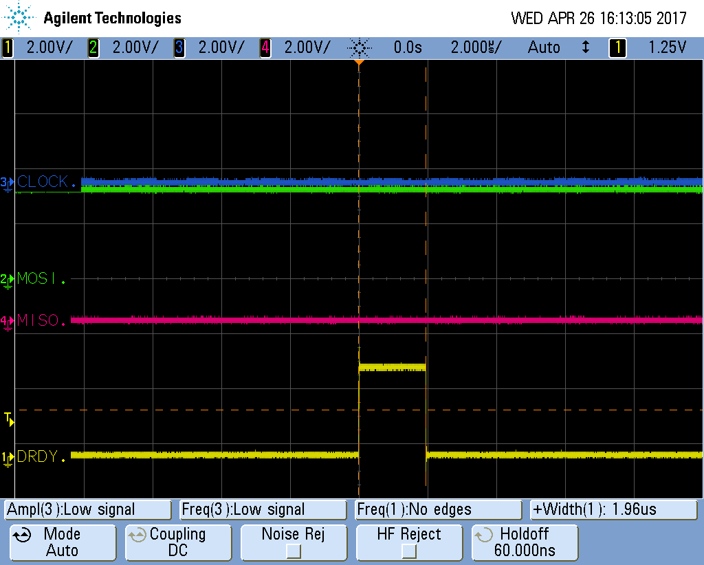

I have programmed the chip to RDATAC mode, but DRDY signal is not as datasheet which is normaly high and goes low for 1.96us when it has data ready. My DRDY is normaly low and goes high for 1.96us at the sampling rate frequency. Is this a problem of datasheet or my setup is not working correctly?

    You are seeing typical behavior. DRDY will only go high in the falling edge of SCLK or just prior to new data being ready. In this image you are seeing DRDY stay low because data is not read, then go high 4*tclk before data is about to be ready again, and then transition low to indicate that a new sample is ready. If you are reading data with each DRDY, DRDY will come high right when you begin to read data and only go low again the next time data is ready.
