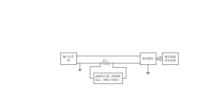

Hi Team:
My customer using ADS1148. They set the sample rate is 40SPS.
Input 0.67V DC and inject 0.33Vpp 50HZ. They verify the output will have 0.066V offset. And the 50HZ CMRR is about 14dB. But the datasheet show much higher rejection ratio. Any idea about it? Could you help me to check it? Thanks.

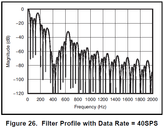

    Using the ADS1148EVM, I get about -14dB also. However, I believe this is the expected result.
    If you look at the frequency response at 40SPS, you'll find this plot:
    The first two frequencies where the magnitude goes toward 0 are at 40Hz and 80z. It's hard to tell on this graph, but 50Hz is definitely above -20dB. If 50Hz filtering is needed, 20SPS will give good rejection of both 50Hz and 60Hz signals.

  • Derek,
    From my first post, the -14dB result was actually from data that I took from the ADS1148EVM. It matches the customer's results that they had taken. The datasheet shows good 50 Hz rejection on Table 6 on page 22 of the datasheet. I would note that the good rejection comes only at 5, 10, and 20 SPS data rates. As I mentioned in my first post, a 20 SPS data rate will give good rejection at 50 Hz and 60 Hz.
    If your customer cannot use the 20 SPS data rate, the ADS124S06 (or the soon-to-be-introduced ADS114S06) has a 50 Hz data rate which will have good 50 Hz rejection. However with a 50 SPS data rate, the 60 Hz rejection will not be good.

  • Derek,
    Additionally, can you please translate the customer's diagram? I cannot read Chinese. Because this is a picture, I cannot cut and paste the Chinese characters to translate them.
    Joseph Wu

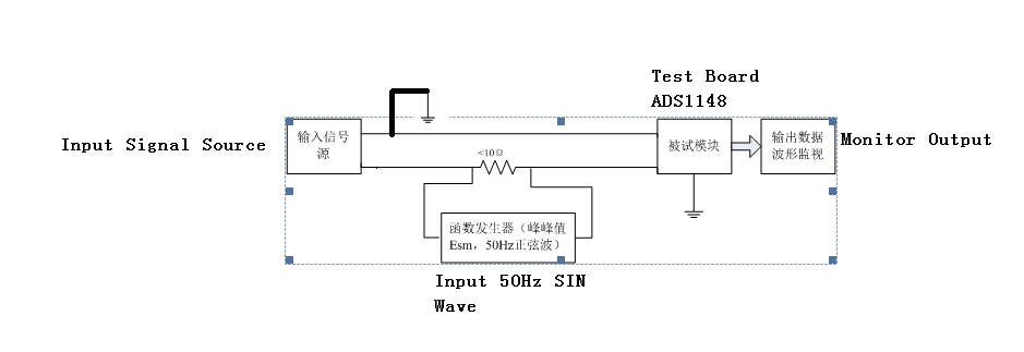

  • Hi Joseph:
    Thanks for your quick reply.
    Please see the trnaslate one.

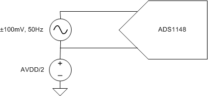

  • Derek,
    My setup for testing the ADS1148 normal mode rejection is a simple one. I use an input signal of ±100mV and the negative input of the ADC is set to AVDD/2. Here is a basic diagram.
    For the ADS1148, 50Hz rejection requires a lower data rate. Again, data rates of 5, 10, and 20SPS will have good rejection.
