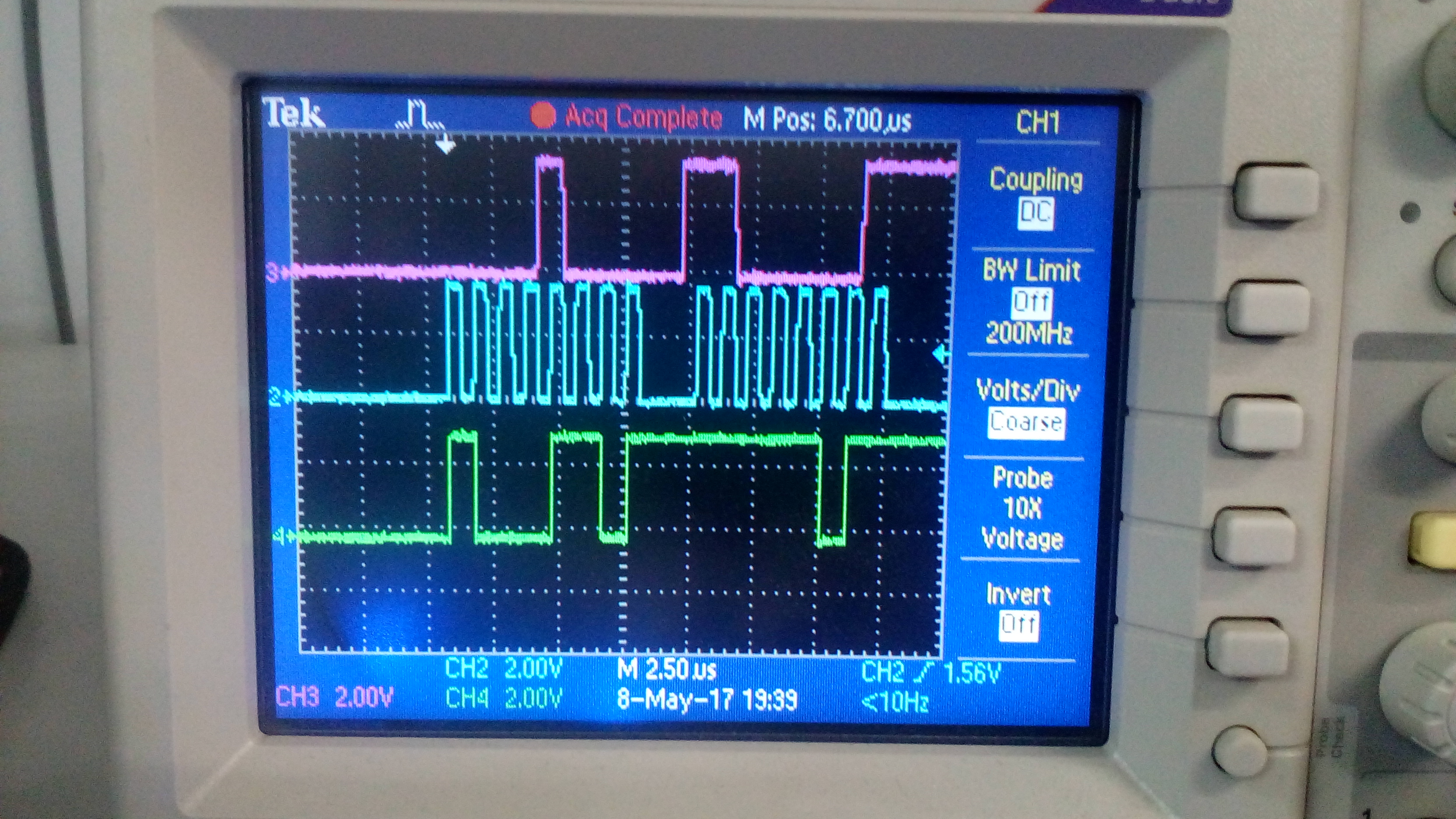

        We are facing an unusual problem with the serial interface of the ADS42LB69.
1) Every read is returning a different value! We have looked at the waveforms on an oscilloscope and they agree with the values being read.
2) There is data on SDO (serial data out of the ADS42LB69) even when address is being written to it in write mode.
It is clear that the data being written on SDO is only from the ADS42LB69 (there is no other device on the SPI bus). We have also tried varying the Serial Clock but it doesn't help.

    4) No, the power consumption does not drop if the 0xC0 or 0xC1 is written to 0x08 register address
    Attached are screenshots of the writes. (cyan is SCLK, purple is data being written to the ADC and green is the signal at SDO of the ADC).

    I do not see SEN on the scope shot. Is this low during the write? Can you replace the 10K resistor with a 0 Ohm part?
    Jim
  • Hello Jim,
               Yes, SEN is low during the writes to the ADS. We replaced the 10K with 0E but the problem persists.

    Lets get the writes working before worrying about the reads. Does your board allow you to issue a logic high reset pulse on the reset pin after power up? If not, can you make a modification to allow this? Are you always writing a "0" to address A6? After power up, and issuing a reset, if you have a CLK connected to the device, and CNTRL 1 & 2 grounded, you should be drawing current on all supplies. After this, write a 0xC0 to address 0x08. This should cause the power to go down. If you cannot get this to work, there is either a timing issue or the part may be bad. What is the frequency of SCLK? This cannot be greater than 20MHz. If you are reading data back on the SDO lines when you do a write, there may be a chance you issued a read command or some other signal is driving this net. SDO is tri-stated when the ADC is not in read mode. This is the only explanation I can give for this.

    4) Data showing up on SDO even in write mode is something we are unable to explain.
    We are monitoring the signals on an oscilloscope and we see no read signal being sent (of course we might still be missing something) but we have looked at the signals on the oscilloscope many times to confirm the same (also we have written the SPI controller code ourselves, so we know that nothing else is being sent).

    Further, SDO starts sending out data even before the end of the first 8 clock cycles (can be seen in the pics I sent earlier), so I don't think this is a problem.
    We just checked, SEN goes high after at least 1 us after the 16SCLKs.
    I think there is something wrong in the way we start because SDO starts throwing out data even during the address write duration. Also, even if we are sending a read command SDO should not become active until the 9th clock cycle.
    Shashank.

    1) Soldered wire to do a hard reset and gave a 300us reset pulse on power up. The SDO activity has stopped now.
    However the power does not drop when 0xC0 is written to 0x08.
    2) We connected the wire going to the reset pin to ground (on power up). And then applied a soft reset (i.e., wrote 0x01 to 0x08). In this case also the SDO activity is absent but the current does not drop in the 0xC0 case.
