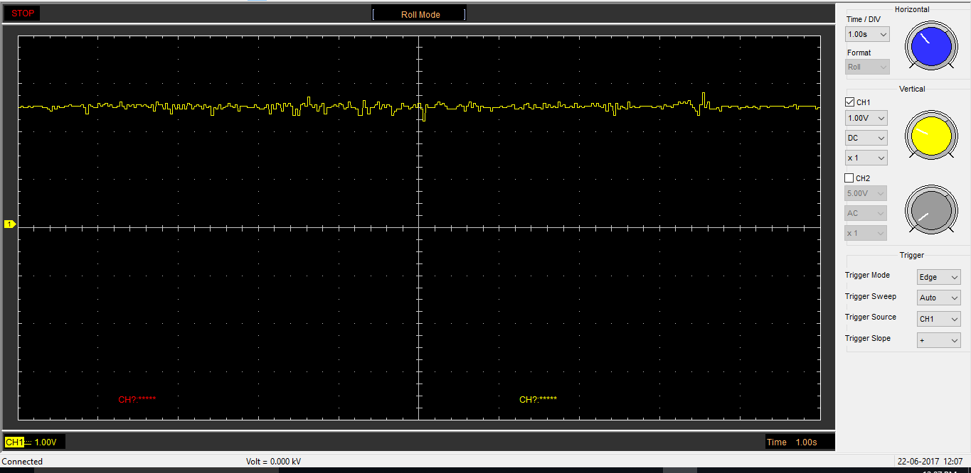

Im using ADS1271 to digitalize an EMG signal.
The signal is supposed to go from 0 to 5V before entering the ADS. The problem is that when retrieving the data from the MCU, if the signal has a lot of peaks, the retrieved data looks noisy. Below is the signal seen on the oscilloscope and then the Matlab figure with the data seen by the MCU (this was with a medium force contraction)
Here is a figure of the oscilloscope of an EMG data with a low force contraction:
As you can see, when the signal has a higher amplitude or higher peaks, there are some samples quite outside the average range...
Below is the configuration used (High resolution and pseudo-differential configuration with AINN at 2.5V)
What could be the reason of that behavior? Or what can I do to correct this? Im concerned this could modify the signal frequency (the FFT results)...
Is there a way to mmmm correct this with the MCU??
I attach also an image of Matlab with a high force contraction:
Thanks!!!
  • Hola Miguel,
    The maximum differential input must be limited to +/-VREF (2.5 V in your application). It appears that at times, your differential input voltage exceeds 2.5 V, even 3 V, according to the MATLAB plots you show. Is the y-scale correct on the MATLAB plots?
    A couple questions just to clarify the measurement setup:
    1. It looks like your oscilloscope captures show an input signal centered around 2 V. Is this measured with respect to GND or with respect to AINN?
    2. Can you confirm that AINN is fixed to 2.5 V (also with respect to GND)? If AINP is truly between 1 V and 3 V, and AINN = 2.5 V, then the differential voltage should be between -1.5 V and +0.5 V. This is an acceptable input range that would not cause such behavior in the ADC.
  • Hi Ryan
    The data seen in Matlab is the data after being converted.  The scales is right, yes.
    1)The oscilloscope captures are centered on two for a problem Im having with the last opamp. For some reason, when incrementing the gain of the amplifier, the offset voltage drops.
    2)AINN is indeed fixed at 2.5V (I checked it some weeks ago). AINP is supposed to go from 0 to 5V, as the ADS1271 is supposed to change from 0-5 to 0-3.3
    I attach the schematic of the filtering stage
  • Hi Miguel,
    In the first question, I was asking how the scope measurement was made. I assume the GND lead on the scope probe was connected to GND? So the DC common-mode voltage is about 2 V on AINP. Can you do the same measurement on AINN? From the MATLAB data, it appears that you have an average of 3 V between AINP and AINN, but according to your schematic, the differential voltage should be centered closer to 0 V.
  • Hi Ryan
    respecting the first question, yes. It was done with the GND pin and it is in fact close to 2V.
    Also the AINN is at 2.5V. I just checked it again and is in fact at the correct voltage...

  • Exactly - so if AINP is centered around 2 V and AINN is around 2.5 V, I would expect the differential plots in Matlab to be around -500 mV. Instead they are close to 3 V, which is beyond the ADC full-scale. Let me know the result of measuring AINN. You could also measure AINP and AINN on the scope together and use the MATH function to plot the difference.
  • Hi Ryan
    I just ploted the difference (A-B). Here is the result.
    When measuring both signals, I saw that if the AINN was in 0, the red signal was equal to the yellow signal and then it would be using the full scale no? But in this post:  you told me to use the AINN at the same voltage as the reference to get full scale. Or Im missing something here? Is the comparison with the REFP?
    Best regards
  • Hi Miguel - the comparison is with the differential reference voltage: REFP - REFN. You are correct that, if AINN = 0V and AINP goes from 0V to 5V, the differential input voltage will also go from 0V to 5V. This is not acceptable since your reference voltage is only 2.5V. This limits the differential input voltage range from -2.5V to +2.5V (not 0V to +5V).
    The (A-B) plot on the scope looks correct - that's exactly what I expected to see. The common-mode input voltage is about 2V - 2.5V = -500mV. Why does this not match the MATLAB plots? The differential input voltage (i.e. the "red" curve) is what the ADC is converting.
    Can you please zoom in on the CH1, CH2, and MATH curves on the scope and check the peak amplitude? You need to make sure that MATH function never exceeds +/- VREF (-2.5V to +2.5V). Over-driving a delta-sigma modulator (especially a high-order modulator like the ADS1271) can cause the modulator to saturate. This may explain the large transients you see in the MATLAB data plots.
  • Here is the signal with the measurement from the cursor to the lower peak
    Here is the same image but with the cursor in the middle of the signal
    The signal has an amplitude of ~3.3V. If the signal is measure from the middle, it shows a 1.85V...
  • I see the issue:
    AINP (CH1) ranges from 0V to +3.5V
    AINN (CH2) is fixed at +3.25V
    The differential input voltage (MATH) ranges from -3.25V to +0.25V. You are exceeding the negative full-scale range (-2.5V). This is likely causing the modulator to saturate, which triggers an internal reset and produces the large transients shown in the MATLAB plots.
    Reduce the dc voltage on AINN to 2V. The differential input voltage range will then be -2V to +1.5V and will not cause this issue.
