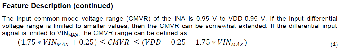

I would like to ask you a basic question about following explanation. (datasheet page16)
What is the value of "1.75" and "0.25"?  Input bias voltage of INA??
And about VINmax is 0.4V, right?
Sorry for my basic question, thank you in advance.
