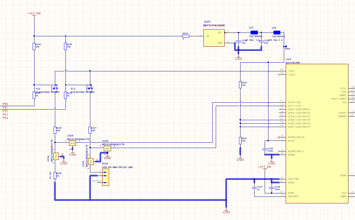

  • Dear Joseph,
    here is a screenshot of our design.
    As you see we have connected AIN5-7 (negative channel) through a voltage devider to a precision voltage reference of 3V, so that we have 1.5 Volt Level on These Input channels. On AIN0 we have connected a Precision 1k Resistor for a calibration measurement, on AIN1 we have a connector X160 where we connect a PT1000 Temperature sensor. IEXC1 is configured to have the 1mA Current Source enabled.
    Concept is now to Switch on T12 first to have the 1mA flow through R162 and make one calibration measurement. Second step is to Switch off T12 and Switch on T13 and let the 1mA current flow through the connected PT1000 into GND and measure again. Perhaps the voltage devider R149/R161 Needs to be adjusted to match the Voltage we have on the positive channel while measureing the Refernece Resistor R162.
    Is this a possible setup?
  • Daniel,
    Basically you could do this type of a measurement but there are some issues to keep in mind. There is some error from the REF3030 which would offset the 1.5V that you're setting up with the voltage divider.
    Also, I would recommend removing R156 and R157. During the calibration, T12 is sourcing 1mA into 2.5kΩ which means that the stack voltage is 2.5V. With AVDD = 3.3V, you have a compliance voltage to the positive supply of 800mV. This is a bit small, and you'll see that the IDAC current will be much less than 1mA. Look at Figure 41 from the datasheet for IDAC voltage compliance. While this figure is for a 5V supply, you'll see that at 800mV of IDAC voltage compliance, with a 1mA IDAC, you're probably going to be near 850uV. If you remove R156 and R157, you won't have this problem. If you need to have them, then make them 500Ω.
    If the PT1000 is connected to the terminals of 1 and 2 of X160, and the PT1000 is actively measuring a hot temperature, then you may need to make further adjustments. At very hot temperatures the PT1000 will get to 3kΩ or 4kΩ of resistance. That would also increase the stack voltage so that the IDAC output would drop because of the compliance voltage.
    However, I'm still not clear on what you are trying to measure. Are you just trying to measure a two-wire PT1000? If that's the case, I would just used a ratiometric measurement with a 4kΩ precision resistor as a reference from REFP1 and REFN1. I also don't see why you're using T12 and T13 when you could just send the currents to IEXC1 and IEXC2. I can think of a few different ways to make this measurement, but I'd just like more of a clarification of what exactly you want to measure.
    Joseph Wu
  • Dear Joseph,
    indeed i am trying to measure a two wire PT1000. We have temperature of -100 to 100°C maximum. The measurement must be at least as precise as 0.1°C, if possible better.
    The reason for the Transistor ist, that we do not only have the one channel like shown in the schematics above, but we have up to 6 channels we have to measure one after each other. Every channel has one transistor to switch the current to the channels.
    Thank you for pointing me to the issue of voltage. i will adjust R156 and R157 to 500Ohms.
    Regarding the offset of REF3030: I am aware of this, also the Voltage Divider R149/R161 brings more error due to tolerances of these resistors. That's why i want to make the calibration measurement with R162. Don't you think that i can calibrate the offset error with this calibrtion measurement?

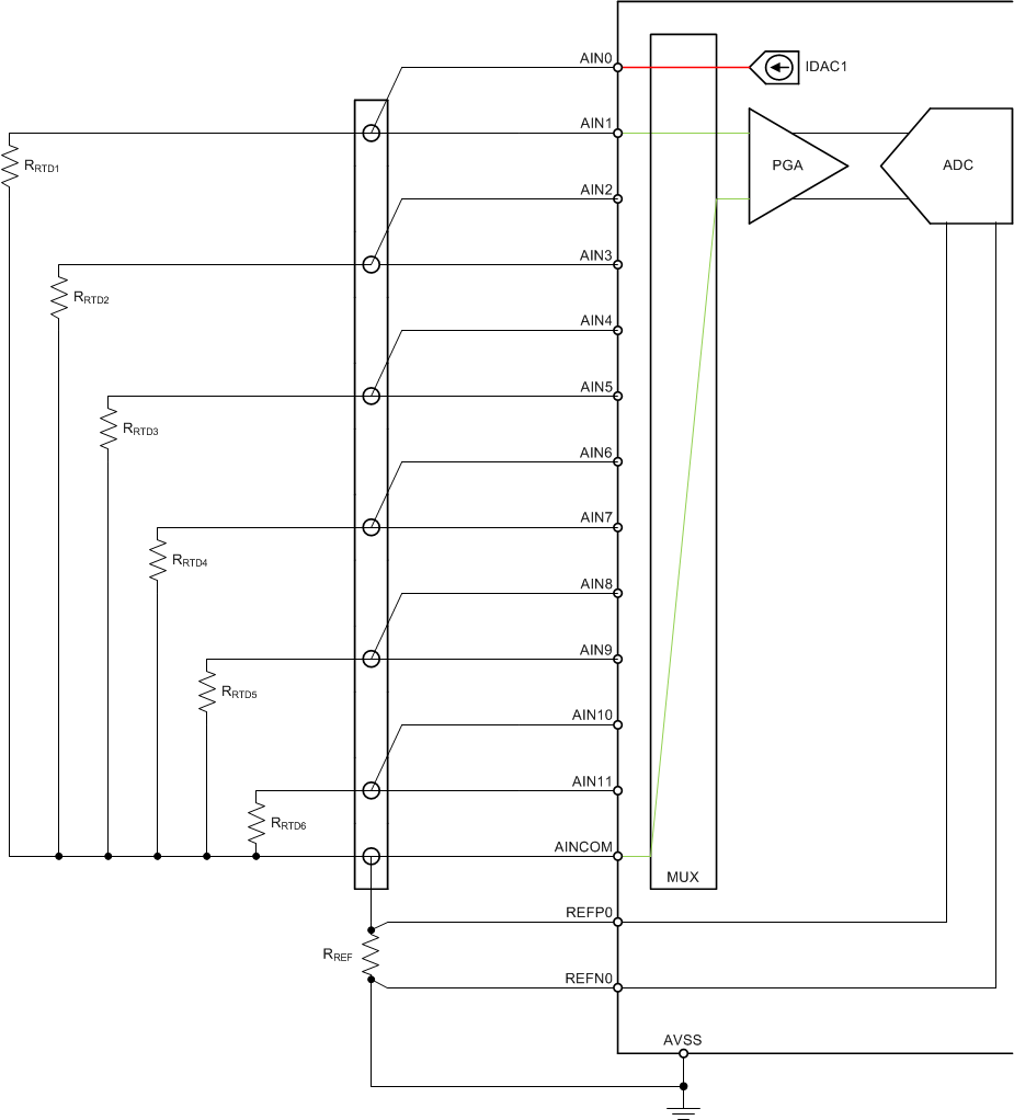

  • Daniel,
    I think it would be better to have a slightly different setup and simplify the measurement. Also, I'm going to suggest that you use the ADS124S08, which has a few more analog inputs. Here is an example of how you would measure 6 two-wire RTDs that should be more accurate. I've drawn this without any input filtering. In industrial environments, you'd use simple RC filtering to reduce any EMI/RFI to reduce the noise. If you don't need the filtering, you may reduce the analog inputs that you use, and drive the RTDs directly through the analog input used to measure the input.
    The IDAC excites the RTDs individually. The diagram show a measurement for RTD1. IDAC1 goes to AIN0 and excites RTD1 and the reference resistor. ADC measures the RTD using AIN1 and AINCOM. To measure RTD2, IDAC1 gets routed to AIN2 and the ADC measures from AIN3 to AINCOM, and so on.
    Because the same IDAC current drives both the RTD and the reference resistor, this is a ratiometric measurement. To get the RTD value, you don't need to calculate the voltage and the ADC output is a ratio between the RTD resistance and the reference resistance.
    ADC output = 2^23 * PGA gain * (RRTD / RREF)
    The reference should be larger than the RTD resistance. The reference represents the positive full scale range. You will need a precision resistor for RREF. It should be high precision and low drift. Any error in RREF will appear as a gain error.
    In the design, you need to make sure that the RTD sensor voltage is within the input range of the PGA. Also, confirm the voltage across RRTD + RREF is within the compliance voltage of the IDAC (if the voltage is too high, then the IDAC current starts to drop off).
    The ADS124S08 datasheet has an example application at the end of the datasheet. It is for a three wire RTD measurement, but it does outline a design procedure. Regardless, I would certainly consider the ADS124S08 for your design.
    Joseph Wu

  • Daniel,
    If you are making measurements from -100°C to +100°C, your resistance range will be from about 600Ω to 1400Ω for the PT1000. If you use a reference resistor of 2800Ω, then the total resistance will be 4200Ω and if you use a 500uA IDAC current (with a PGA gain of 2) then the total voltage is 2.1V, with a reference voltage of 1.4V. This would be within the input range of the PGA and within the IDAC compliance voltage. I don't think you need the 5V supply at all.
    If you only need 4 channels, I think the ADS1248 would work. You would need to use the IEXC pins to source current, but you have enough to make the measurements. I would note that the ADS124S08 does have better specifications for gain error and offset (and a better specification for voltage compliance).
    As I've described it you don't need an external reference. You do need to enable the internal current source because it is used to generate the IDAC current values, but there's no need for an external reference.
    I'm not sure what precision to expect. There is a certain amount of error associated with the RTD itself. In many cases the RTD has a 0.1°C error. You should be able to calculate an approximate error based on the gain error, offset and noise seen in this measurement. I will say that my method should work better than what you had previously drawn. In your setup, you'll need two measurements to compare and calibrate out the error (both absolute error and any drift) in the reference resistor and the additional reference. Additionally, the REF3030 will add noise to the measurement. I see this as a complicated
    In the solution I describe, it's simpler, requires only a single measurement, and I only need to worry about the reference resistor accuracy and ADC gain error.
