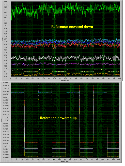

I have a problem with the internal test signal noise of the EVM. There seems to be much more noise in the waveforms as is suggested by the user guide, which doesn´t show any ripple in the signal. I´ll include some screenshots of the analysis tab for a better overview of the problem.

  • Kaarel -
    After another look at your settings, it appears that you may need to change them to get the correct test signal.  For the test signal the Reference Buffer needs to be powered up (Configuration Register 3).
    In the attached, the effects of turning on or off the reference buffer are shown.
    Let us know if there is anything else we can help with.
    Greg
  • Hi Greg!
    I tried the setting for Config Reg 3 you suggested - it worked. The signals now look nice and clean. Many thanks!
