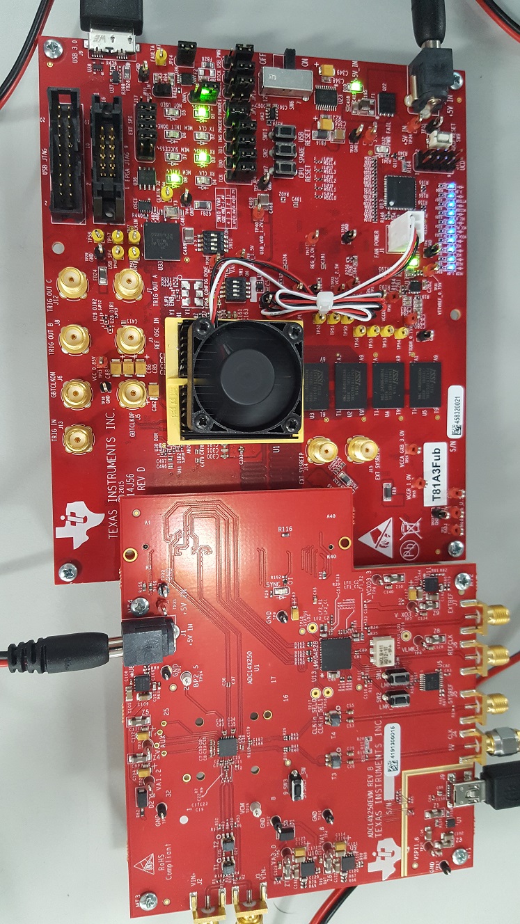

  • Hi John,
    I just went through the "Quick Start Guide" in the EVM User's Guide, and was able to get a capture in HSDC Pro using the ADC14X250 EVM Rev B and the TSW14J56 Rev D.
    After connecting/powering up all inputs to the boards as described in the Quick Start Guide, your setup should look like this.
    After connecting to HSDC Pro and loading the appropriate firmware and files (ADC14X250_LMF_112), your setup should look like this. Notice SYNC LED on ADC has gone out. Also, D3 (RX Sync) on the J56 has illuminated.
    Next, configure the ADC14X250 with the GUI by clicking both "Program LMK04828" then "Calibrate ADC14X250". There should not be any change to LEDs.
    Return to HSDC Pro and enter 250M in the "ADC Output Data Rate" field, and push enter. You should see a notification pop up like this.
    Now, click "Capture" and you should see D3 (RX SYNC) turn off and D4 (RX CLK) will start to blink. Also, notice that the SYNC LED on the ADC14X250 has illuminated. Most importantly, there will be a successful capture on HSDC Pro, as seen in the below pic.
    If you did not get the same results as I did after following my steps, please let me know at what point things were different for you, and we can start there.
    Also, please ensure that you have installed both the ADC14X250 GUI and the HSDC Pro Software as an administrator (right click on the respective setup file, "Run as Administrator").
    Dan

    So the first thing i did was reinstall all SW, running installation as administrator.
    I connected the board and configured it with the ADC14x250 firmware from the high speed data converter pro SW(V4.70)  as instructed. Connection established and firmware appears to download. I observed DIFFERENT glowing LEDs on the TSW14J56 board than you did. (Specifically, only LEDS D3, 6 and 7 turn on) I did see the SYNC LED turn OFF on the ADC14x250 eval board.
    Then i went ahead and programmed the LMK04828 on the ADC14x250EVM using .the GUI utility (ADC14x250EVM GUI)  The LEDs on the TSW14j56 board  ALL GO OUT. The SYNC Light on the ADC EVM turns back ON!
    Continuing on with the steps above results in the WRITE _REGISTER_FAILED error, my originally reported problem. :(

  • Dan-
    I did have another ADC EVM and when connected it to the TSM14J56 board and configured with ADC14x250 firmware (via the high speed data pro SW) it maintained the same LED pattern i reported yesterday (D6,7 and 3 illuminated). However when i then programmed the LMK04828 the LED did not go out as before. LEDs D3,6 and 7 of the TSW14J56 board stayed lit and the Sync LED on the ADC14xEVM stayed off.
    Thanks!
    John
  • John,
    Unfortunately, it seems as though your TSW14J56 board is the culprit. The LEDs D66 and D7 should not illuminate, and D8 should be lit. It appears that the DDR memory is having some kind of malfunction.
    I'm sorry that there isn't a direct solution that we can provide. I suggest returning the board through your supply/requisition channels, and trying again with a new J56.
    Before you return the board, could you please provide us the TSW14J56 device serial number? It is the identifier that comes up when you connect the board to HSDC Pro. This will help us determine the batch that this board came from. Thanks!
