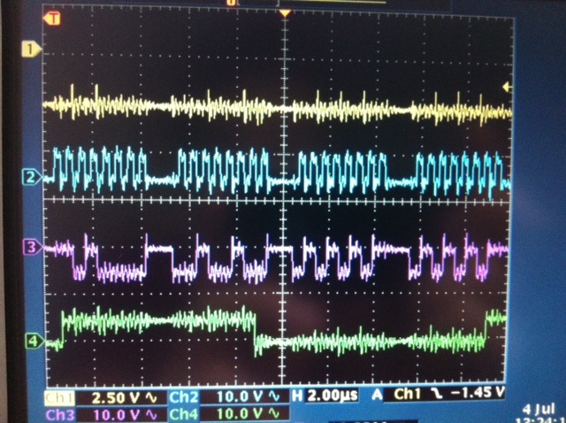

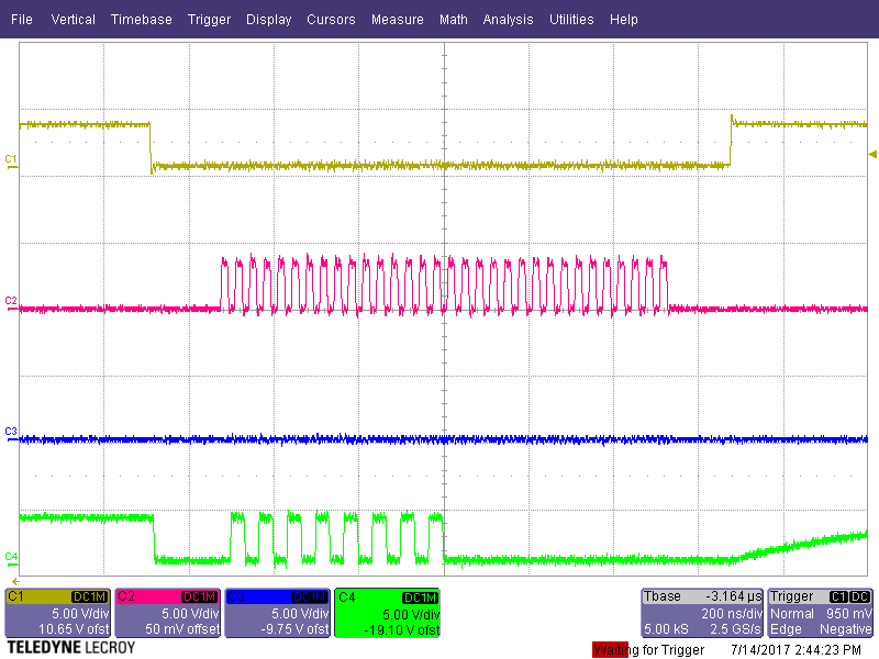

  • Linus,
    Can you please attach a picture of the scope capture for SCLK, SDI, SDO, and CS? We can look at this to check for any timing violations.
  • Hallo Art Kay,
    here it is:
    yellow is CS, blue is MOSI, red is MISO and green is the clock.
  • Linus,
    1. I think you are communicating correctly, and getting the expected results.
    2. The read command you are using is an 8 bit read. See page 54 in the data sheet. You may want to use the 16 bit read to get the full alarm threshold register. Now you are getting only 8 bits.
    3. The data can only be read in the next frame after issuing the read command (the 32 BIT transaction you show). So, if you repeat the command twice, you will see valid data on MISO corresponding to the register you selected in the first command.
    4. I believe that you have issued the command shown more than once, so you are reading the correct value for the ALARM_H_TH_REG here. The default for thisregister is FFFFh. So, you are reading the first byte of this register. If you used a 16 Bit read you could get the entire FFFFh.
    5. I suggest that you use write the register first and then read the device to confirm that you are getting back what you wrote.
    6. I suggest using the 16 bit write and read (READ_HWORD, and WRITE_HWORD). I think this will simplify your software as you will not have to do as many writes.
    7. The readback is the first byte in this example (FFh).  This is the readback for the previous frame.
    I hope this helps.

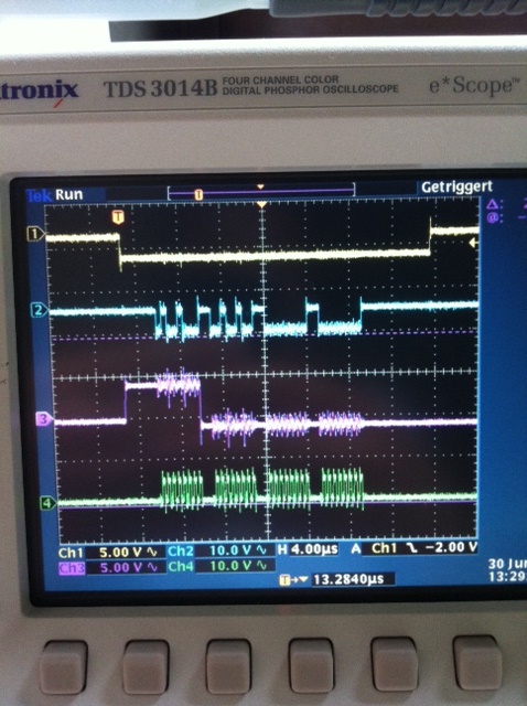

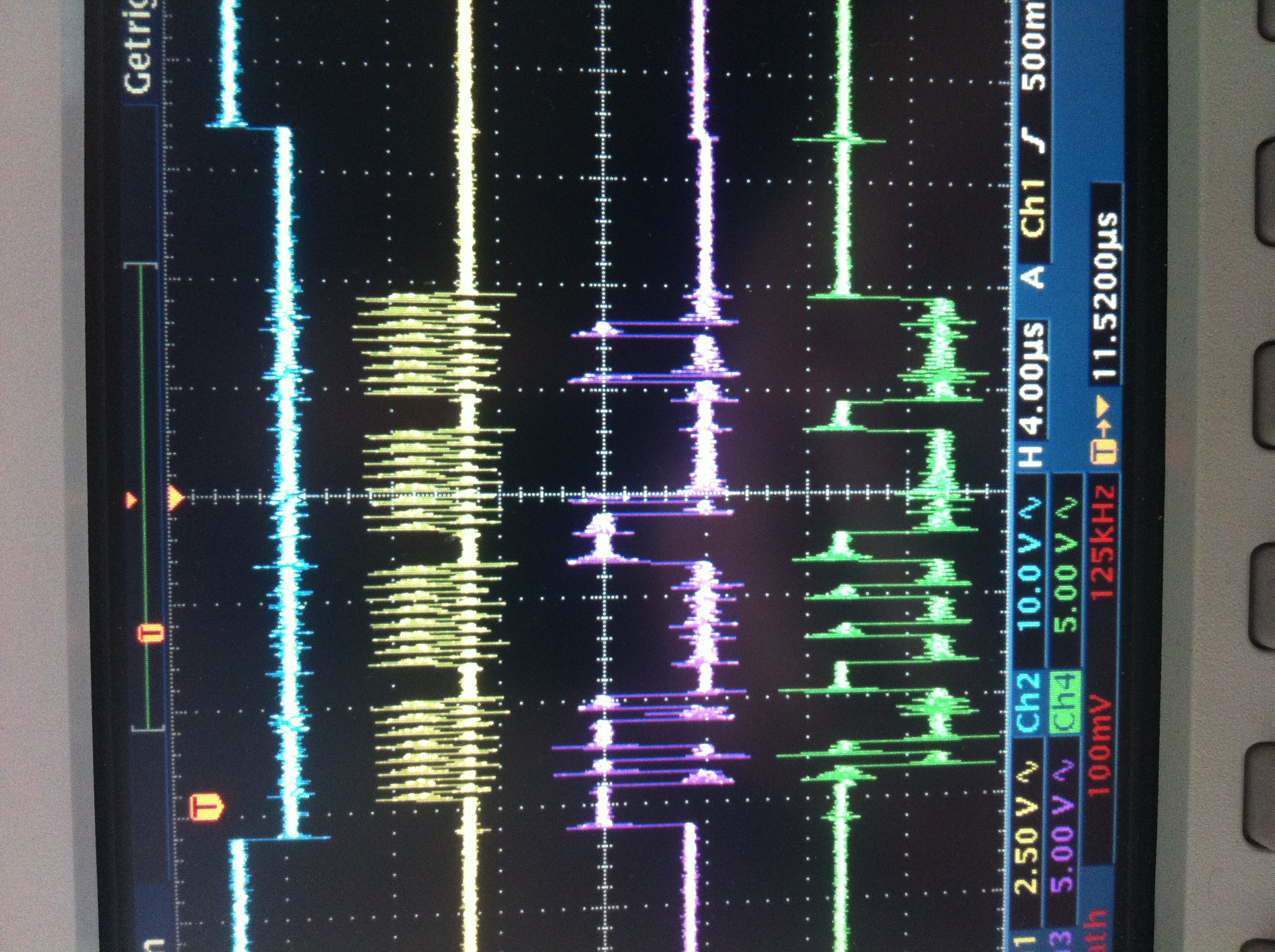

    ok, I sent the following bytes now:
    CS low
    Writing:
    D0h    (Write two bytes command)
    24h    (Register address)
    55h    (alternating 0s and 1s)
    55h
    Reading:
    48h    (read two bytes command)
    00h    (send zeros and simultaneously read MISO)
    00h
    CS high
    The scope shows:
    Zoom on first 4 bytes (writing):
    Zoom on last 4 bytes (reading):
    My Arduino still reads zeros, although I wrote 5555h ...
  • Linus,
    1. I think your frame setup still has a small problem.  The frame should have 32 clocks in it.  I believe that you have 64 clocks in your frame.  You need to raise chip select (CS), between writing and reading.  I hope this solves your problem.
    2. Also, your digital signals have a lot of overshoot and undershoot.  This could be interpreted as data if it is bad enough.
      1. How is your board layout?  Did you create a PCB?  Do you have a good ground plane?
      2. Is your scope probe close to the digital pin’s you are measuring?  Do you have a good ground connection on the scope probe?
      3. Assuming the overshoot is real, you may consider adding a small resistor 50 ohm in series with each data line.  See page 22 of the ADS8689 users guide for a schematic showing this (R26, R27, R28, R29).  This will soften the edges of your waveform and minimize overshoot. http://www.ti.com/lit/ug/sbau252/sbau252.pdf
      4. Ideally you would use an ADS8689 evaluation module to make your measurements.  This board was laid out carefully to optimize performance.  If you are doing your own layout you http://www.ti.com/tool/ads8681evm-pdk

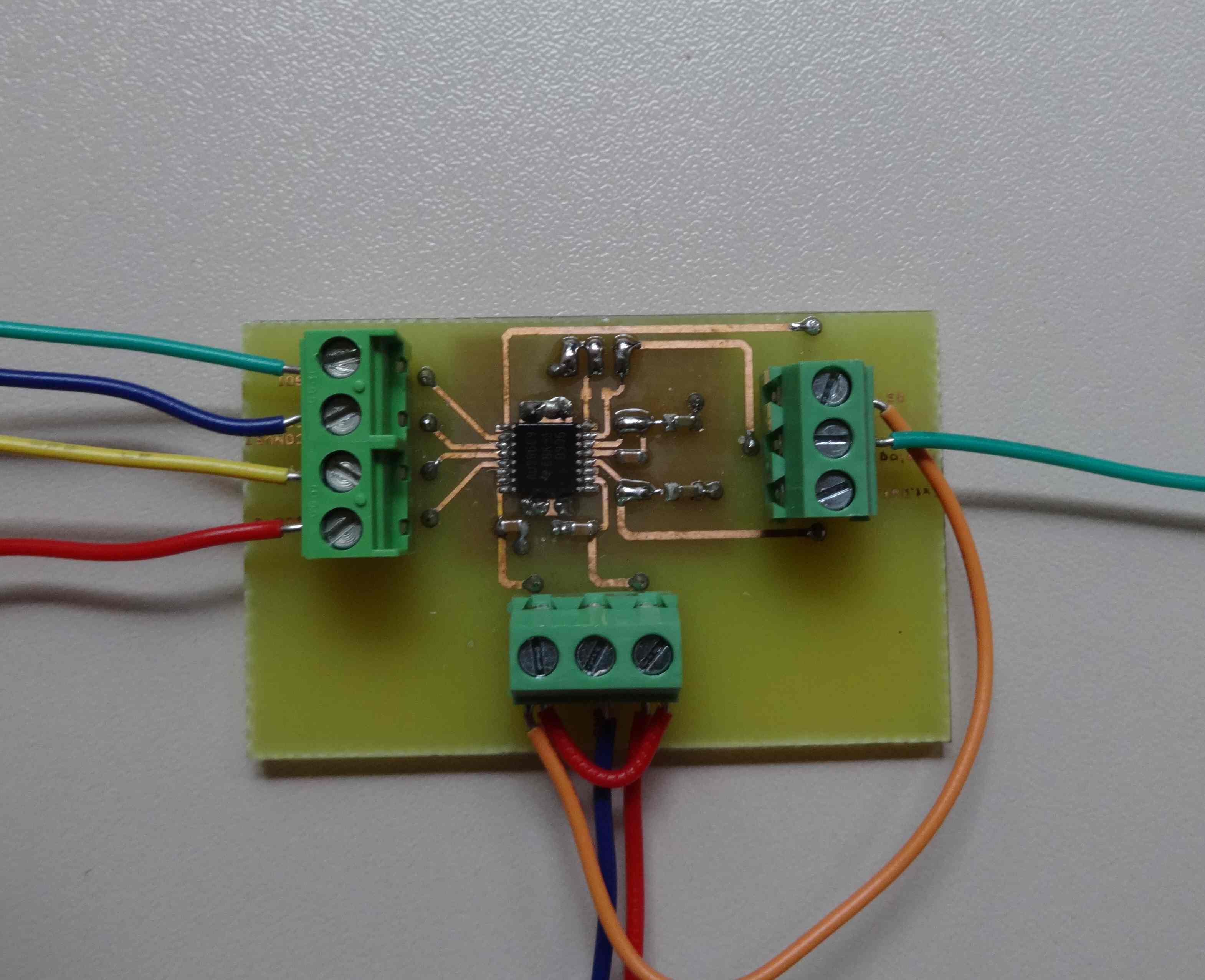

  • 1. I forgot pulling CS high in between the frames, thanks. Unfortunately it won't solve the problem yet.
    This is what my scope shows now (I am sending ffffh in Write command now):
    2.1 The electronics workshop made a board for me, picture below. They followed the layout given by the datasheet.
    The lower pins are DVDD, GND and AVDD. The left ones are the 4 SPI pins. The right ones are RST (connected to DVDD, 5V) and Analog Input.
    I think the board layout should be fine.
    2.2 The scope is connected with 1m coaxial wires to the jumper wires of my setup.
    2.3 I tried the 50 Ohm resistors, they made the signals nicer
    2.4 If I cannot use the ADC like this, I would need to get the Eval, although it it quite expensive. And I thought it should be possible to do it on your own, but it seems to be a rather special ADC which is not made for single users but for massive industrial consumer.

    If you followed the layout example in the data sheet the device should operate fine.  Looking at your layout, I do not see a top layer connection from the ground side of the capacitor to the ground plane under the capacitor (see circled below).   It looks like the capacitor ground is connected to the ground plane below with a via, but not to the top ground plane.
  • Hallo Art
    Thank you for your effort and committment to help me.
    Yes, it is true, the capacitors are not connected to the upper ground plate, but to the lower one. Can that be a problem?
    Backside of the board. The digital and analog ground are seperated.
  • Linus,
    Yes, you should connect the capacitors to the top ground plane. The inductance of via's can cause issues so it is best to have the power and ground on the top layer connect to the decoupling capacitor. This may not fix your communications issues, but will help with performance. The fix is easy, and you will not need a new PCB. Just place a small wire from the cap to the ground plane where the circles are in my previous post. Also, I will look into the actual device soon and give you more details on communications.
    best regards,

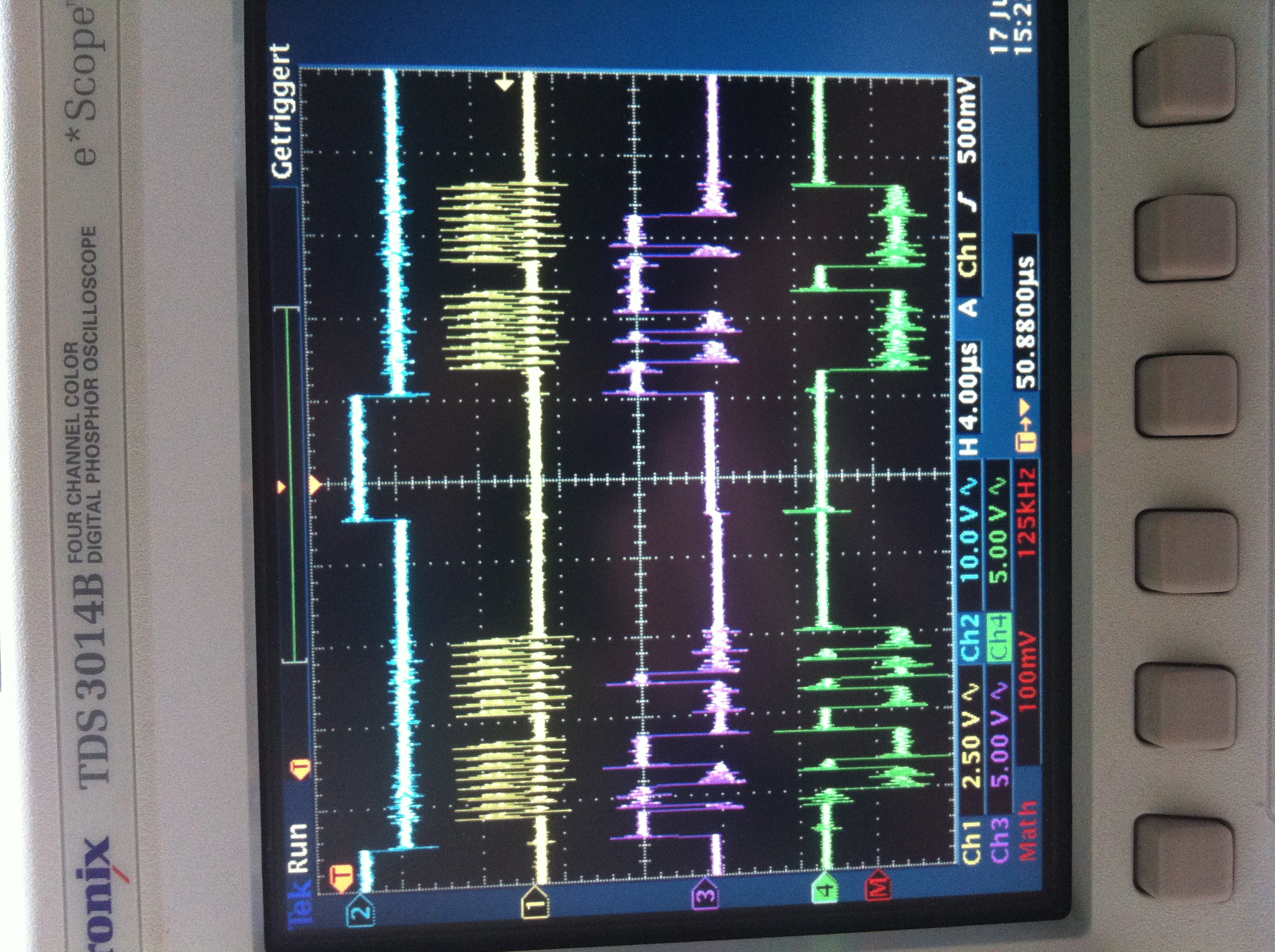

  • Hello Art and Evan
    I followed the instructions you gave me, the result is below in the oscilloscope. I am no longer reading zeros, but some randomly fluctuating value. The SPI signal is still very noisy, which might come from the arduino. For other SPI devices this was no problem, can it be in this case?
    overview (green=MOSI, purple=MISO, writing 0000h to register 24h, then reading register 24h):
    writing 0000h:
    reading:
    There are still some differences between our cycles due to the SPI library I use for the arduino:
    - my MOSI is usually high, yours is low
    - my MISO is usually low, yours is high
    - I have short breaks after every byte
    Is any of the above a problem? If not, then there should be something wrong with my layout or the ADC

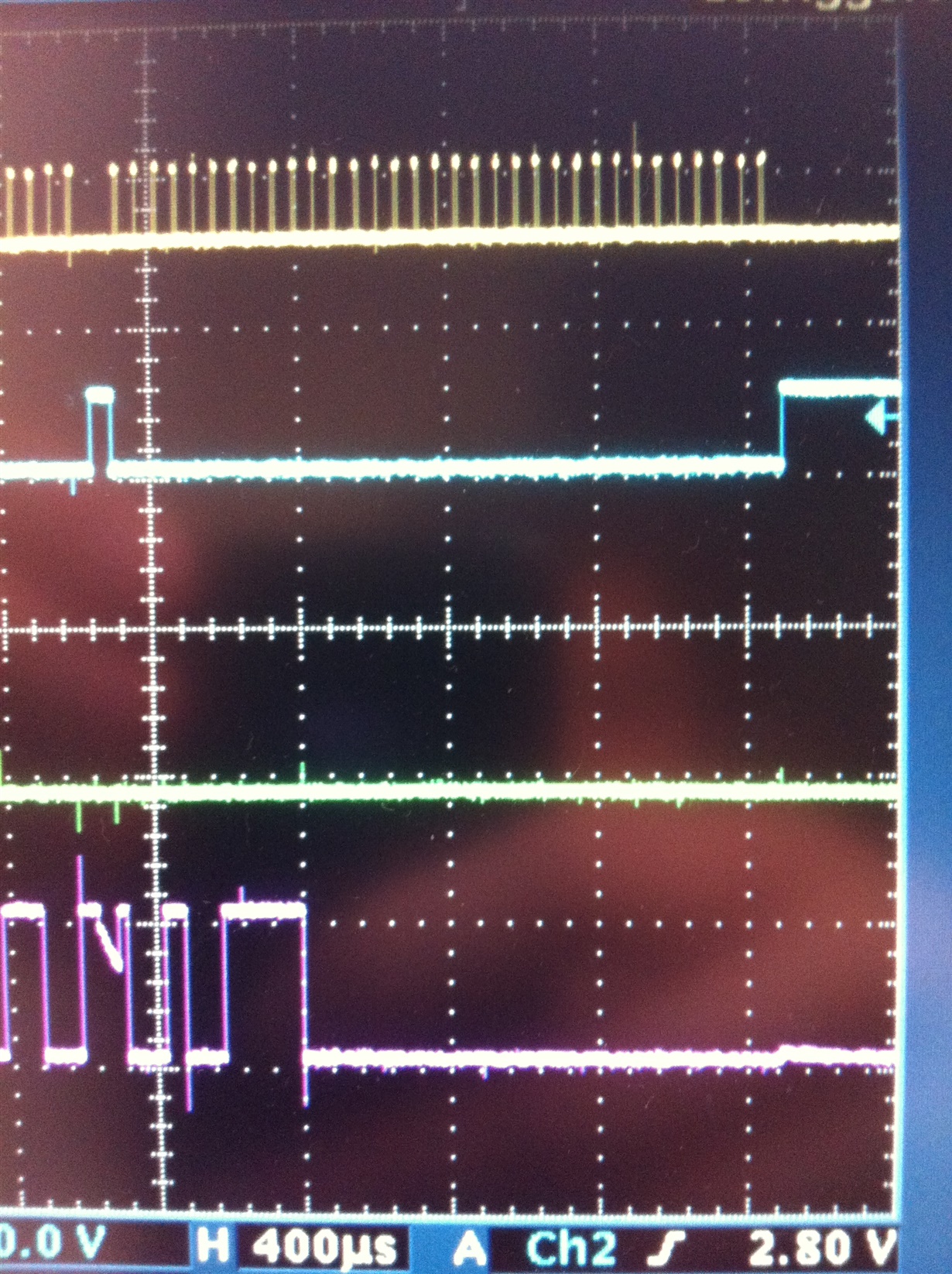

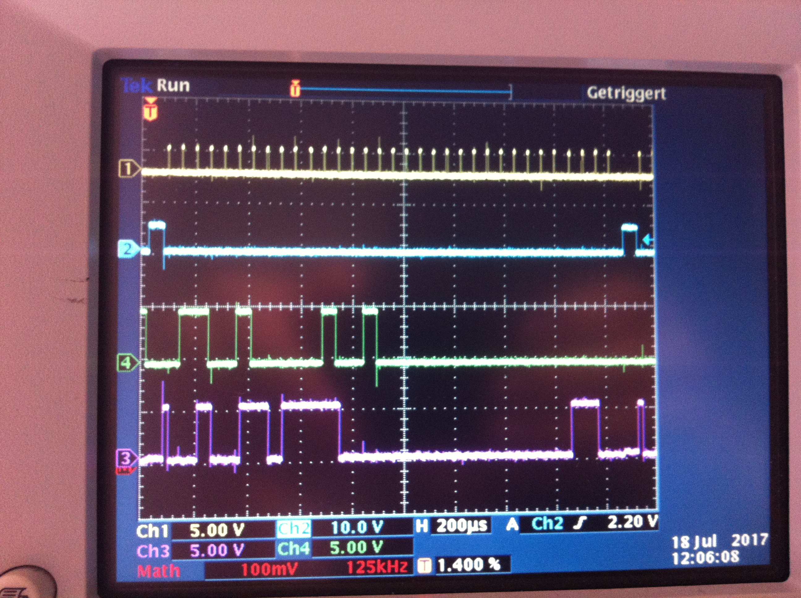

    as the SPI communication with the arduino library is not very useful, I now send the bites manually, which slows everything down as well.
    Unfortunately I still dont receive what I write to the register. The MISO does not seem to react on the MOSI. even if I send only zeros, I receive he same MISO.
    Do I still miss something?
    Below my scope (I pull the clock high before flipping CS, because otherwise the first clock pulses would have a smaller amplitude) :
    overview:
    Write frame:
    1st read frame:
    2nd read frame:
    If I send only zeros:
  • Hi Linus,
    It appears that in both read cycles there are 33 clocks. If that is the case, then the first clock of the 1st read frame (providing the read command) is clocking in a value of '0.' Thus the command '6412' is being provided instead of the correct read command of 'C824.' I tested the incorrect code in the lab and received the same code during both read frames (the data is just the converted result).
    I recommend:
    1) Reduce the number of clocks during both read frames to 32.
    2) Provide a slightly longer delay between pulling CS low and the first clock.
    3) If 1 + 2 do not work, try slowing down the speed of the system while debugging. This will give the clock more time to rise (I don't suspect that this is the issue).
  • Hello Evan,
    thanks a lot, that was probably the final mistake I made! I didnt see there were 33 clocks. Now I fixed it and eventually managed to write and read from the Alarm register properly. Now I can try to read the dataout register. I assume I should send something like this:
