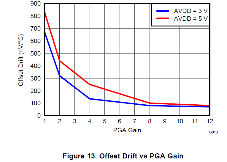

    How does offset error drift of 0.65uV/C change with gain?
    Dave
  • Hi Dave,
    Offset error drift also reduces with gain. See Figure 13 below:
