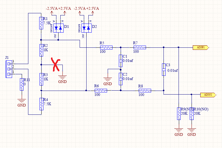

    1. the sensor of nonametrics : www.nanometrics.ca/.../trillium-120-Q-QA the output of the sensor is +-40V, is there any design reference about the wide voltage range input and wide dynamic range data acquisition system.

    1. following data is main  parameter of the sensor:
    Output impedance of the sensor: 2 x 150Ω ±1%
    output voltage of sensor: 40V peak-to-peak differential Selectable XYZ or UVW mode
    the frequence range of the sensor: 120s-100HZ
    now i used the resistance divide circuit to test it. BUT, Perhaps , TI have more good idea or reference to resolution for this.

  • Hi Kevin,
    Do you know what the common-mode output voltage of the sensor is? Are the output voltages centered around 0V or some other voltage potential? Also, are you using bipolar (+/- 2.5V) or unipolar (AVDD=5V, AVSS=0V) supplies for the ADS1282?
    ...I ask because you may need to level-shift the sensor output so that the output common-mode voltage is centered around the ADC's mid-supply voltage. We certainly can help to recommend an active circuit to do this; however, I generally prefer to use passive components whenever possible, since active devices may introduce significant noise, offset, gain, and drift errors into the measurement.

  • Hi Kevin,
    Would you be able to share a schematic of your input circuit and perhaps a code snippet of how you are reading the data?
    If you are only reading 24 out of the total 31 data bits, then I would suspect that you might have a sign error in your code since ABS(-8386937)-2^23 = -1671, and ABS(8386800)-2^23 = -1808, would appear to be more appropriate intermediate results.
    It is also possible to have a zero-crossing error if you have too much series resistance or a small differential resistance in the input circuit, but I would not expect this to result in such a large error. This usually is a much smaller error resulting from the input capacitor not being able to main the correct low-charge voltage.
    Chris
  • Hi Chris
    thank you for your  patience!following picture is the input circuit and code of the ads1282.

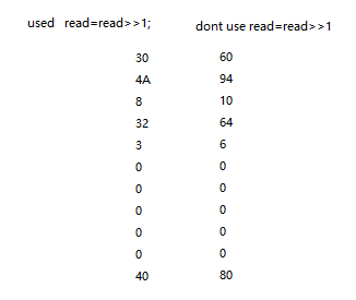

    unsigned char SPI3_ReadByte(void)
    unsigned char i;
    int read = 0;
    SCK3_0();
    for (i = 0; i < 8; i++)
    SCK3_1();
    if (ADS1282_DOUT3)
    read++;
    ADS1282_DelaySCLK(5);
    SCK3_0();
    ADS1282_DelaySCLK(10);
    read = read<<1;
    read=read>>1;
    return read;

    there is another matter about the program. you can see i have a read=read>>1;  in read SPI ,i don't know why need this, because read SPI and write SPI are with sck rising edge, if i don't use this statement,the output data will move to right one bit.

    Regarding the "read = read>>1;" line, that looks like it's necessary because you're shifting the data left at the end of each FOR loop iteration, and you don't need to do the left shift on the very last iteration (because 0x01 << 8 = 0x100).

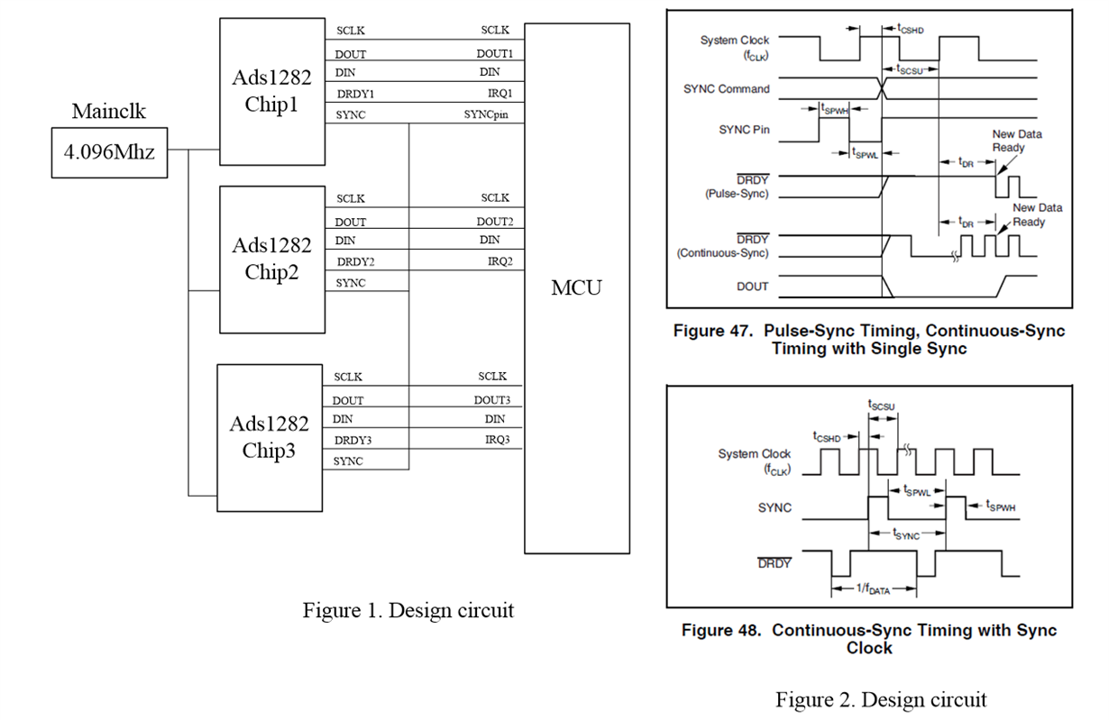

  • Hi Chris
    To disturb you again. I want to get three channel data with ads1282 in sync mode. I design my circuit board like figure 1. Is it correct?
    And I want to program it following the ads1282 datasheet and refer the figure 47 and figure 48, but I don’t realize it. do you have the sequence figure of DOUT1 DOUT2 DOUT3 ,DRDY1 DRDY2 DRDY3 with sync?or can you give me more detail instruction about this?
    PS:  The data output rate of ADS1282 is 500SPS and the frequency of the SYNC signal is 500 Hz
    Best regards!
    Kevin
  • Hi Kevin,
    I don't see any problems with your circuit diagram. You should be okay using 3x different SPI peripherals to communicate with 3x ADS1282s.
    ...One thing to note is that you probably wont need to monitor all 3 DRDY/IRQ signals if the devices are in sync.
    ...The only other suggestion I have would be to source the ADC clocks from the MCU if you intend to use continuous-sync mode of the SYNC GPIO (hardware) signal instead of the SYNC SPI (software) command.
    Do you intend to use pulse-sync mode or continuous-sync mode?
    Since you show an independent clock (independent from the MCU), I might recommend only using the pulse-sync mode and sending the SYNC SPI command (instead of the SYNC GPIO signal). The reason for this is that your SYNC GPIO and CLK signals are not derived from one another and it is very easy for these clocks to get out of sync. When this happens in continuous-sync mode the ADC(s) may re-synchronize unnecessarily. See this related E2E thread:
    If you use pulse-sync mode and send the SYNC (software) command, you can issue this command at any time to synchronize the ADCs. If you use the SYNC GPIO signal, then please pay attention to the "tCSHD" timing requirement, which requires that the rising edge of the SYNC signal not occur within 10 ns of the rising edge of the CLK signal.
    Chris
