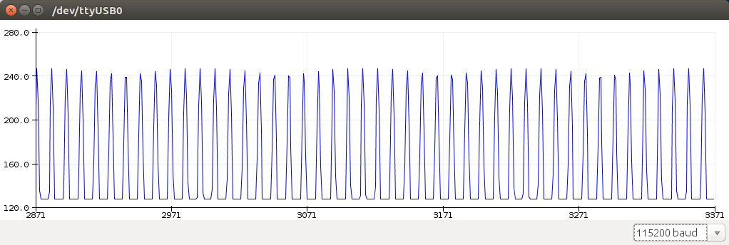

When I put my 2 electrodes on my right and left wrists I get this image

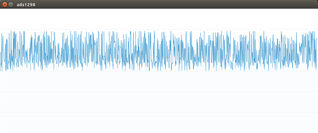

When I put off these 2 electrodes I can see this one

But I see not I expected, there is no clear peaks and PQ segments
  • Hello Ivan,
    If the inputs are DC coupled and there is no RL electrode, then the signals do not have a valid common-mode voltage and therefore the ADC will not be able to measure them. Do the results improve if you use a RL electrode connected to the RLD amplifier?
    Brian

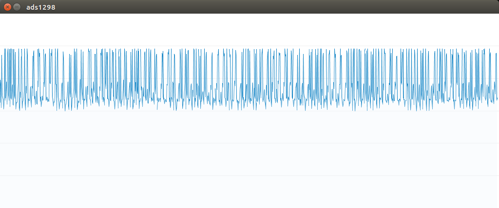

  • Hi Brian, thanks for your reply. I tried to connect RLD electrode and got this chart
    Seems it doesn't look like ECG

    I haven't tried, but I found that my chart is changing when I put on or off the electrodes. It looks better then on my screenshots above. Using RLD my signal is almost has a line picture. Also after filtering it by Butterworth filter I have a stable straight signal.

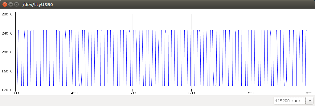

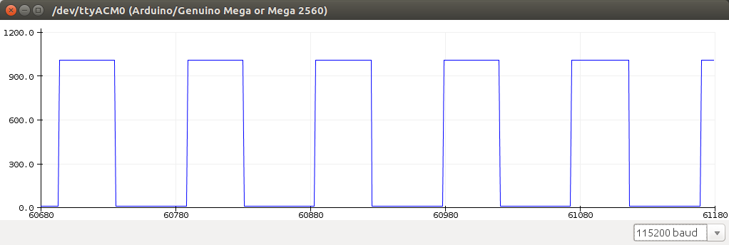

    And my square signal - the same 10Hz
    original
    and from ads1298
    as we can see, signals almost are the same, but it's strange for me, because the pictures above were made when I read 1 byte from ads1298 (I missed first 3 bytes of header, the next 3 bytes are for channel 1) if I read all three bytes of channel one I have a noise.

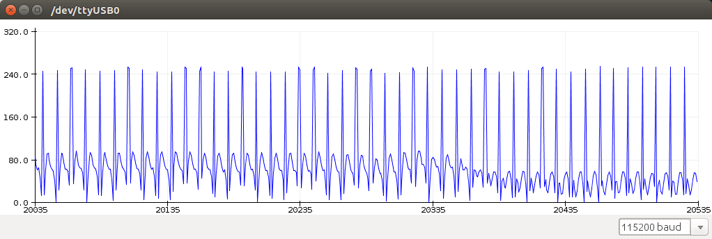

    but when put 1P and 1N electrodes on my chest or wrists and scan the signal
  • Hey Ivan,
    It looks as if the plots you are generating before you measure with the ADS1298 are at a much higher sample rate than the ADS1298 and thus appear to be "stretched out". Also, when you input a sine wave to the ADS1298, what is the common mode of the inputs? It looks like the signal is going out of range.
    The ECG signal actually looks good though!
