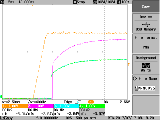

  • I checked the startup of the supply; it looks fine to me.
    The green line is the power good from the LM5165; it is pulled up to the 3.3V rail, because it is also connected to the CPU, but it is obviously released from the internal open collector when the 3.3V line ramps up.
    The 5.5V line (yellow) out from the LM5165 seems perfectly stable while the green 3.3 V and violet 5V supply ramp up.

  • Here is the startup of the power supplies:
    The Powerdown line is low for about a second after startup before initialization starts.
  • Now instead of resetting the chip (short low pulse on RESET/POWERDOWN) I force a powerdown with a long low pulse.
    If this fails I retry with longer low pulses (40, 40, 40, 200, 400 mS).
    In a test with 3000 cycles each on 12 units the problem has not occurred again.
    We will proceed with more testing; I will let you know if this really solved the problem.

    Looking at your last oscilloscope screenshot, the power rails do appear to come up cleanly. However, have you tried probing the power rails when setting the ADS1262's /PWDN pin high, to see if there are any glitches around the time that the ADC is enabled? I might also suggest probing the input pins at about the same time (and around the time you bypass the PGA) to see if you can see any glitching there as well.
    Another suggestion I might make to your existing circuit would be to control the 5-V LDO's enable pin and enable it with the microcontroller AFTER the 3.3-V supply has settled. My rationale for doing this would be to allow the ADS1262's digital circuitry to settle before enabling the analog functions which are controlled by the digital logic. This might prevent odd behavior due to the GPIOs, IDACs, and other analog functional blocks not powering up into a well-defined state if DVDD is still ramping.
    ...Better yet try monitoring the ADS1262's internal 2-V digital supply on the BYPASS pin to get an idea of how long it takes for the internal digital supply to settle (I believe this should be less than 50 us after the 3.3V supply is settled), and make sure you enable AVDD only after the internal 2-V supply is settled.
    I can't think of a much smoother power up sequence then to delay the 5-V LDO enable signal, and then bring the ADS1262's /PWDN pin high some time after that.
    Also, make sure that after setting the /PDWN pin high that you wait about 10-50 us for the crystal oscillator to settle before trying to communicate with the device. A best practice would be to wait for a /DRDY signal before sending any SPI commands, as you can know for sure that the crystal is oscillating and the device is ready for SPI communication by that point.
