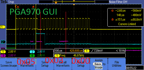

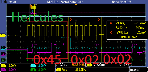

I'm trying to read the Micro_Interface_Control register of the PGA970 using the Hercules microcontroller. I copied the waveform for the USB2ANY board, and both the waveforms from my o-scope are below. The USB2ANY board appears to correctly display the value of the register (should be set by the Hercules to 0x03), but the Hercules gets a different response. Not just different bits at the beginning and end, but a different value for the data as well.
Can anybody explain why there are the differences? Especially if someone could explain why the Hercules microcontroller gets sent a bit before it's finished the address part of the SPI message?
Differences in SPI:
  • Hercules is communicating at ~10x the frequency of the USB2ANY
  • Hercules auto-code generator cant add delay between pulse. Or at least I cant figure out how to make it generate one.
  • There is a second read command generated by the USB2ANY following the first which is identical. However, the response to both of them is not always the same, the second always having a correct response and the first sometimes having a correct response.
CH1 (yellow) is the SPI clock
CH2 (cyan) is the command, or MOSI
CH3 (magenta) is the response, or SIMO
CH4 (green) is chip select
