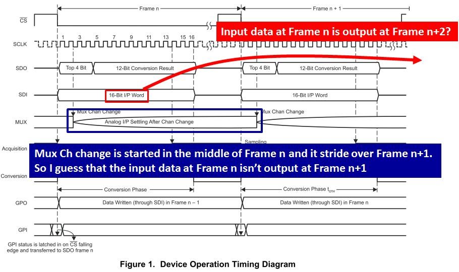

Here is the expectation of Write/Read sequence after Power-up. Is it correct?
-> Power-up (adhere to "Power Supply Recommendations")
                     (Interval : >10mS)
                            -> 1st Frame         Write [Mode: Manual, MUX: Ch1]
                                                        Read [invalid]
                             -> 2nd Frame        Write [Mode: Manual, MUX: Ch2]
                                                        Read [12bit conversion result of Ch1]
                             -> 3rd Frame         Write [Mode: Manual, MUX: Ch3]
                                                        Read [12bit conversion result of Ch2]
On the customer's system, we found the sequence seems necessary to put 1st Frame as "Dummy" for reading out a valid data as below. Could you let me know your considerations?

    Sorry for my delayed response. Please let me ask again if my understanding is correct.
    From Fig.1 in datasheet, the input data at Frame n may be output at Frame n+2, because Mux Ch change is started in the middle of Frame n and it stride over Frame n+1. Can you please give your opinion about this?
    Satoshi / Japan Disty
  • For your additional information, my customer is evaluating ADS7952 actually and confirm following result.
    • When the Mux ch is not changed, the input data at Frame n is taken at Frame n+1
    • When the Mux ch is changed, the input data at Frame n is taken at Frame n+2
  • Hello Satoshi-san,
    When you write to change the mux at n the data should come out at n+1.  Please see figure 50.  This shows that for example in frame n the device will be sending out the conversion data for frame n-1.  Also in frame n you re programming for frame n+1.
    Mike
    The datasheet is unclear on this. It does look like the data comes out on n+2. Please see this post:
    e2e.ti.com/.../1077037
    Mike
