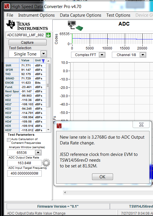

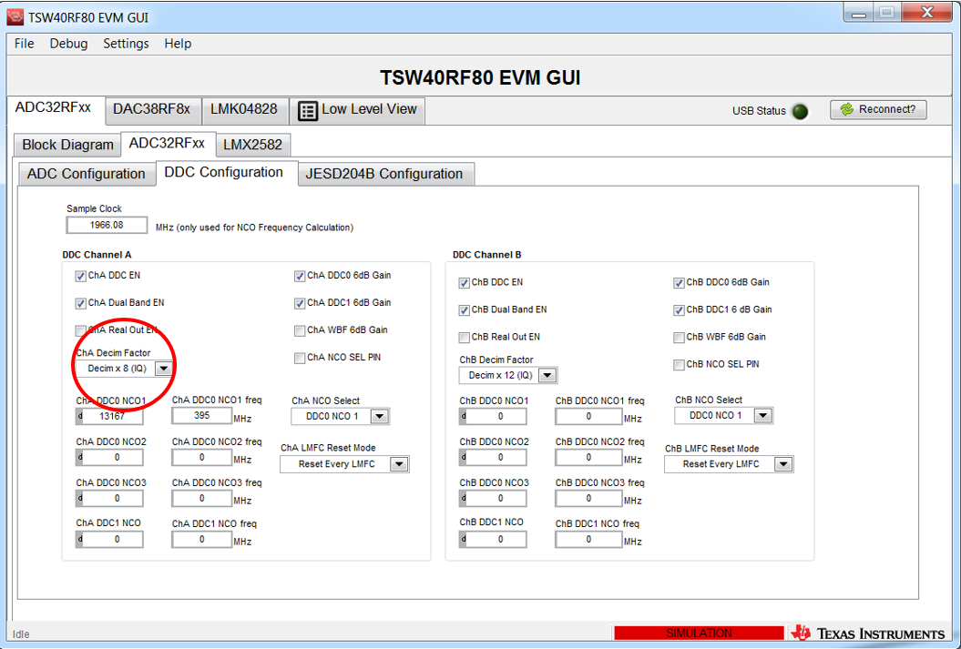

I'm interested in changing the sampling frequency of the ADC (ADC32RF45) for my evaluation module setup (TSW40RF80EVM with TSW14J56EVM).
The examples in the User's Guide for the ADC32RF45 all have sampling frequency of 2.94912 GHz, so I was wondering if there's a guide or simple tutorial on how to change the sampling frequency?
I'm currently using the TSW40RF80EVM GUI to write the ADC registers and HSDC Pro to capture the data.

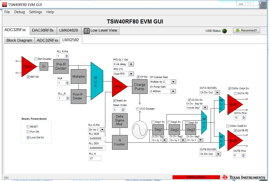

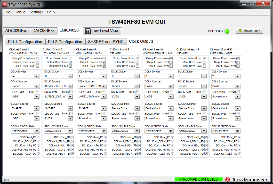

I'm using the default 122.88 MHz crystal on board as the source, and my understanding is that the LMX2582 generates the clock for the ADC.
Whenever I try to reduce the LMX2582 output frequency (by using the divide function or reduce the PLL divide-by-N), the TSW14J56EVM LED D4 stops flashing and I can no longer capture the data. Are there more settings I'm supposed to change for the ADC, or is it the TSW14J56EVM that needs to be set up differently?
